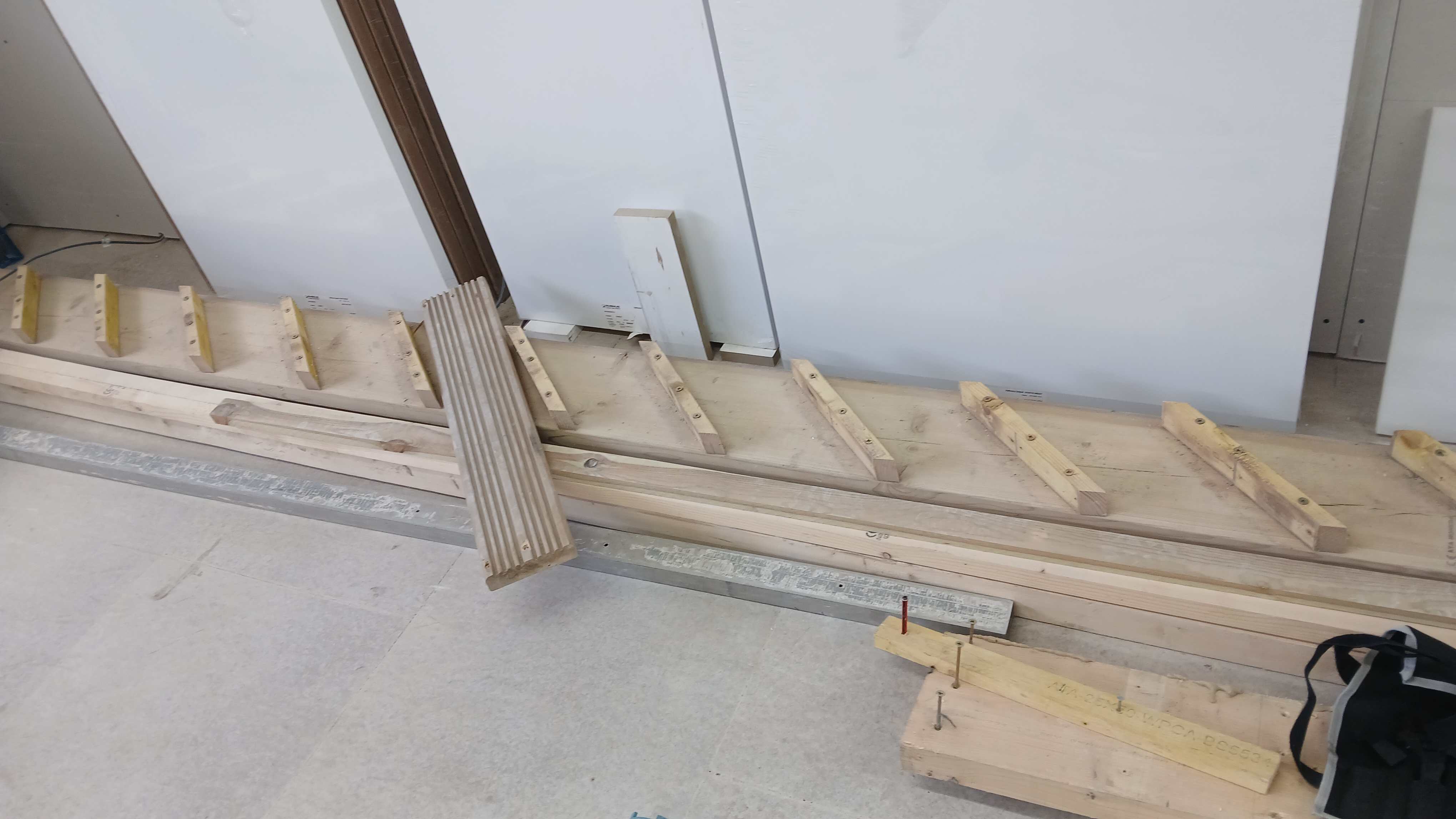

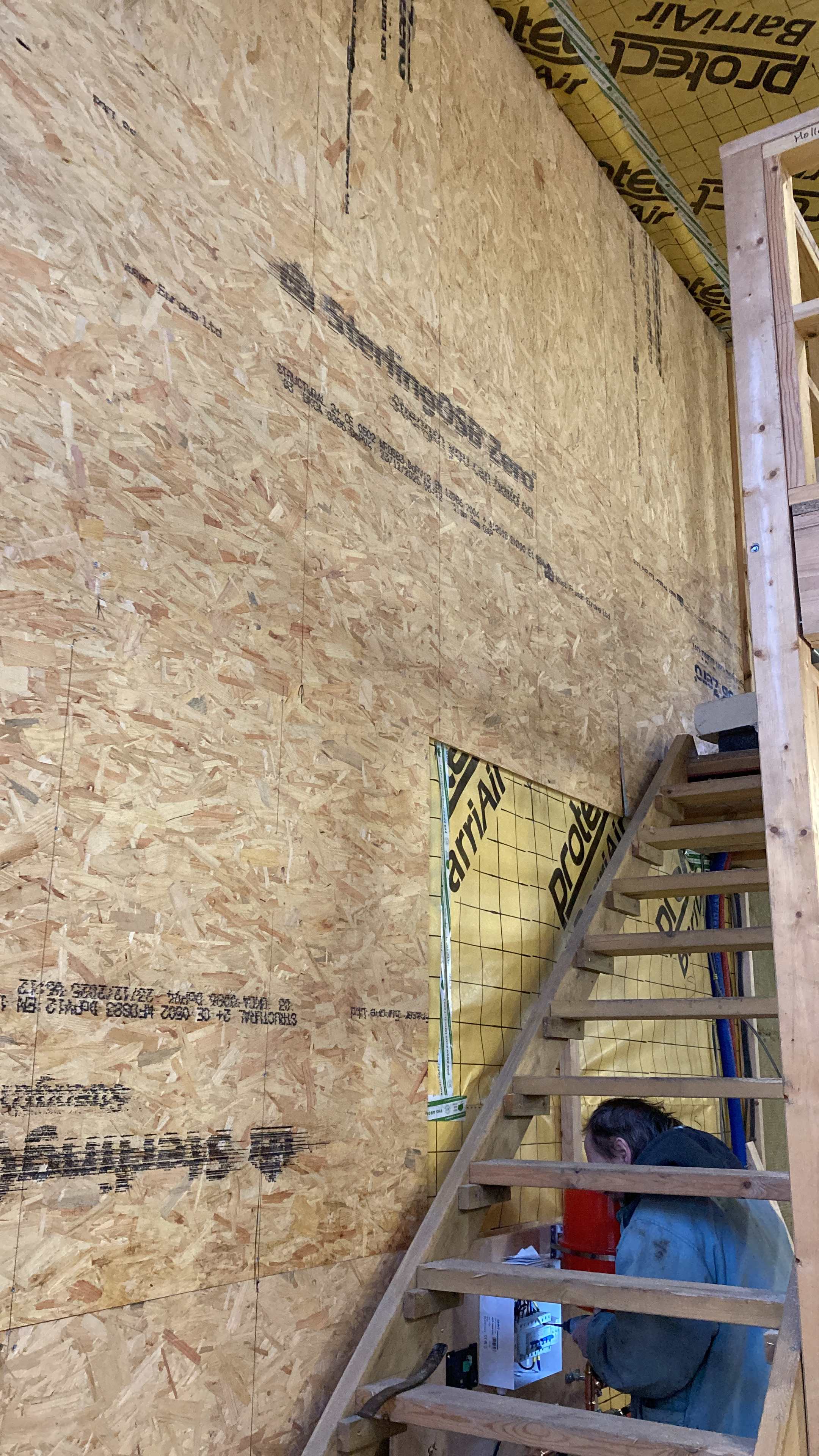

LaChab Posted 2 hours ago Posted 2 hours ago If it's just a straight stair, then dead easy to make (as long as you've got a cordless drill! and a saw!) Couple of bits of 225 x 50 for the sides, short lengths of 50 x 25 batten to hold it all together, and decking for the treads. Mine supported 4 guys and a 150kg triple glazed window with no problem. Have a go!
