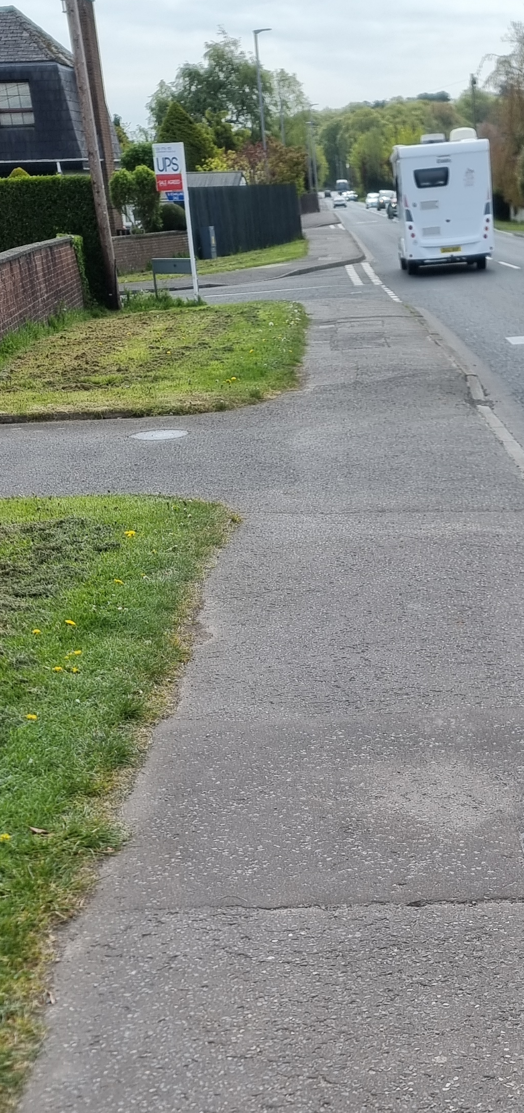

Mr Blobby Posted 5 hours ago Posted 5 hours ago (edited) We are in the same position, with the fibre available from a pole across the road for free. To a site that we demolished and rebuilt. But I didn't want the fibre coming from a pole the other side of the road. There is a pole on our side of the road (connected to the pole on the opposite side of the road) about 50 yards away that feeds our neighbours houses. I registered on the open reach site and paid the (approx) 300 quid fee as a new site. Engineer came out and offered to lay a trench from the pole on our side of the road along the grass in the visibility splay and across the neighbours drive and up to our boundary for (approx) 400 quid. For me this was a really good and not outrageously expensive solution to get the cable in through a conduit instead of overhead. Open-reach will often fit a pole on your side of the road for free but I preferred the trench dug across the neighbours drive option. We don't speak to that neighbour who is insanely precious about his house and boundary. Open reach haven't dug the trench across his drive yet so this is an added bonus to look forward to. Edited 4 hours ago by Mr Blobby
