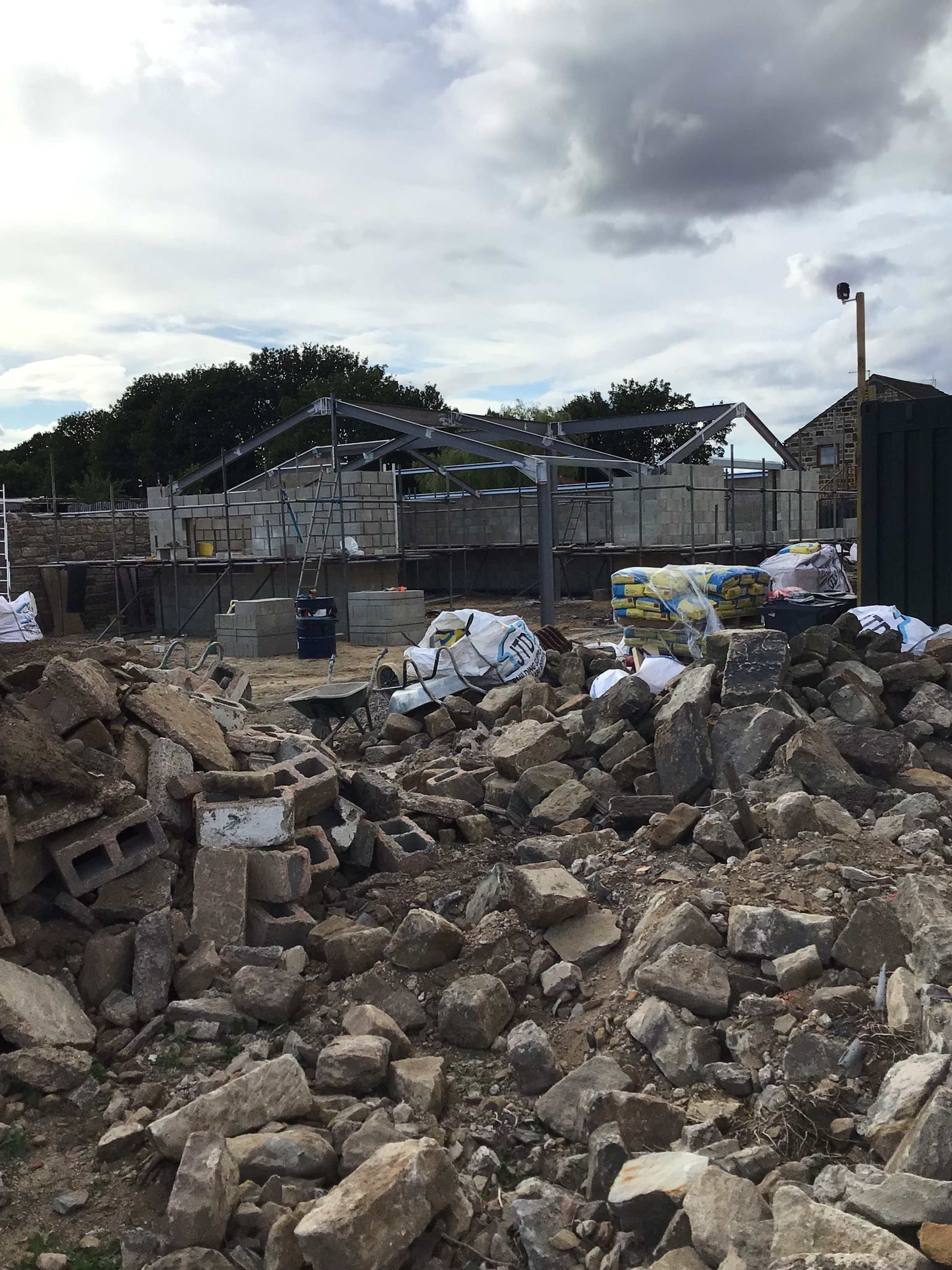

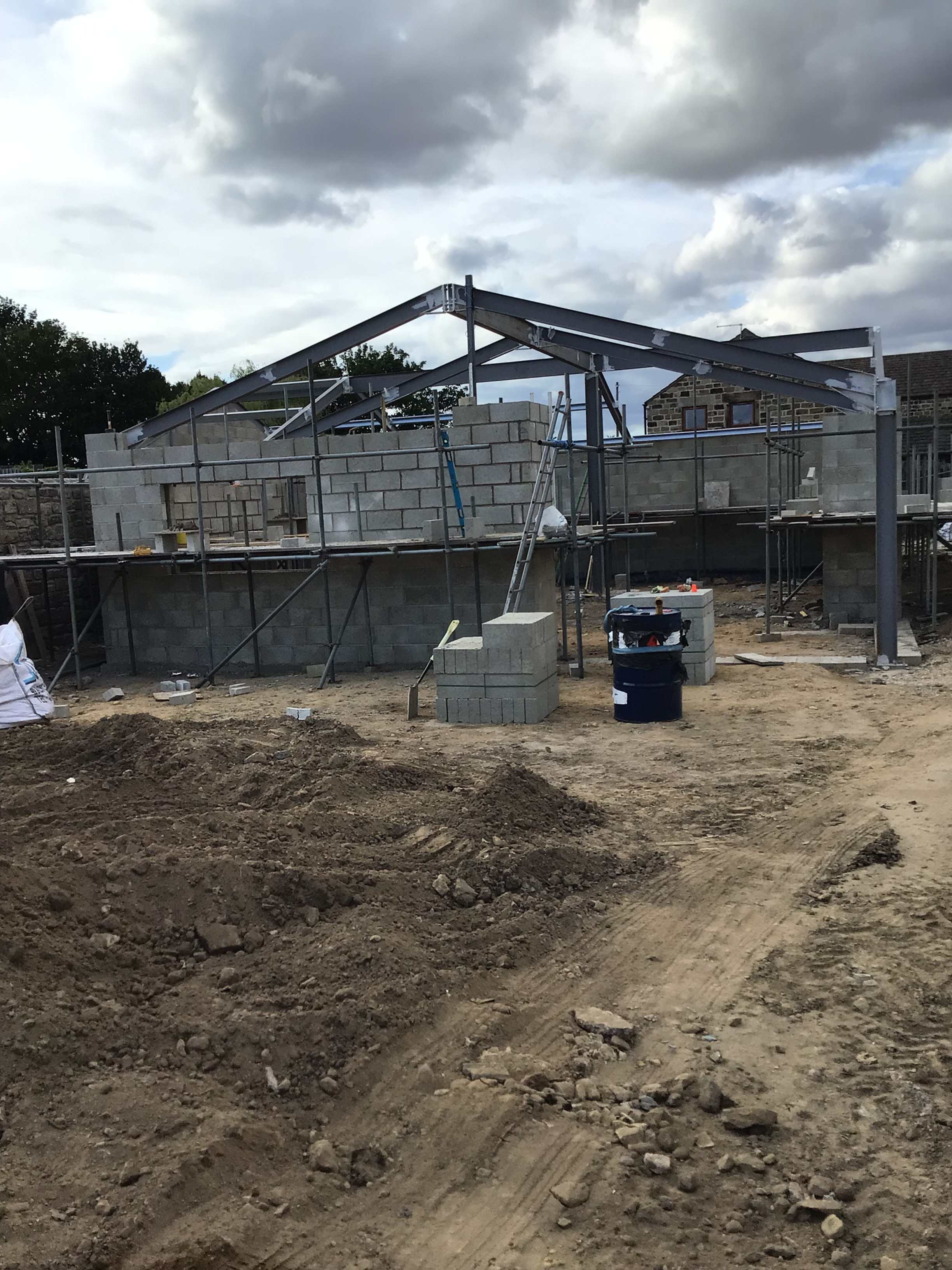

Kevan Marshall Posted June 2 Posted June 2 I am in the process of fabricating my portal steel frame garage, architect has mentioned that due to being more than 30 mtrs square and being about 600mm from the neighbouring boundary it needs to have minimal fire rating of half an hour, I was planing to clad with 40mm PIR insulated sheeting but this just falls under the 30 minute rating, purlins are steel and UB’s are twice as heavy as they need to be but that’s engineers for you, does anyone know of anyone that can supply insulated cladding with rockwool instead of PIR or maybe have another solution such as a cement board between cladding and purlins, any help would be greatly appreciated! TIA.

markc Posted June 3 Posted June 3 That’s a fantastic offer from @Gus Potter. I love steelwork, so designed and fabricated and erected my part-portal garage/man-cave. Roof is 100mm kingspan but why o why did I go for valley’s 🙈. They look great but we’re a pain to make work especially keeping headroom to max by putting purlins between the rafters. 1
saveasteading Posted June 3 Posted June 3 11 hours ago, Kevan Marshall said: that’s engineers for you, You lost my assistance there. Shame as I've designed and built hundreds. You are lucky @Gus Potterhasn't said the same. OK. Its BH, so: Likely it is a fixed rather than pinned base condition because of the boundarycondition.so heavier steel. You say trusses. Portal frames don't have trusses. Plus an agricultural spec is completely unsuitable, so of course this is much more expensive. It's great you are studying the subject but there is a risk this turns into dabbling. Out.
Kevan Marshall Posted June 3 Author Posted June 3 Biggest problem is looking for cladding for the side nearest the boundary, the steel portal frame is fabricated and that’s not going to change, I served my time in a blacksmith’s that put hundreds of sheds up over the years and not one has fell down, last shed I fabricated was 80’ wide and 160’ long 25 years ago, I moved on to work offshore and am hopefully getting near retirement, engineers do calculations and that is ok but to put wind bracing pipes in the roof structure that are 48.4 x 4mm tube and cross bracing that is 50 x 5 flat bar does not cut it with me, also I was going to use wooden purlins but he wanted 9” x 4” timber for 4.5mtr bays also seems a bit strange, he then said we could use a 120mm Albion z-purlin at 1.2 mtr centres which seems a little light to replace a 9”x4” timber, z-purlins are not easy to come by in Northern Ireland so using a multi beam 140mm purlin as agreed with SE….

saveasteading Posted June 6 Posted June 6 5 minutes ago, Kevan Marshall said: we’ll try and get away with 40mm insulated cladding, As @Gus Potter says there are strict rules on this. Your wall has to stand up against a severe fire inside your building and the structure remain standing, all to stop fire spread to the neighbour. I expect the Bco will simply refuse you, and await a compliant proposal. This will be for a much more complex wall, clad inside as well as out, and with certified details. Also the steel usually needs fire protection. Your SE foundation design also needs to demonstrate that it won't overturn in a fire. Then post the proposals here and we can check they are practical and economical. I suggest you simply commission your Architect and/or SE to specify it now, to save you several weeks. Perhaps it was already their responsibility ( we don't know your contract terms).

Kevan Marshall Posted June 8 Author Posted June 8 4 hours ago, torre said: As @Conor says, moving it just 400mm will be simpler and maybe a bit more neighbourly too? It's going to be a substantial not very attractive building that it sounds like you might cut corners on and you don't want close to your own house - they probably don't either! It’s in the corner of their garden and away from their house, it is close to my house as my plot is of restrictive size, the front gable shall be clad with cement board and k-rend applied to match my house 1
