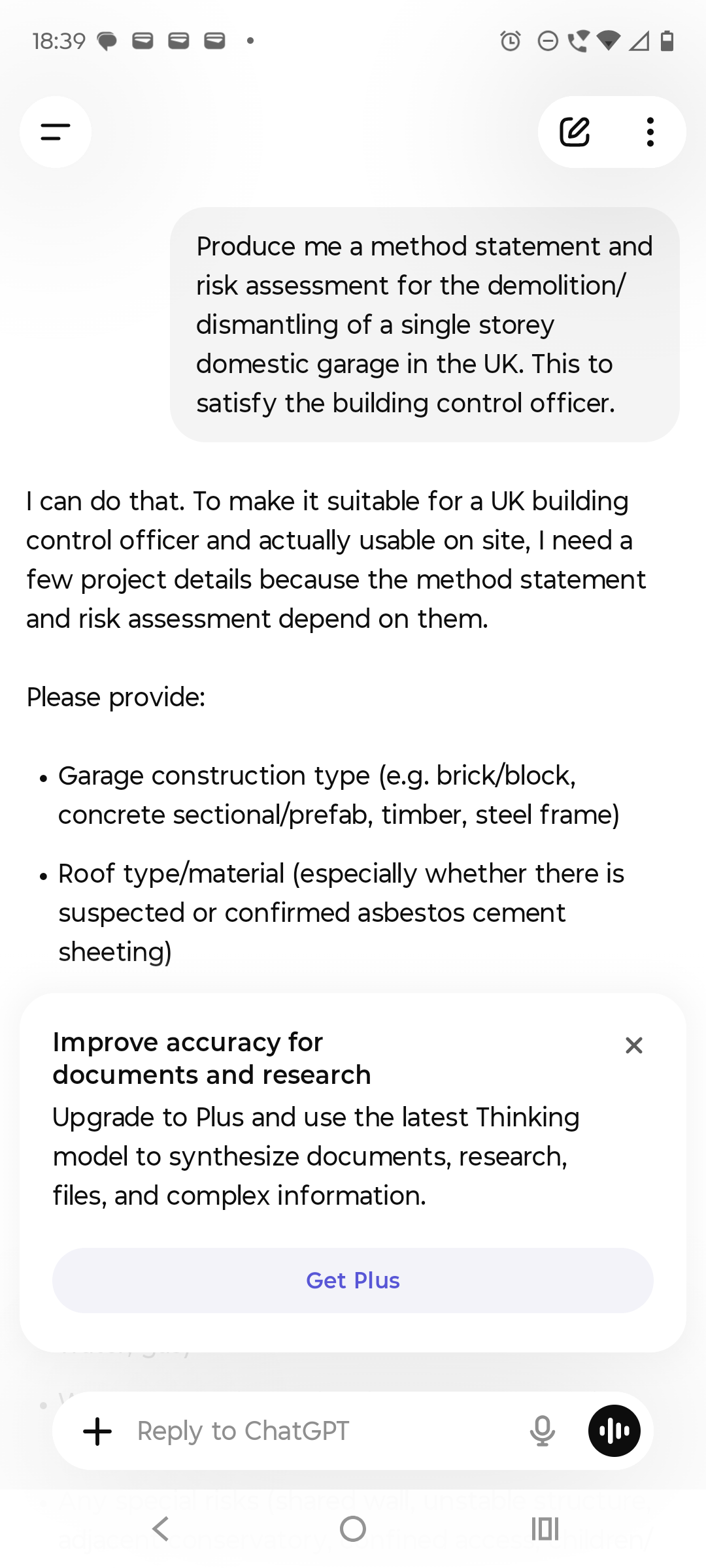

Onoff Posted May 26 Posted May 26 On 23/05/2026 at 09:03, saveasteading said: Also you should write up a method statement and risk assessment. If you can't write it down, you haven't thought it through enough. Just download ChatGPT and take all the effort out of it. 3

saveasteading Posted May 27 Posted May 27 22 hours ago, Onoff said: download ChatGPT and take all the effort out of it. I disagree. Unless you mean as a template. Lots can go wrong so thinking each stage through is important. Access, tools , workwear. Mostly, what might go wrong once x piece is taken out or over a weekend. 1
Nickfromwales Posted May 27 Posted May 27 38 minutes ago, saveasteading said: I disagree. Unless you mean as a template. Lots can go wrong so thinking each stage through is important. Access, tools , workwear. Mostly, what might go wrong once x piece is taken out or over a weekend. Uncomplicated, small buildings should be dropped in one continuous sitting. Start on a Monday not a Thursday, and avoid the weekend so nothing is left unsafe. Have a plan and 1 person in charge, not a family day of chipping bricks, to reduce the risk of anyone unaccounted being somewhere they shouldn’t be, when things fall unexpectedly. Obvs absolutely ZERO children or pets on site, and fence off access whilst the works go on. 2
Onoff Posted May 27 Posted May 27 2 hours ago, saveasteading said: I disagree. Unless you mean as a template. Lots can go wrong so thinking each stage through is important. Access, tools , workwear. Mostly, what might go wrong once x piece is taken out or over a weekend. Obviously give it a cursory once over but I bet it would sail through. It's pretty much a box ticking exercise anyway. 2
