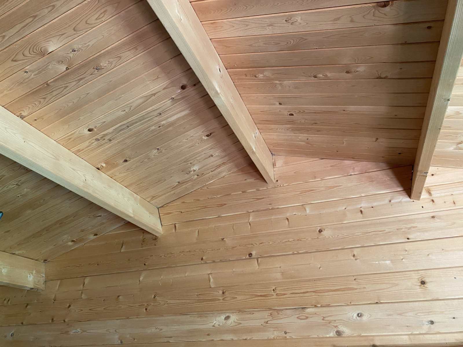

If I’ve missed anything blindingly obvious let me know but my main concern is fixing the counter batten/PIR to the 18mm sarking. What would be the best fixing for this and would it be enough? The way this log building is constructed, The roof is supported by 2x8 purlins rather than rafters.
It would give a much better fixing if you could fix the counter battens through to the purlins.  Unless you go through the t & g boards I don't think it will be strong enough.

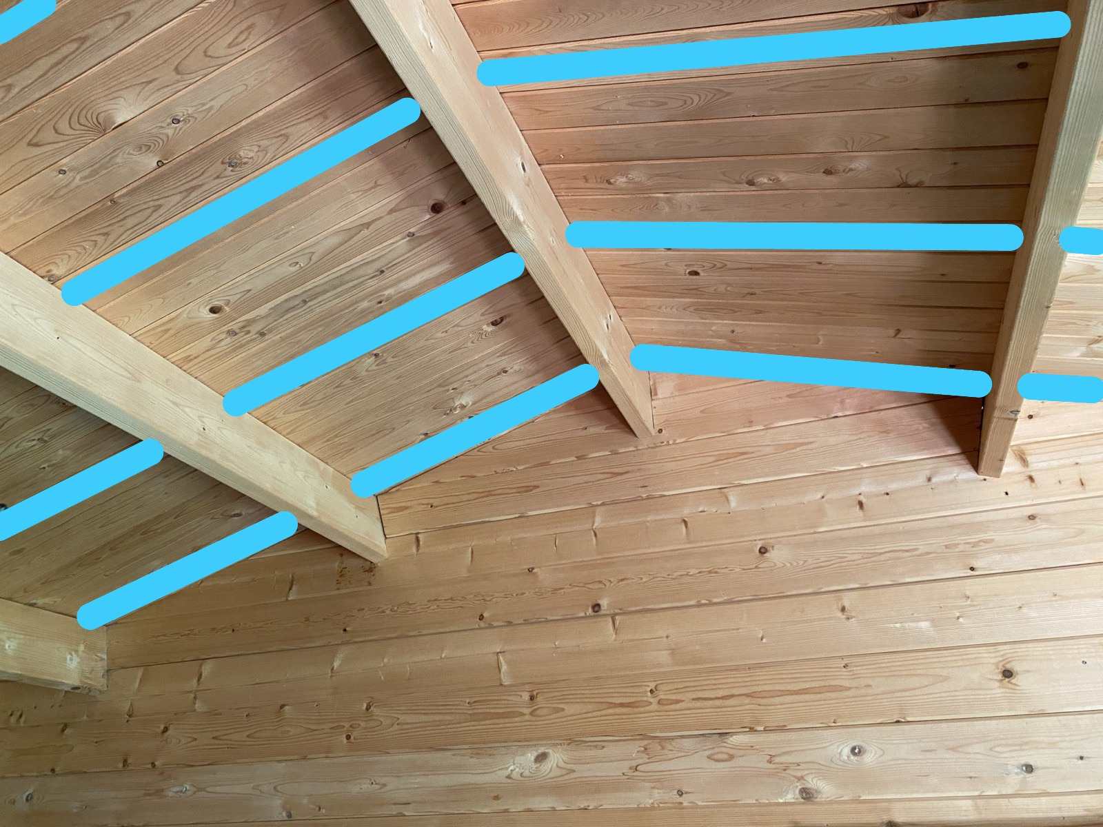

I could certainly get a some fixings into the purlins but the majority would be in the 18mm t&g only and that's my worry
Another option, I could add some ply board from the underside of sarking (between purlins) just to give the fixings more purchase
Or rather than ply sheet, Add some 4x2 at say 500/600mm centers with the timbers laid so their widest face 4" was up against the sarking giving me 18mm t&g + 45mm timber to go at.

The 4x2 solution in a prev post seems like best option so far with some sort of twistfix fixing but open to further ideas
