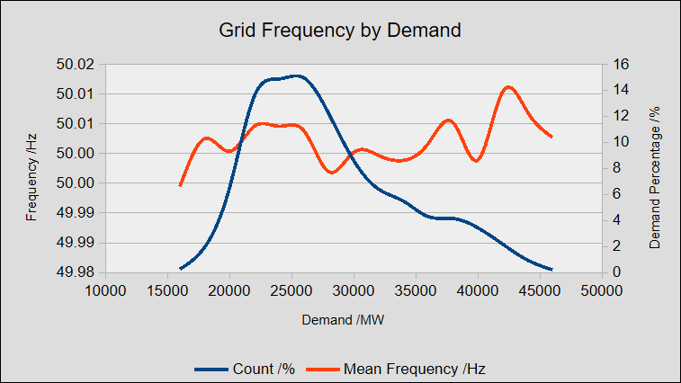

On 28/04/2026 at 15:22, -rick- said:
Changing grid frequency is how the overall grid responds to load as frequency directly affects power generated due to the spinning generators that make up most of the grid.
While that is correct in a simple system i.e. one large generator and multiple variable loads, in a dynamic system, where there is intervention, the formula is not simple.
If I remember my electrical engineering correctly, rotational speed is proportional to voltage and as voltage lags current (current is infinite at zero voltage), a certain amount of variability makes a tiny difference.  It is only when generation equipment goes out of bounds that it become a problem i.e. a generator becomes a motor (though I am sure they have systems to stop this) or a generator slows too much and overheats.
We like to think that the grid has a very stable 50 Hz, sine wave, but in reality it is very messy with a mixture of frequencies and even some DC in it.
A quick look at Gridwatch shows that for the vast majority of the time (99.98%) the frequency is pretty stable between 99.99 Hz and 50.07 Hz).
Interestingly (to me anyway) is the extremes of low and high generation.  When demand is low, the frequency drops down for the mean, and when demand is high, it increases.
This is where intervention is happening most.
If we take the samples between 20000 MW and 40 MW (94.42% of demand), the mean frequency is 50 Hz, bang on the money (well to 2 decimal places).
The National Grid really is an engineering marvel and it costs us less than a quid a day.
Grid frequency is rarely 0.2% above or below (+/- 0.5% is the statuary limit) so makes very little difference.
Yes, which is part of my arguement about using it to detect load, and then use it for local management.
I prefer to let they big boys, who knows what they are doing, manage that side of it.
