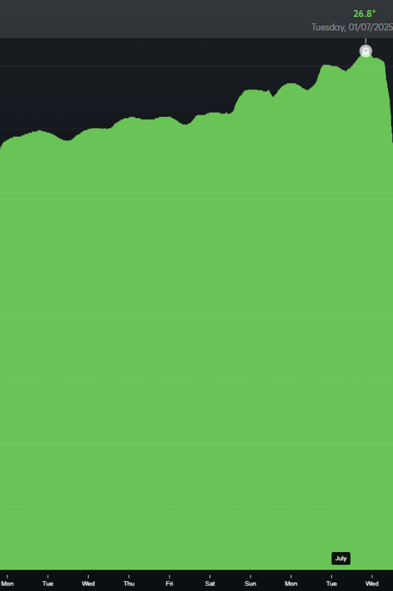

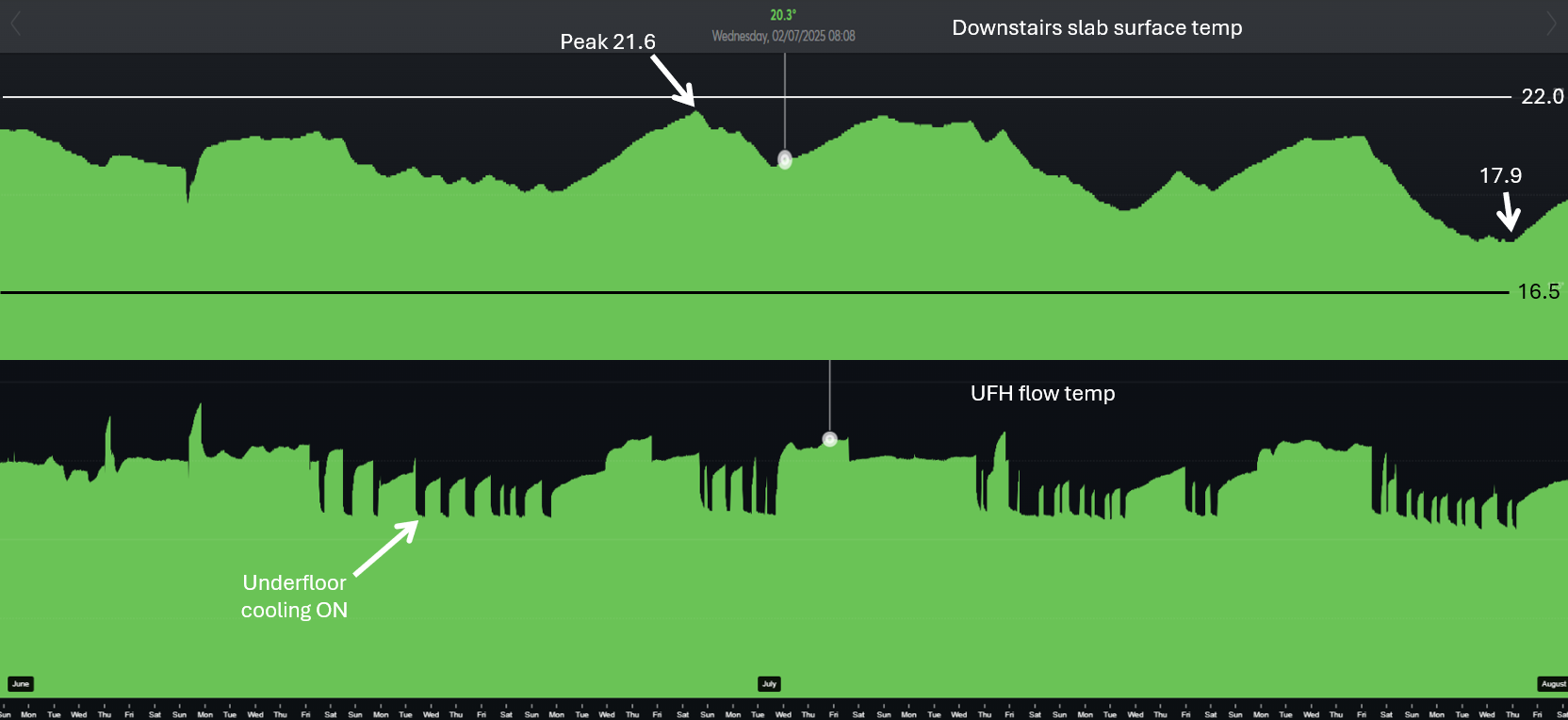

April 21Apr 21 2 hours ago, jack said: I can only talk about my personal experience, but we cool our downstairs slab with an ASHP during hot periods and it's remarkably effective. Coming in from outside on a hot day is like walking into a cool cave. We run a flow temp of about 16 °C and that's enough to keep the slab under about 20 °C, even in a multi-day heat wave. We do have concrete floors, which I'm sure helps a lot. I don't imagine the effect would be as powerful with, e.g., wooden floors. Yes, the concrete floors will help a lot, but I'd be curious to know how the floor temps are when the ASHP is not running? Have you taken any comparative measurements? What we ideally need are specific figures to understand the W/m2 can be gained from a floor during cooling
April 21Apr 21 1 hour ago, SimonD said: Yes, the concrete floors will help a lot, but I'd be curious to know how the floor temps are when the ASHP is not running? Have you taken any comparative measurements? What we ideally need are specific figures to understand the W/m2 can be gained from a floor during cooling I only started running Grafana earlier this year, so the only data I currently have are Loxone native (and hence probably not much help). For context, I presently run the cooling open loop. I can enable cheap rate cooling and/or daytime cooling (scheduled between 10:00 and 16:00, from memory). I can also push a button and get 2, 4, 6, or 8 hours of cooling. Periods where the cooling doesn't come on for a period are usually cooler and/or cloudy (and hence less solar gain) periods. This shows the downstairs slab temp (note: not air temp) and the UFH flow temp for June and July last year: Note the runup to the peak slab temperature in late June. With the cooling off, the temperature rose consistently from 19.4 on Monday 23 June to 21.6 on Saturday 28 June, when I enabled cooling This is what the weather was doing during June 2025: The house has a long time constant when it comes to reacting to external temperatures. Even though the temperature in June was highest on about 21 June and fell off sharply after that, the internal house temperature continued rising for a couple of days before I turned the cooling back on. Unsurprisingly, the cooling downstairs has virtually no impact on upstairs temperatures. Here's 10 days starting on 23 June, showing the relentless increase in upstairs temperature even after the cooling is turned on downstairs on the Saturday: That was actually the hottest it got upstairs in all of 2025. Not sure if any of that helps. I originally planned to add things like flow sensors along with power monitoring for the ASHP so I could get a better sense of what was going on an perhaps tweak things for better performance and lower costs, but in the end I decided it was too expensive and complex. That said, earlier this year I expanded the inputs available for Loxone, such as excess solar power and temperature forecasts. I'm hoping to do something with those to better automate cooling this year.
April 21Apr 21 Author 1 hour ago, SimonD said: What we ideally need are specific figures to understand the W/m2 can be gained from a floor during cooling Wait x months* and I'll have some data... *Where months may be years....
April 21Apr 21 4 hours ago, jack said: which I'm sure helps a lot. I don't imagine the effect would be as powerful with, e.g., wooden floors. We are mostly oak on top of concrete, and the effect of cooling is pretty good. 4 hours ago, jack said: Coming in from outside on a hot day is like walking into a cool cave Good analogy We had two similar days one pre cooling and the next with cooling. Cooling knocked around 3 degs off absolute max temperature, but more importantly, once solar gain stopped, house recovered to more normal temperature way quicker. I look at cooling as a freeby of having a heat pump installed. We get what we want, at zero install cost, is it Aircon - no, do you need Aircon maybe not. Having lived with Aircon for a few years (overseas), not sure I want the endless air blast either. UFH heat and cool, is an easy to live with option. In absolute terms the cooling isn't designed, we accept what it provides in comfort a bonus. Our cooling will be stitched on next week and stay on until around October.

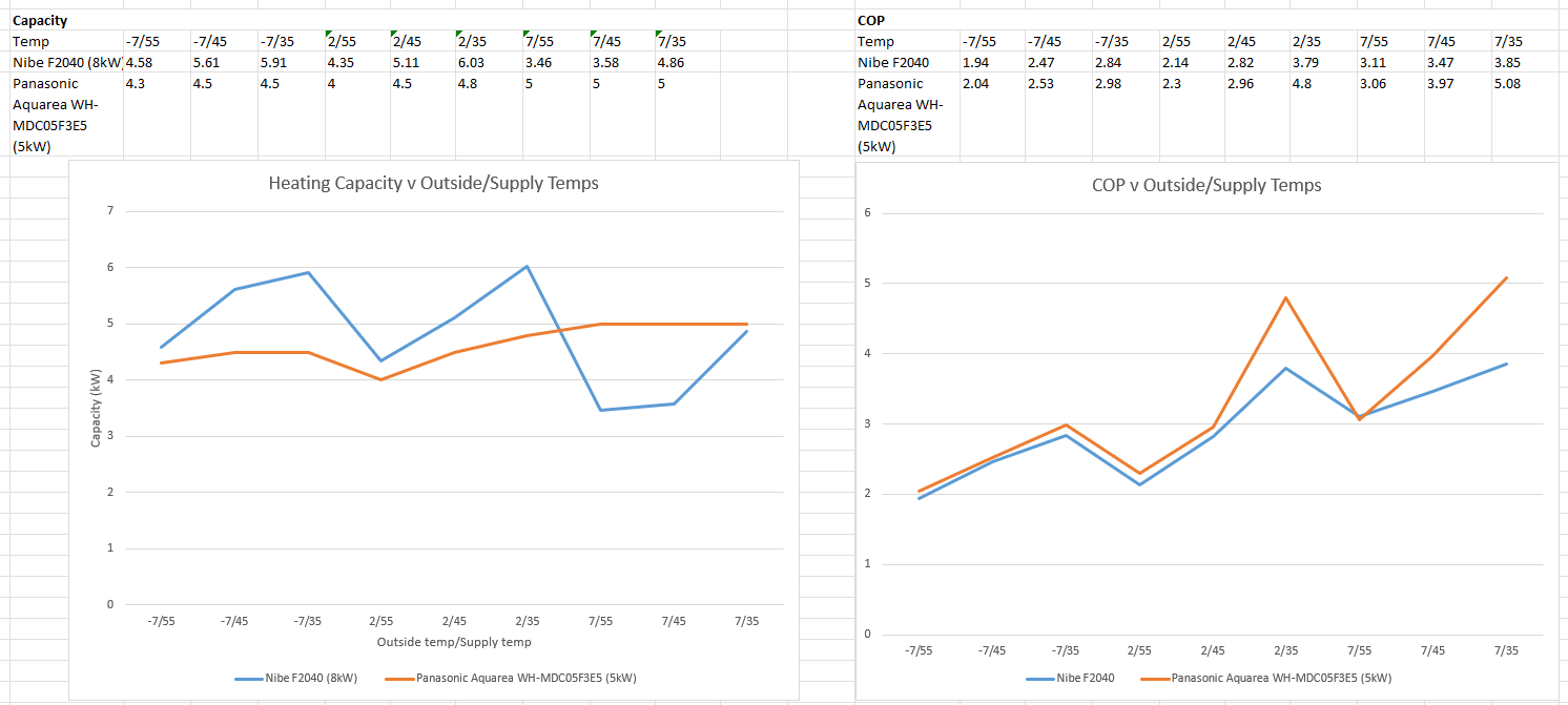

April 21Apr 21 44 minutes ago, mistake_not said: Obvious candidates are Viessman and Valiant but I know nother about HP manufacturers really. It really depends on your budget. Stiebel Eltron, and Nibe both do heating and cooling and are very nice units. Viessmann currently requires an indoor unit, but also very nice and some of the best controls in the business. My Viessmann rep told me there is a monobloc coming, probably in the Autumn. Panasonic also do some nice units with cooling and these can be paired with their fan coils. And as you've listed, Vaillant. I think Vaillant is probably the cheapest on this list, but there may be a Panasonic about the same price. Most people like and choose Vaillant because of the standards of support available. Daikin also do cooling but I don't know much about them as I'm not an installer for Daikin and haven't had their training.
April 22Apr 22 On 21/04/2026 at 20:45, mistake_not said: Anyone got recommendations for a 5kw pump that does heating and cooling? Obvious candidates are Viessman and Valiant but I know nother about HP manufacturers really. Panasonic are an option. It's been over 10 years since I installed mine, but their technical support department was happy to take my phone calls to troubleshoot our installation, which I doubt all companies would be happy to do. I remember we were getting an intermittent error that we couldn't find the source of. They suggested a slight change to something like flow rate and the problem disappeared. Even as a pleb, you used to be able to get a login to the Panasonic Pro website, which gave access to all their technical docs that aren't publicly available. Again, this info is long out of date, but I did a comparison between the Panasonic 5 kW model I eventually bought, and a Nibe 8 kW model. As you know, the power ratings are somewhat nominal, but I didn't expect the comparison to look like this: One thing I'm not sure about is conditions under which the ratings are determined. For example, periods of low single digit temperatures when it's damp (common in many parts of the UK during winter), defrost cycles can have a significant impact on COP. A couple of other things I'd consider are: What sort of functionality you get without requiring cloud access. Surface area of heat exchanger. If you can find a low power unit with a larger heat exchanger, my guess is that it's likely to require fewer defrosting cycles in cold weather. I'm sure someone (maybe @JohnMo) has mentioned that some ASHPs have some sort of two-stage system that can operate very efficiently at lower power on one stage, then bring the other in when high power is required (e.g., DHW heating). Can't remember whether it's dual compressors or something else. I imagine this sort of tech is more likely to be available in higher power units.
