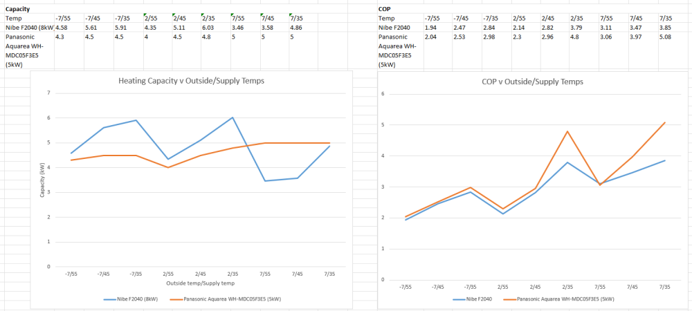

April 20Apr 20 Hi all, Contemplating to moving to a ASHP over the summer (mainly for cooling benefit from UFH and fan coils). Doing my heat calcs I have a big difference between my calculated heat loss and real world heat loss. Hoping someone will help me understand the difference. Calculated heat loss is around 5.1kw using the freedom heat pump spreadsheet (attached). I used the same target temps as we have in real life, and the output figures match those generated from loopcad when I was using that. Real world I got data from my smart meter. I used a night in Jan that was -2, so no solar gain etc. This real world figure gave me 3.2kw. So what do I believe? I don't want to have an oversized heat pump and want to run the system on weather comp. Other info is we find we can heat the house quite nicely just running the UFH, and leave the rads off upstairs. Means downstairs is at 19.5 and upstairs at 17. Thanks 👍 😊 Heat loss calcs 20 HCR.xlsx
April 20Apr 20 7 minutes ago, mistake_not said: Real world I got data from my smart meter. I used a night in Jan that was -2, so no solar gain etc. This real world figure gave me 3.2kw. Not sure a single night will give you an exact heat loss rate, as any day time gains will still be there. Suspect your real heat loss is somewhere between the two figures. Plus the heat loss spreadsheet uses min BR U values not your real ones. But basically your ASHP model choice will depend on actually output at you min outside temp. I would understand size not over size.
April 20Apr 20 32 minutes ago, mistake_not said: So what do I believe? I don't want to have an oversized heat pump and want to run the system on weather comp. Difficult to say as there are issues with both and I wouldn't trust either of them. If you can bear the pain of re-inputting your data, you can use OpenHeatLoss.com (which I have developed) to complete a calc and design to current design standards. This also provides the ability to look at your ufh design in relation to heat loads etc. The only thing it doesn't do right now is Fan coil sizing
April 20Apr 20 Author 2 hours ago, JohnMo said: Plus the heat loss spreadsheet uses min BR U values not your real ones. Whilst it does have that deleted, it also has custom ones and I have made sure they match the as built values. 2 hours ago, JohnMo said: Not sure a single night will give you an exact heat loss rate, as any day time gains will still be there. Suspect your real heat loss is somewhere between the two figures. Seemed like a pretty steady output over that night though, and it's wasn't sunny days. But agree it's likely somewhere in the middle. My gut feeling is the ability for the heat pump to modulate will be more important to me than max value. 2 hours ago, SimonD said: If you can bear the pain of re-inputting your data, you can use OpenHeatLoss.com (which I have developed) to complete a calc and design to current design standards. This also provides the ability to look at your ufh design in relation to heat loads etc. The only thing it doesn't do right now is Fan coil sizing I had a quick play when you first posted about it. All my u-values are as built, so I'm guessing I'll end up v similar but will give it a go. Does anyone know the deal with BUS / MCS? Do they have to hit heat loss calcs exactly?
April 20Apr 20 6 minutes ago, mistake_not said: Does anyone know the deal with BUS / MCS? Do they have to hit heat loss calcs exactly? The MCS design and installation requirements are that the Heat Pump can provide all the heating/how water requirements, which does mean the unit has to be sized according to the heat loss, but that doesn't necessarily mean that your heat pump will be over-sized. Good design also makes sure that the heat pump can modulate down far enough to deal with typical temperatures without short cycling.
April 20Apr 20 43 minutes ago, mistake_not said: Does anyone know the deal with BUS / MCS? Someone the other day had a radiator system that currently runs at 45 degs, he was getting quotes circa £13500 before grant for a heat pump and some install works - utter bonkers. But generally most R290 heat pump seems to modulate well. But not all will do cooling if you need that. Example, current Grant heat pumps physically will do cooling BUT their controller does not allow this happen. Most installers are clueless about cooling, so be prepared for plenty of BS.
April 20Apr 20 Author Yeah, the one quote I have had (based around 5kw pump, no rad changes, leaving water tank, but including boiler rip out) is something like 7k after grant 😞. Tempted to see if the sparky that did my solar can do something with me so I get BUS.... I want a very simple fully open loop weather comp system, I already have PDHW and my pipework is all big enough already.
