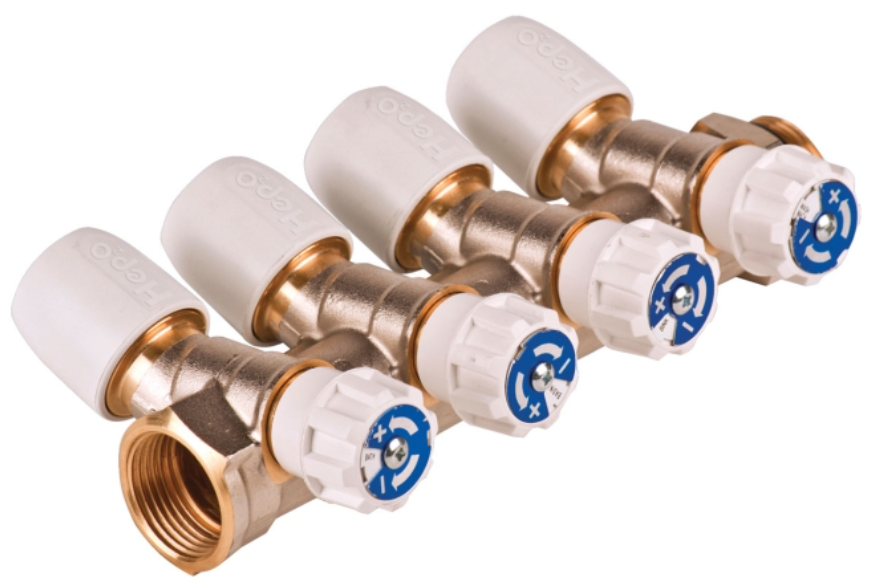

TerryE Posted 5 hours ago Posted 5 hours ago (edited) I installed my HEP2O system courtesy of @Nickfromwales guidance about 9 years ago. I have a one pipe-per-tap/appliance design, all fed from a central manifold setup (see image below). It works brilliantly: no hidden pipe joins to fail, any tap or appliance can be isolated at the central manifolds. I have one bugbear: the "easy to turn" taps are no longer easy to turn. So once every few years, I have to go through every isolation valve and crank it through the full travel using a rubber strap wrench - but with only perhaps a 30° stroke, this is a time consuming total pain. (Luckily, all potable water goes through a Harvey filter, so there is pretty much no pipe fur problem.) I started doing this because I needed to isolate one tap urgently after a failure and found I could no longer turn the value by hand, so ended up isolating the entire cold side, losing head at a tap then I could crank it in slow time, before turning the isolator open again. So my Q to all those out there who have the same HEP2O manifold setup: what do you do here? Do you bother doing an annual travel cycle? Do you have a key to turn these? If so what? I can't find a suitable turnkey online and Waverin doesn't seem to sell one. I did think about 3D printing a F/F key cap to ½" socket adaptor, so I can use a socket wrench on them. Suggestions gratefully received. Thanks. Edited 4 hours ago by TerryE

TerryE Posted 3 hours ago Author Posted 3 hours ago (edited) @JohnMo. I've taken off one of the taps to have a close look. It is ~26mm in outer dia with a 8×2mm step knurl on it for "easy grip" (giving a 22mm smaller dia) . It would be easy to turn a singleton by hand because I could get a finger lock on it, but this isn't the case in-situ where I have 8+ in a row with return pipework in the way and in the case of the hot manifold a lagged box surround, so at best I can get end-finger access, giving bugger-all torque and not enough to overcome stiction. As I said, a rubber strap wrench works but only has a 25-30° in-place travel. The taps themselves are injection-molded plastic, so clamping with a normal adjustable will just wreck the tap surface. The ×8 step knurl is a poor match to standard spanners and adjustable wrenches which are designed for 120° / ×6 or ×12 symmetry. One option for "annual" maintenance is to unscrew/remove each plastic tap and just use the steel ¼" square spigot, but I really need a tap female-female square so i can turn it with one of my ratchet wrenches. Edited 3 hours ago by TerryE

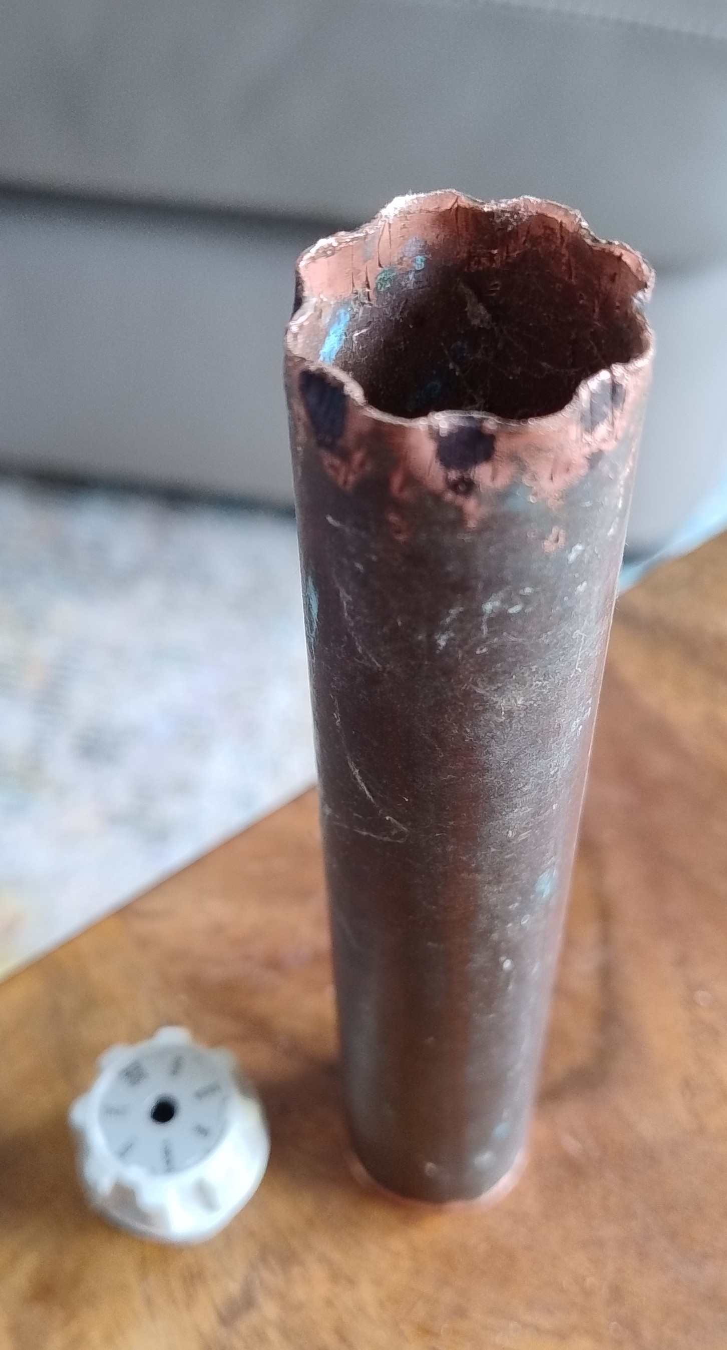

Nickfromwales Posted 57 minutes ago Posted 57 minutes ago @TerryE, I think it’s just ‘life’ and would be far less problematic if you had better access to get your kits on it more robustly. Beware using a ratchet as that apply way too much torque and wreck the manifold, but I’d certainly look at getting a long screwdriver and welding on a tip that fits the square shaft, or, as above, 3D print a key. You could probably buy some aluminium tube and just hand cut some castellations into the end of it to create a Hep-spanner. I doubt those teeth would need to be more than 5mm deep vs the full depth of the tap heads. Have you emailed Wavin to see if they do a spanner for this? 1
TerryE Posted 28 minutes ago Author Posted 28 minutes ago (edited) 29 minutes ago, Nickfromwales said: I think it’s just ‘life’ and would be far less problematic if you had better access to get your kits on it more robustly. This is a bit of a 20-20 hindsight thought. The layout is what it is: all neatly boxed in and decorated. For repeat or about-to offenders, I would add ease of access to the tap line as a checklist item. This really wasn't as issue for me during commissions as they were easy to turn then. 3D printing sound like an easy solution -- at least for my son-in-law who has a 3D a pinter -- until you add in the learning curve and hassle of doing the 3D cad etc. for the key (it isn't on Thingiverse). Gemini suggested putting a bolt in the end of a 28mm end-feed cap and using 2-part epoxy plus a greased tap to make a female. I also though about using 22 mm endfeed T and toothing the middle branch as you suggest to form a T bar overkey -- except that Jan had a clear-out, and gave away all my odds and sods plumbing bits on the rationale: "we'll never be doing any more plumbing ourselves, but if nec, then Screwfix is only a 10 min drive away". How do you deal with sticky 10-year old HEP2O manifold jobs? Edited 23 minutes ago by TerryE
