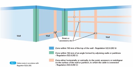

Electric cables in a wall must run in a safe zone.
Broadly speaking a safe zone is horizontally or vertically from an electrical accessory, e.g. a socket, or within 100mm of the corner of a room or ceiling.
If you want to run electric cables around a room then do so at socket height, and ensure each wall has at least one socket to create that safe zone, and that is where all your mains cables can correctly run around a room.
@ProDave So, I just need to put a dummy 'point, accessory or switchgear' to establish a zone / cable tray anywhere I like? 😄
I'm sure I need some temperature/humidity sensors up at 2.4m 😉
Safe Zones

I'd argue that to create a safe zone it should really be an actual mains accessory or junction/cable box.
If it's just a battery powered unit or a blank plate, there's a risk someone pops the lid, sees there's no cables going out of it, and assumes the walls beside/above/below are fine to drill.

I'd agree with @ProDave the best option is to run all the cables at socket height with at least one socket on each wall.
Like @-rick- says, if you run a 50mm batten horizontally on every wall aligned with the base of your sockets, with a gap above it, you have formed a natural "cable tray" / trunking out of your wall construction without any extra materials.
You should be able to fish new cables horizontally along that batten, drop vertically down to it from above, etc, with minimal disruption. So long as you only use max 35mm backboxes there will be plenty of space to pass cables behind them, you could just about get behind a 47mm backbox (as 12mm of that will be in the plasterboard).
If you want a second zone for data cables then run another batten above or below (depending on whether you think you're more likely to need to add vertical runs for mains or data).
A crude diagram of how I would plan my formed tray as @andyscotland describes.
If you have wall sconces, provisions for motorised blinds, etc, you could run either horizontal (blue) or vertical (green) zones around them (obv need to place a socket/switch somewhere in line to produce a safe zone).

Cable running over the top of the door(??) is not in a safe zone (unless that is within 150mm of ceiling)
Right, but I didn't draw where the ceiling was ;)
