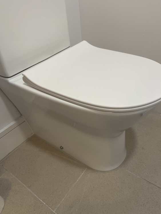

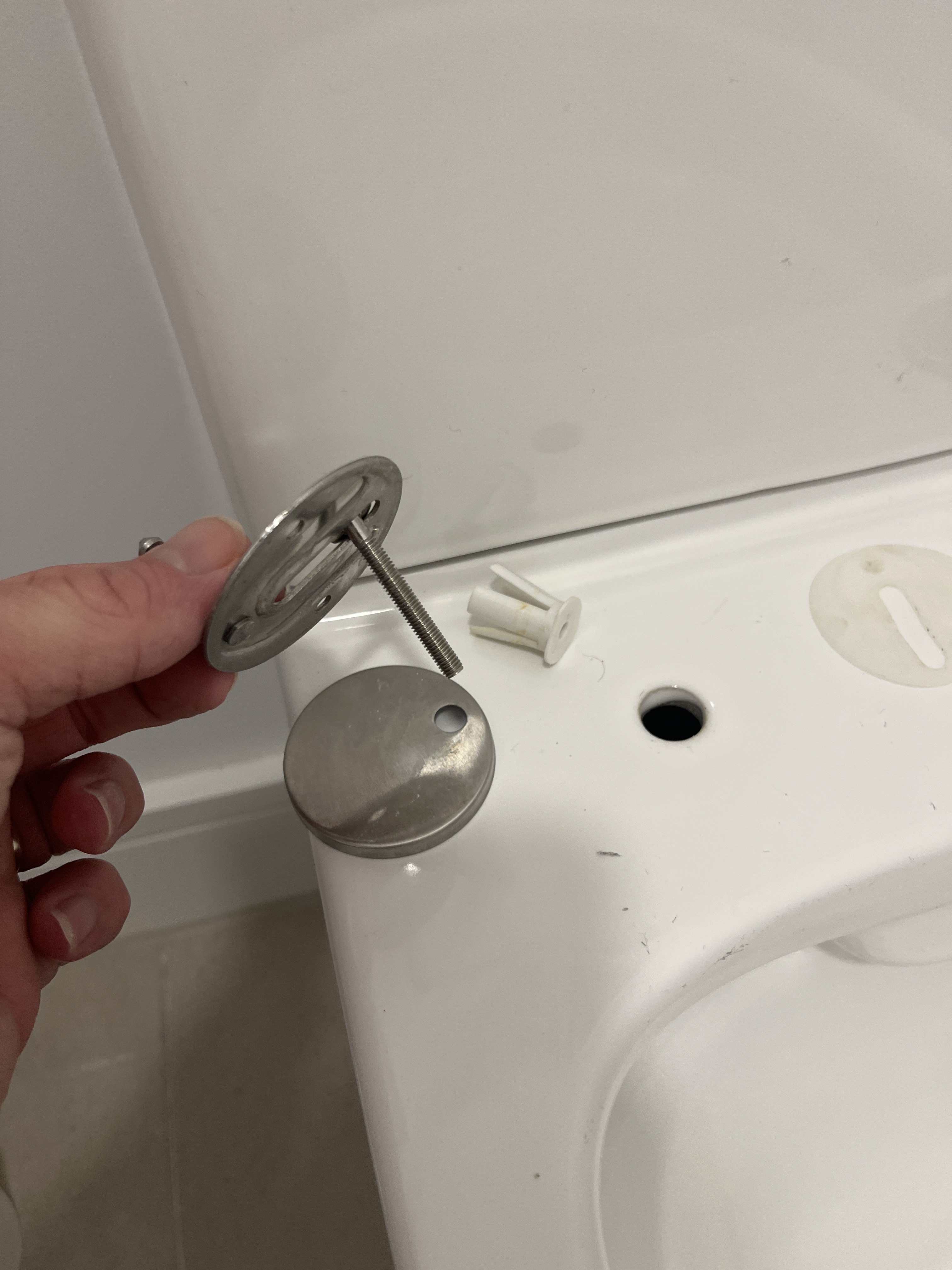

I tried removing my toilet seat to clean it and I dropped the nut inside the hole. It’s one of these close to the wall toilet. What are my options do I need to remove toilet to fix the seat :(

For future reference, you probably can just remove the seat by tilting it up at a 75 degree angle then pulling it straight up, don't unscrew anything like my mum!

Most of these are quick release as above.
If you can identify the size of nut / thread then usually these are stainless steel (so a magnet won’t work) so don’t replace with mild steel.

Do you mean just replace the nut? Is it a standard type of nut that works with that plastic
It's usually just a standard hex nut held captive in the nylon / plastic receiver.
