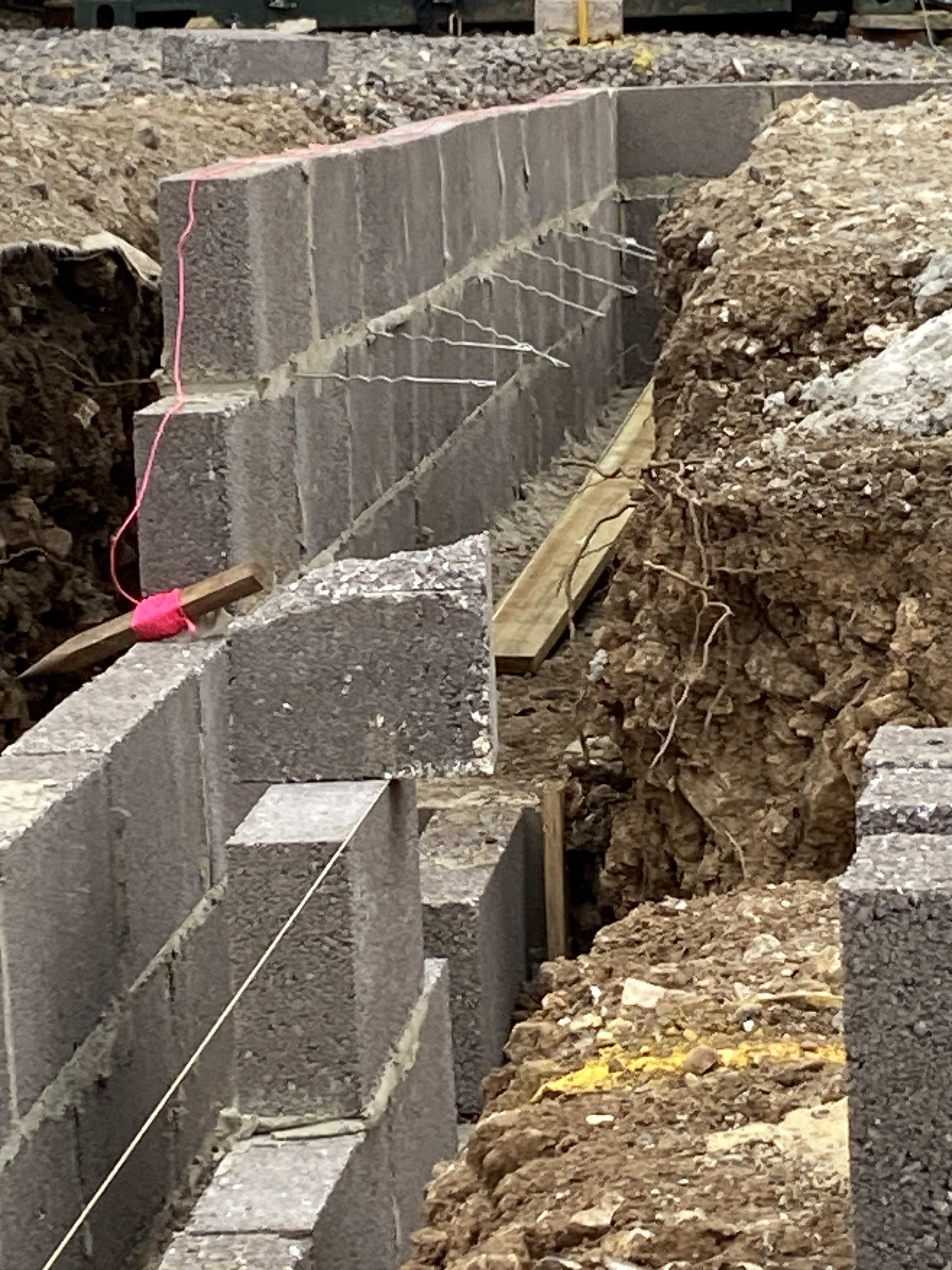

flanagaj Posted 8 hours ago Posted 8 hours ago Just had a good look at the foundation masonry done by the brickie last week and it’s rough. he say it doesn’t matter as it’s not seen.

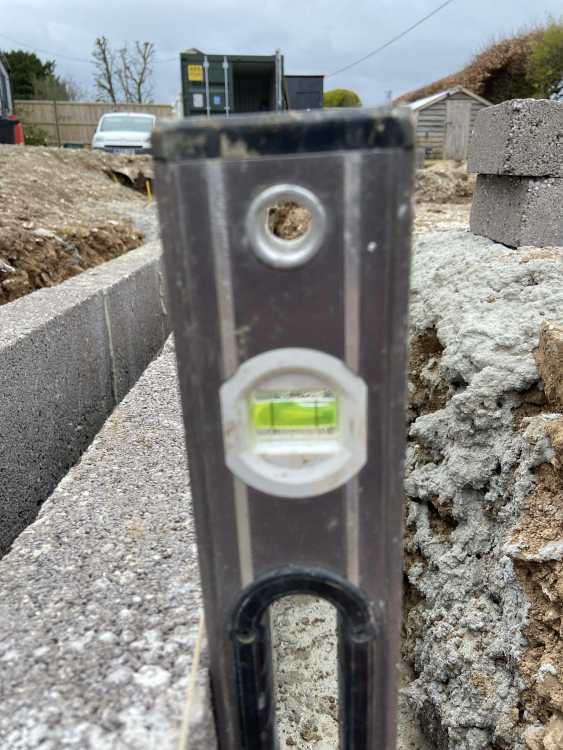

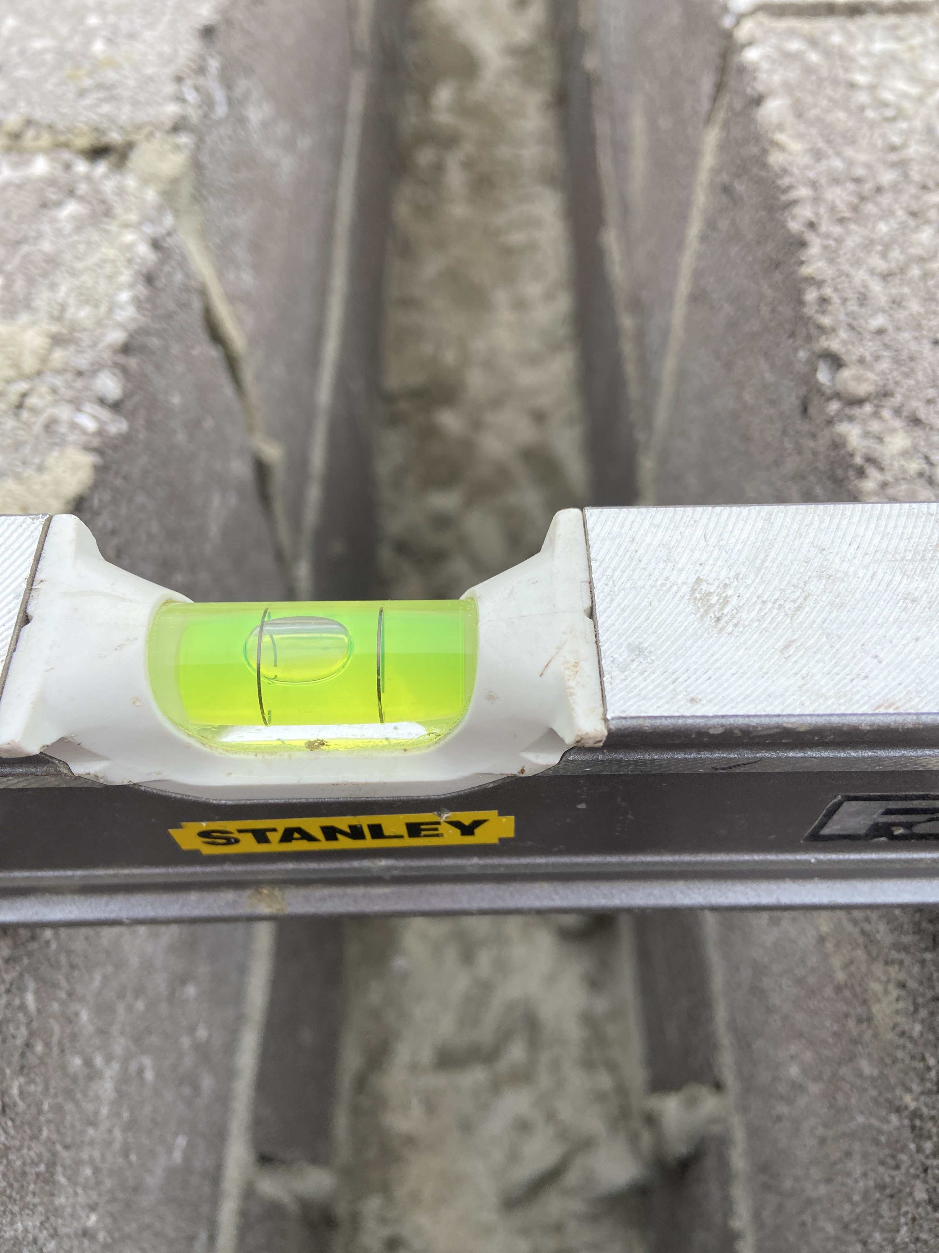

Redbeard Posted 7 hours ago Posted 7 hours ago Hmm. What does that out-of-plumb bubble represent? How far is it leaning in how tall? From LABC Warranty: "How far out of plumb can a wall be in the UK? Wall panels should be erected to the following tolerances: • +/-10mm from plumb per storey height. +/-10mm from plumb over the full height of the building. +/-3mm from line of sole plate, with maximum +/-5mm deviation from drawing". In pic 3 (with a slack line on top of the blocks) where was the line when the blocks were laid? Is this the brickie you were planning to use above ground?

flanagaj Posted 6 hours ago Author Posted 6 hours ago 44 minutes ago, Redbeard said: Hmm. What does that out-of-plumb bubble represent? How far is it leaning in how tall? From LABC Warranty: "How far out of plumb can a wall be in the UK? Wall panels should be erected to the following tolerances: • +/-10mm from plumb per storey height. +/-10mm from plumb over the full height of the building. +/-3mm from line of sole plate, with maximum +/-5mm deviation from drawing". In pic 3 (with a slack line on top of the blocks) where was the line when the blocks were laid? Is this the brickie you were planning to use above ground? That vertical bubble is only over two courses. Yes, this was the brickie that we were planning on using, but he'll be given his tools tomorrow morning from the lock up. It's very disheartening that a tradie think that work is acceptable. I've just got my laser level out and the corners of the garage are 20mm out on the horizontal. There is also a block that's got no vertical mortar, it's literally directly butted to the adjoining two blocks.

Nickfromwales Posted 3 hours ago Posted 3 hours ago That block-work is shockingly poor. Zero GAF, and there’s no way whatsoever that person should be doing anything for face work. If you don’t care about stuff that’s not on show, to that extent, as the horizontal line looks like a waveform, then there won’t be much more care for the remainder. Shite. 1

ETC Posted 2 hours ago Posted 2 hours ago Why are you building sub-floor blockwork in cavity construction? Would be better solid - plus easier and quicker to build.
flanagaj Posted 2 hours ago Author Posted 2 hours ago 2 minutes ago, ETC said: Why are you building sub-floor blockwork in cavity construction? Would be better solid - plus easier and quicker to build. He said he was happy to do cavity blockwork. I'll ask the next bricklayer whether he'd prefer trench blocks.
