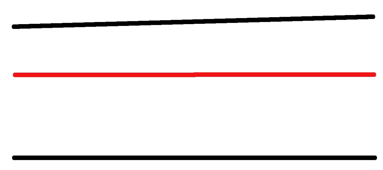

I've run into a snag with my cut rafter plan. My ridge beams are level, and the new wall plates are level, but I didn't measure the span distance between the ridge and the walls all the way along. I foolishly assumed everything would be parallel - I really should have known better.
One side of the roof is proceeding as expected. 50x150mm rafters at just under 35 degrees with a birdsmouth seat length of 60mm. The side with the progressively diminishing span isn't going to work at the shortest end. The angle changes, and the projection of the rafter at the foot is quite a distance away from the eaves edge.
If I put a piece of 22mm timber under the worst offending rafter with the current birdsmouth cut, everything works, but i'd obviously need to use progressively smaller bits of timber on the other rafters.
If i reduce the birdsmouth seat length, I can get it to work with the existing wall plate, but i'll be heading toward 30-35mm seat length. What is the accepted minimum seat length? I can only find details for maximum birdsmouth depth.
An exaggerated plan view of the roof attached. Red=ridge beam Black=eaves.
How would you resolve this?
If that side of the house is "out of whack" then you can only build up the internal side and mask it, leaving the wonky stuff only visible outside; assuming the building is out of whack vs the plate having splayed outwards?
It's definitely the building being somewhat less than square. The wall plate hasn't budged at all.  At the worst point the span is > 75mm less than the opposing side.
You would keep the 60mm birds-mouth seat and shim the wall plate height for each affected rafter?
I would shim the rafters, so that the plane of the roof remains constant. This obviously has consequences for inside the building with ceiling heights etc. If this is a new build, i feel for you. The importance of keeping walls square when building is often overlooked. People seem to concentrate on levels. Squareness and angles are just as important. If you have room on the inside, i would think about dropping a false ceiling in, to keep that level.
60mm, although it sounds quite small, is going to need some get arounds, to not end up looking shite. If a new build, was it set out correctly, or has One of the walls got a lean in, or out while being built. Regardless, bit late to do anything about it now, if that is the case.

I spent a while experimenting with different things and I've opted for a lump of C16 under at least 2 rafters. A handful of stainless screws and once i've finished cutting the rafters and levelling i'll finally fix with cascamite and screws. The timber adjustment pieces get gradually thinner to follow the adjustment required. This gives me the same birdsmouth cut as the unadjusted rafters, so less mucking about marking and cutting.
Bit late to this but I think I'd have preferred to seat the rafter on the 30-35mm you already have and supplement that with some substantial metal connectors. That would keep the plane of the roof flat. A company like Simpsons can probably suggest a connector (I joist rafters can be attached without any birds mouth after all)
Won't raising the rafters at one end like this give you trouble later as there'll be a bit of a bow on your roof battens - hopefully not enough to stop individual slates sitting flat.
With what you have, I'd still want a better mechanical connection between rafter and wall plate and would nail not screw (unless they're structural timberlok or something) for more shear strength. You need to be a bit careful you're not fixing your rafters mostly to the thin timber and leaving your wall straps holding down the wall plate below it, but not so much holding down the roof itself.
Whilst experimenting, I was mindful of the plane of the roof. The adjustment timber brings the rafters in to the same plane and down to the same angle as the unadjusted rafters. I chose stainless screws for the glue/timber connection specifically because they will bend and not snap. With the cascamite and the large bonding surface area, the connection should be stronger than the wood itself.
I'm not using nails to hold the rafters themselves in place. I'm using M8 stainless coach screws through the rafter into the wall plate. Pull-out/pull-though force for each connector is considerably more than skew nails.

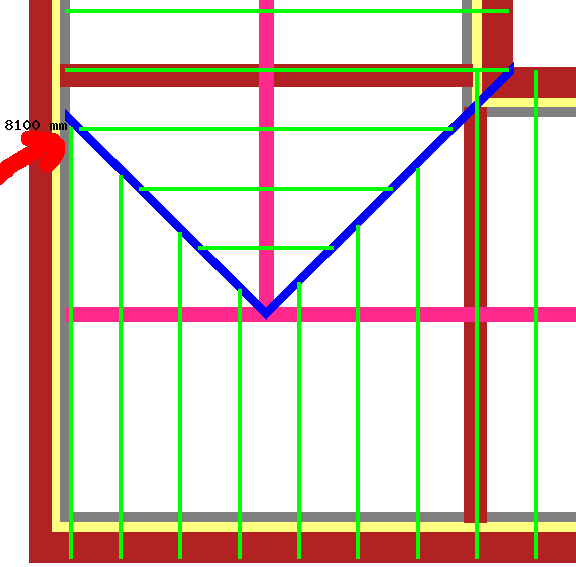

I'm at the jack rafter point now.  How many nails are required in a 44x142mm valley jack cheek connection? I'm hand-nailing. What size and at what angle should the nails be inserted?
All of the cheeks are easily accessible bar one. The jack rafter next to the gable will be 50mm away from the blockwork. Not much room at all there.
3 nails id have thought. It’s not something I ever give a lot of thought to just stop nailing when it looks right. The one next to wall just nail thru back of hip or valley into jack.
I've never had to nail this type of timber connection. I don't want to make a mess of it.  How far from the feathered edge should the nails be? Half way up the length of the cheek cut or more toward the uncut part of the timber?
The valley rafter is a doubled up 44x142. It will need a long nail to go from the back 😯

Is the blockwork already built up on the rake? If not you can nail it beforehand. Otherwise tosh one through top and bottom, not ideal. I've never really thought about nail position just do what looks right. A nail wants to be 2/3 into the back 1/3 into the front usually so just work on that principle. Obviously you dont want it near the thin cut edge it won't be doing anything. You want quite a lot of meat.
Most of the internal wall and PIR is in place. Enough to be in the way.  Are structural screws acceptable? If all else fails I could get something like timco index screws in place and wind them in with a ratchet spanner.
When you drive your nails in, do you drive them perpendicular to the valley, perpendicular to the jack or somewhere in between?
  • 3 weeks later...
I went with a pair of locating nails driven perpendicular to the jack rafter face and three 4.5mm Ø nails at ~23° to the jack rafter face at the thickest part of the connection. All piloted in the jack.
