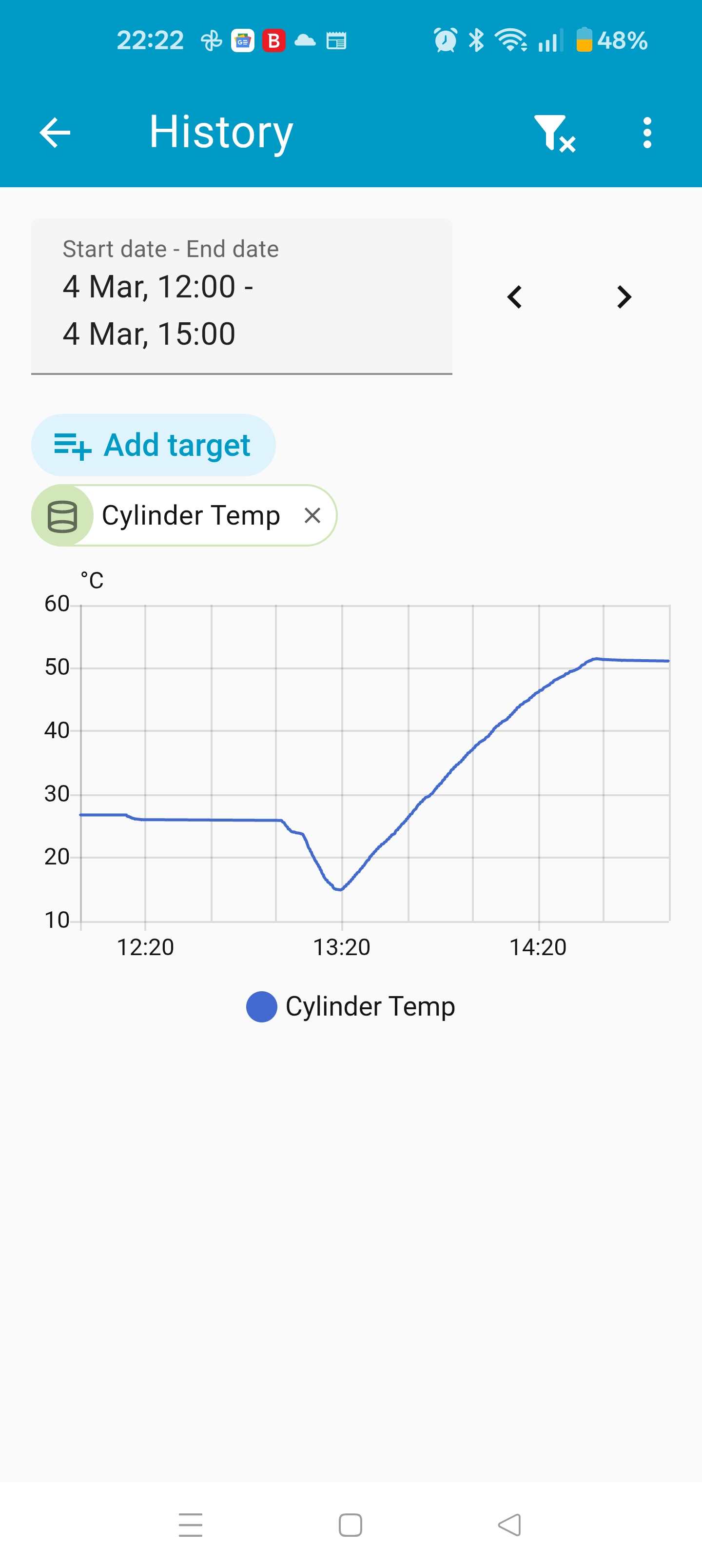

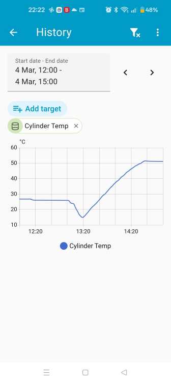

March 4Mar 4 This is ours heated via 3kW immersion. 210L slimline cylinder. Temp messing about 1/3 up from bottom. Basically 1hr or 3kWh to heat.
March 5Mar 5 18 hours ago, Selfbuildsarah said: 🤦♀️🤦♀️🤦♀️ Anyone know a good installer in Cambridgeshire? @Dreadnaught may know one?
March 5Mar 5 20 hours ago, JohnMo said: Our Haier 4kW will kick out over 6kW, even though the datasheet doesn't state it does. So will easily heat a big cylinder. But we use the immersion. Wow even at low temperatures? I assume the 4kW and the 6kW are essentially the same units with some software limit applied
