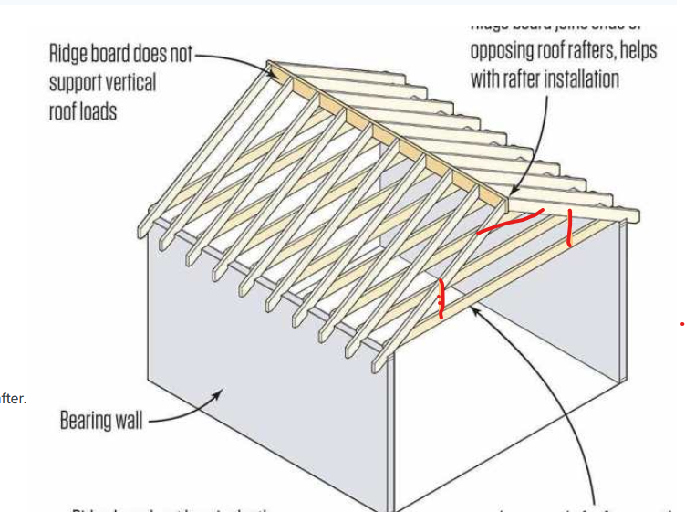

Picture would be helpful of the existing situation. Can you put a plate ontop of existing ties or would it not be above existing due to rafters
It's just like this but with ties every other rafter.1020-jlc-q-a-ridge-beam-web-01-3364664326.thumb.jpg.25893f7ad0d75dd584633d735455f1af.jpg

Not without damage as the felt is properly fixed. I have to say that compared the the old bungalow, this garage was well built with attention to detail.
