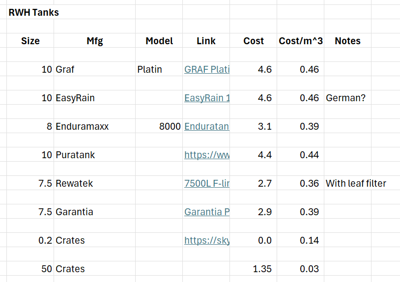

saveasteading Posted February 18 Posted February 18 Great to see a rainwater tank. What capacity? How will the water be used? You can put a catchpit just before the tank and it will catch all the dirt. I put one in before a 10m3 tank and it never needed attention in the 15 years I had ownership. Catch the leaves before they get on the system. 100mm pipe has to stay. Aco can feed into it. 1
flanagaj Posted February 18 Author Posted February 18 2 hours ago, saveasteading said: Great to see a rainwater tank. What capacity? How will the water be used? You can put a catchpit just before the tank and it will catch all the dirt. I put one in before a 10m3 tank and it never needed attention in the 15 years I had ownership. Catch the leaves before they get on the system. 100mm pipe has to stay. Aco can feed into it. I still need to size it, but thinking 5000 litres. 1
saveasteading Posted February 18 Posted February 18 That's a good size. It will catch and hold a big downpour, which is important in a dry spell. Depending on cost and space available, consider 2 smaller tanks. I'm planning one now, and it will only be for garden watering. So I can't see a problem using a redundant plastic oil tank.... they are free from any heating plumber or on Facebook. The oil traces will be insignificant. 1
flanagaj Posted February 18 Author Posted February 18 9 hours ago, saveasteading said: That's a good size. It will catch and hold a big downpour, which is important in a dry spell. Depending on cost and space available, consider 2 smaller tanks. I'm planning one now, and it will only be for garden watering. So I can't see a problem using a redundant plastic oil tank.... they are free from any heating plumber or on Facebook. The oil traces will be insignificant. I also like the idea of a large tank as if the soakaway ever failed, I could simply fit a submersible pump into the tank and sneakily pump it out onto the road, which then flows down to a very large pond which always has loads of capacity. Hoping it would never be required, but it's a useful backup.
