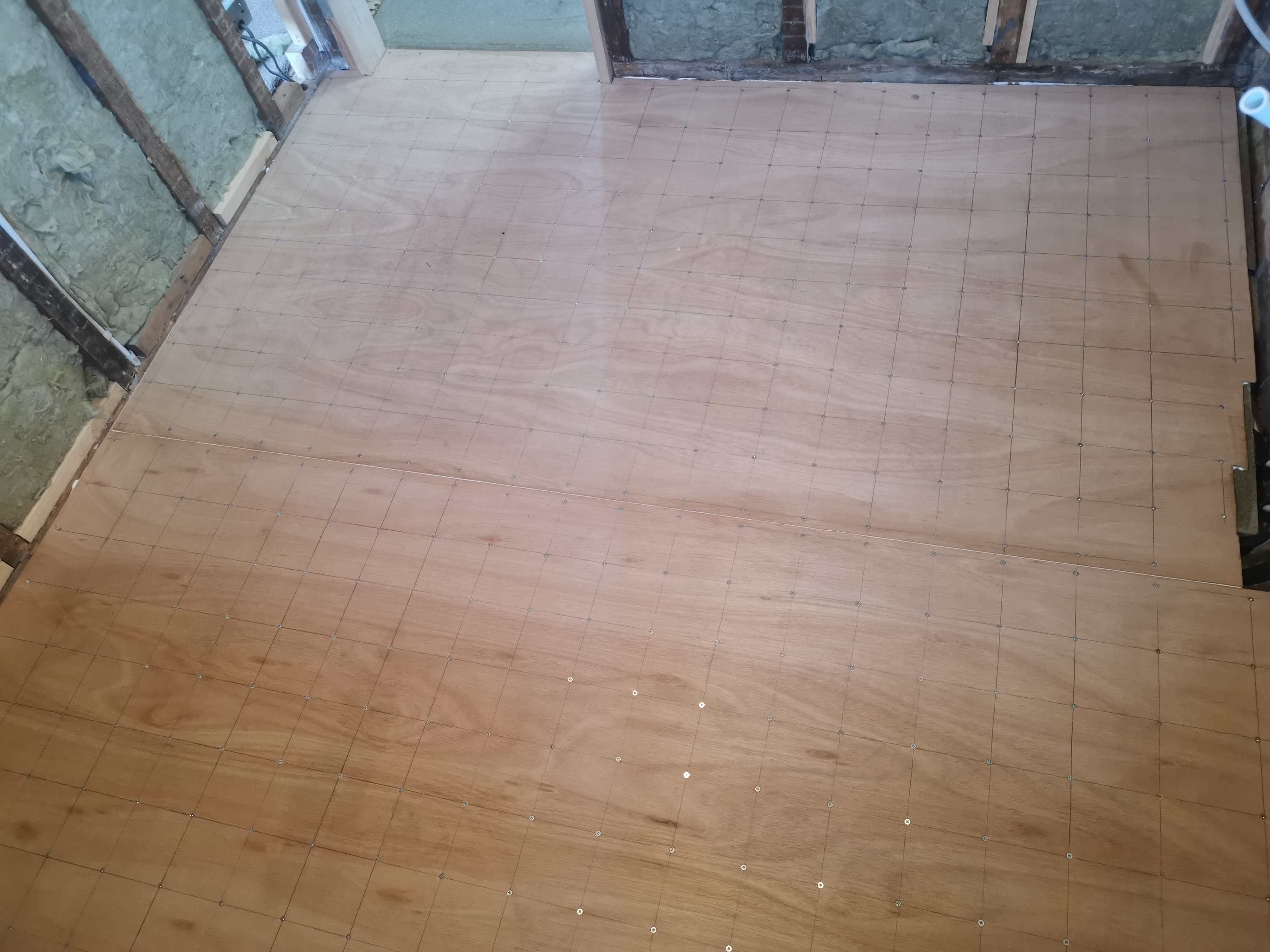

Use LOTS of 4.0 x 25mm screws to fix the plywood down, and if the subfloor is even SLIGHTLY suspect I put the ply down over a 3mm notched bed of neat PVA.
That's my plan. 25mm seems scarily close to the pipes though. I've got 20mm and 25mm screws, just to see what I dare put in. Seems 25mm is only an impact driver away from spoiling the whole party with the pipes underneath.
22mm deck or 18mm deck?
If 22mm deck, plus 6mm ply, then you’ve got 4mm before you poke out the other side.
My impact drill has 4 setting for speed / torque, so is much more manageable, but if you’re not rushing you’ll be fine.
I mark a grid out and go for a minimum of 120 centres, 100mm best practice imho. Never had issues so I don’t deviate from this.
How many screws is this, jesus 😂

9 hours ago, Nickfromwales said:
Aye I've got my screws all ready. Just seems a mental amount to put in but I've already drawn the grid now, looks like a Sunday afternoon job.
Ran a few tests, think I'm ok with the depth and 25mm screws, takes a lot to get it to go through the other end of the chipboard to be fair.

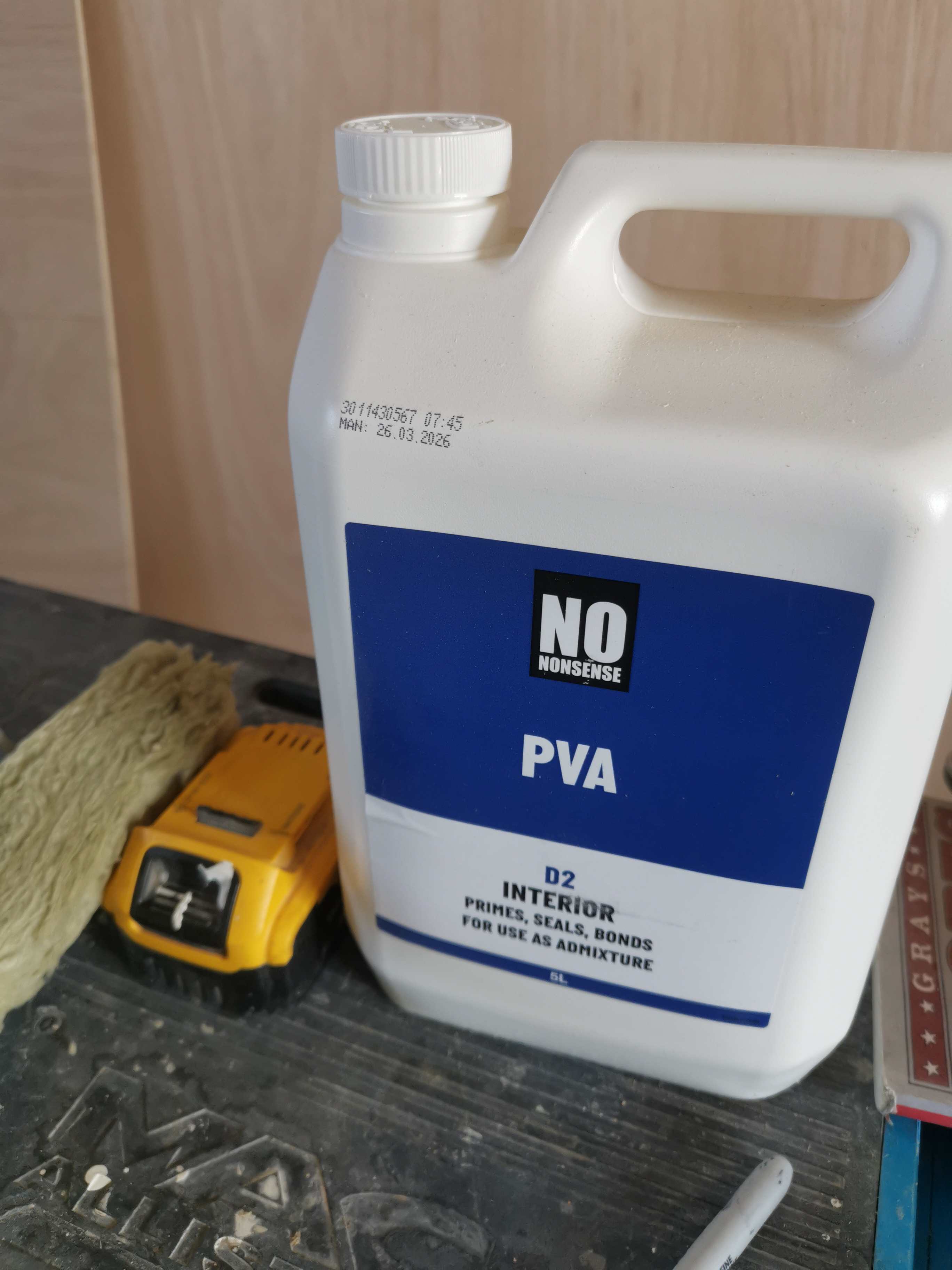

Am I just throwing down a load of PVA onto the P5? Just brush the chipboard down, PVA the lot and go to town with the ply and screws? Seems an easy enough job for today.
Yup. You’d need to punch them almost completely through the ply to cause any issues, so plenty of time to get off the trigger.
Don’t panic if one starts to head in and you didn’t halt at the perfect moment, as that kind of hesitance could mean you're not actually pulling the ply 100% tight to the deck, which is far worse.
Just get the screw to pull in so it’s a little countersunk and job done.

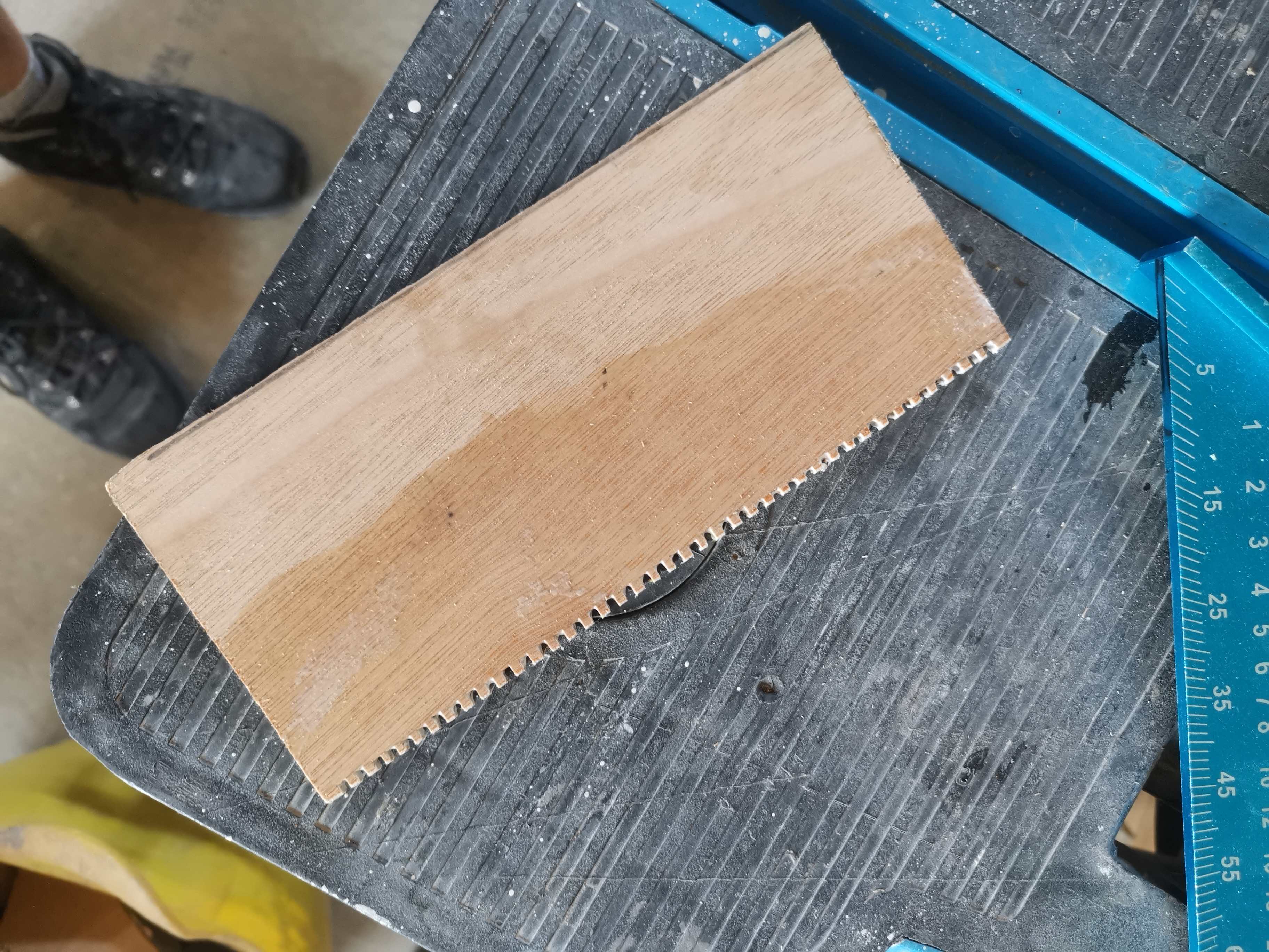

I use a 3mm notched tile adhesive trowel if it’s a big area, but you can make a ‘comb’ with an 8” bit of the 6mm ply and just cut a load of notches our with a saw.
That's what I'll try my man, thanks for the tip.
Apologies for butting in, this PVA, is this the same as the contractors liquid PVA that you dilute down, or is this special thicker stuff specifically used as a glue?
Hopefully normal stuff as I got this from Screwfix. Just about to start but I'll hang fire 😆
