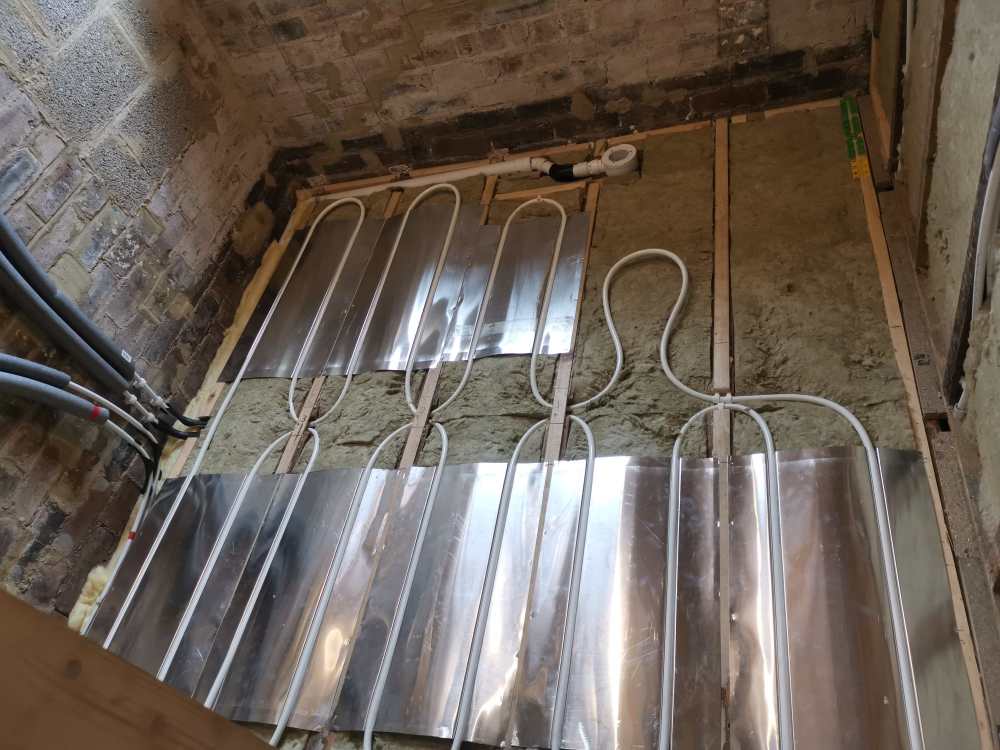

I'm going to extend my UFH to the small bathroom (3x3m) and I'm struggling to find the build-up that would be best. For info the bathroom doesn't really need it, putting it in just to take the edge off a cold floor when barefoot.
My initial plan is PIR between joists, pipes clipped to it (or spreaders).
The original floorboards need to go, so this is where I'm struggling for info.
Replace subfloor with chipboard/ply? Then if I want to tile, do I need to go over this with say 6mm cement board? Insulated tile backer is adding insulation that I don't need.
I assume I don't tile directly into the subfloor.

    Go for spreader plates, but allow some rockwool under them, atop the PIR, so the plates are sprung upwards slightly. Then, when you screw the 22mm P5 deck down there will always be great surface conta

Go for spreader plates, but allow some rockwool under them, atop the PIR, so the plates are sprung upwards slightly. Then, when you screw the 22mm P5 deck down there will always be great surface contact between the aluminium plates and the underside of the P5. Without this, the heat transfer suffers somewhat.

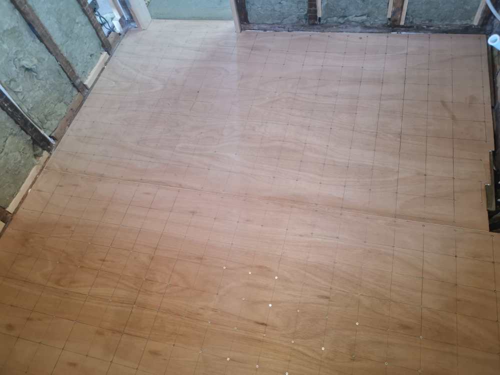

I've never used backer board and only ever 6mm or more of plywood (glued and screwed down) and then tile straight onto the ply. For 6mm ply and 22mm deck you use 25mm 4.0 x 25mm screws to lay the ply so you don't hit a pipe.

Just about to order my sub floor for this, @Nickfromwales would you recommend 6, 9 or 12mm ply over the 22mm P5? Got my spreader plates at the ready.
Edited by Super_Paulie
You select this to your advantage, to balance floor levels from room to room, sir.
6mm is plenty, just make sure to glue and screw it down to the P5, and you will be triumphant.

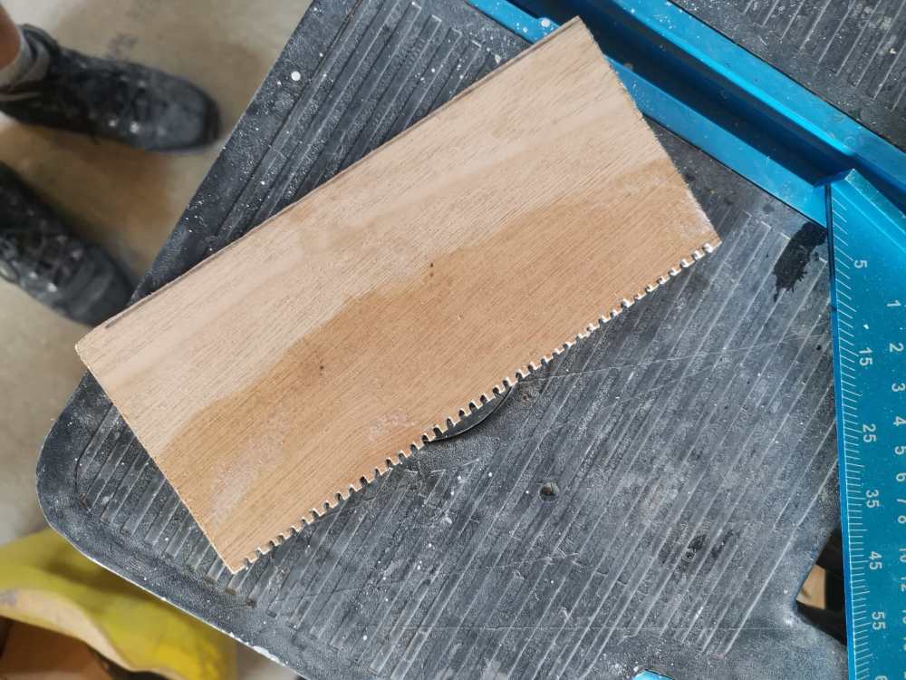

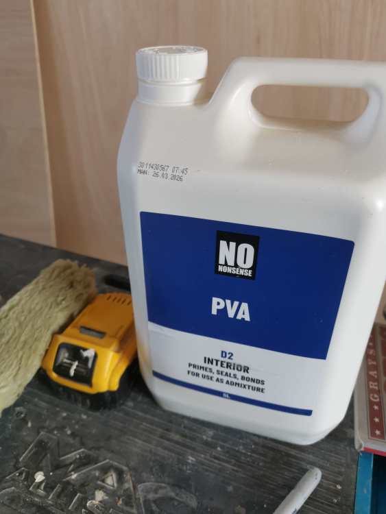

I use PVA with a 3mm notched scraper on the P5, and lay the ply down onto that whilst wet. Then screw the ply down with 4.0 x 25mm screws at 100-120mm centres max.
