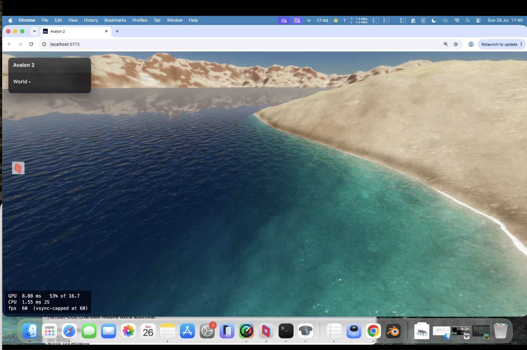

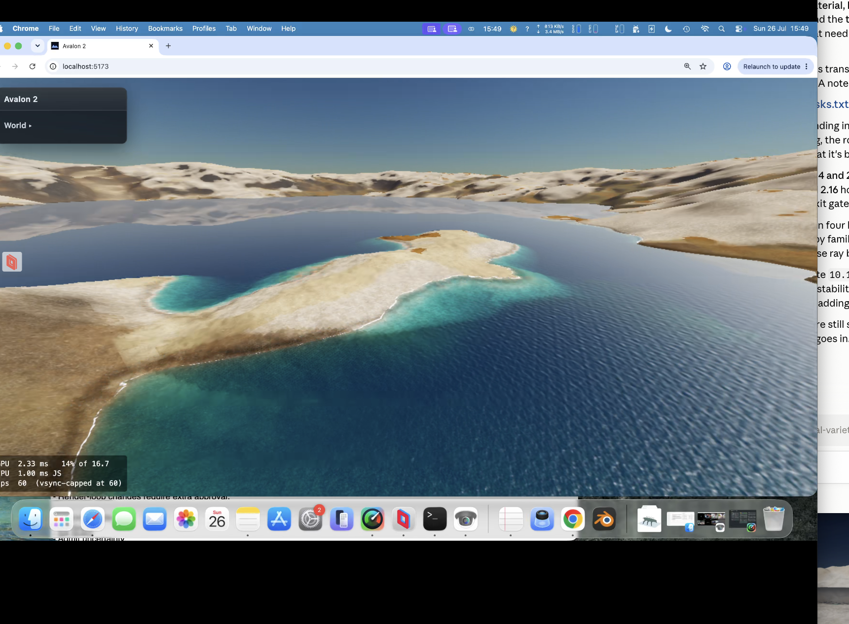

Been a slog. Up'd opus 5 to max (no idea if that truly benefitted tbh). Perseverance pays off with these things though. Near photo realistic landscapes now - eclipses previous effort by some margin.
But nothing to show yet until we beat my personal PITA ..... WATER.
Such a difficult thing to get right; always a compromise on visuals against performance. Usually looks cheap or just too "gamey". So like the terrain we are going for realism. To achieve that I decided we need to model how/why/where volumes of water form. My logic being if its physically correct then we are half way to it looking correct. Usually these things are cheats like most 'effects'. So we use what we have plenty of... ram. For shadows for example to save a few computes per pixel the entire landscape shadow map is pre computed (around 8gb) - it can be optimised later size wise. Doing just this knocked 5% of render time. I can think of similar such tricks for water.
water now is staggeringly good! Proper beer/lamb for depth, waves, lapping, water's a bugger because the same water looks different depending on your view. Look at your feet see the seabed, look across it and it can be almost dark. Managed to get that working successfully.
image.thumb.png.256b2d631d1d22a529e4987f64bd2dd5.pngimage.thumb.png.7768c99368c3aba0f1446a5d5b8d36ef.png
The second picture is good except for the regularity of the wavelets. There is something odd about the first picture, but I can't really put my finger on it. Maybe the dark area in the distance shouldn't go right up to the beach, perhaps there should be a thin strip of blue by the sand.
Yeah the waves do have a mathematical view. Easy to see when static, less so when moving. Procedural generation will do that!.
3 minutes ago, Gone West said:
Oh dear, perhaps I shouldn't have gone there.
I'll do a video at some point. Water from a certain angle with certain lighting looks 100% convincing. Static's can't show that. Regarding your 2nd comment - not sure exactly what you mean and again depends on camera angle. What's the dogs here is zero lod, zero geo morphing, zero z shadow fighting. So terrain no matter how far you can see looks the bollocks. Focus on 1 peak in the distance - move towards it; perfect!. Also remember Work In Progress!image.thumb.png.0e35faf19b244bfc0f78dd6992d675d3.png__dbg.marcher.u.waveEarlyExit.value = 0

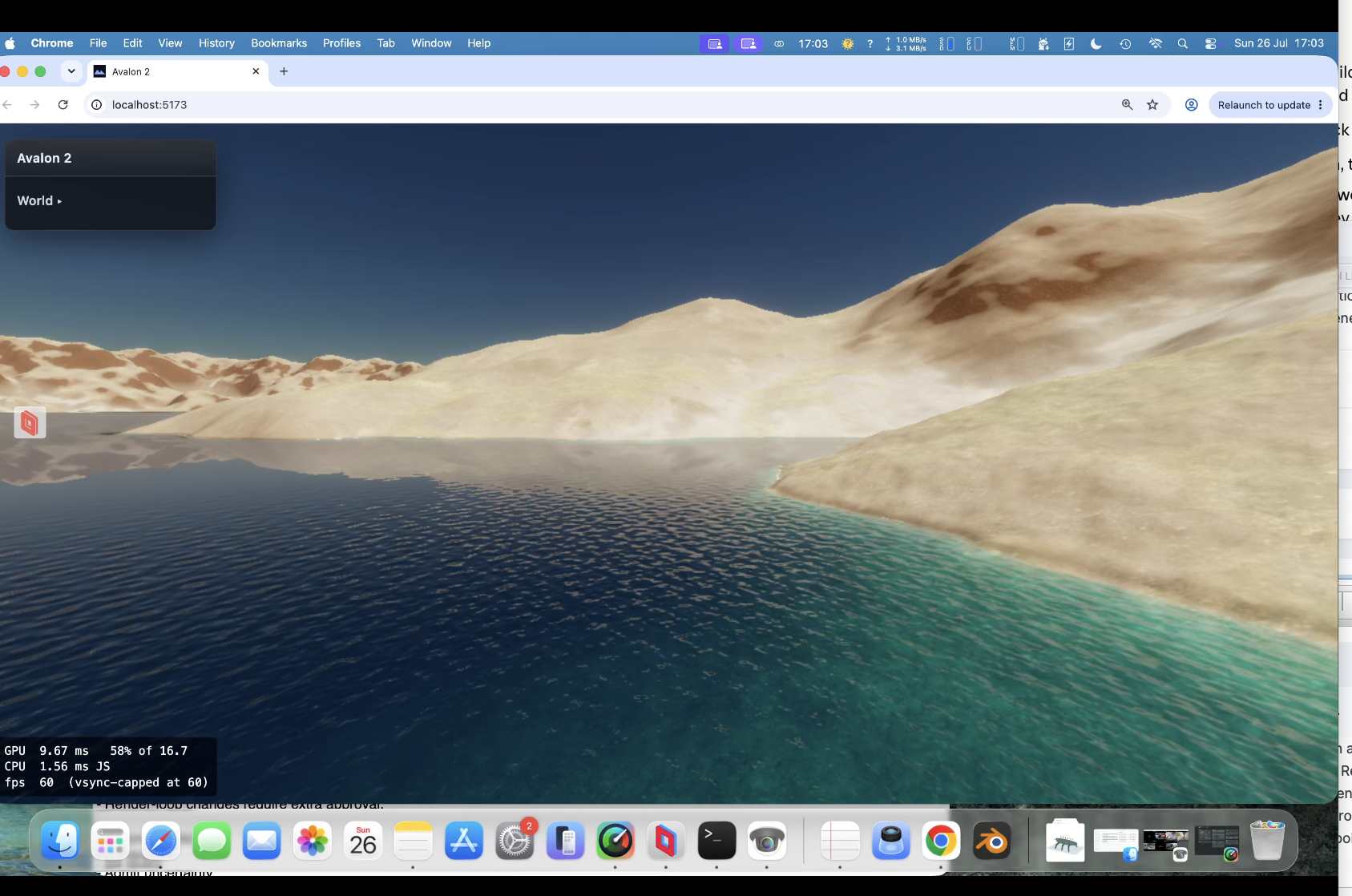

5 minutes ago, Pocster said:
So you find things visually 'wrong' thats fine.

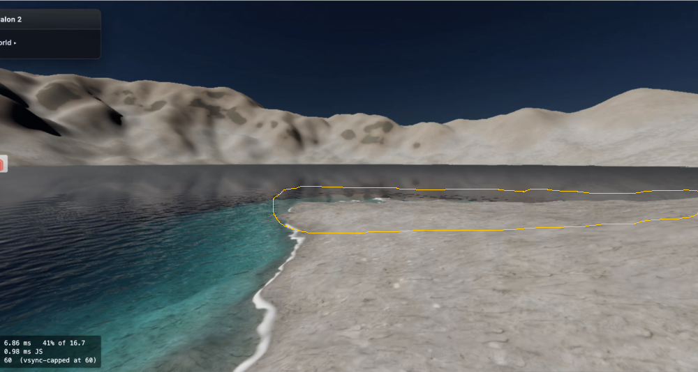

Looking at it more, I think it looks odd because the blue water travels around the edge of the beach, but only for a short distance, before turning dark by the beach. Why in reality wouldn't the blue continue all the way along the beach? There is nothing to indicate that there should be shadow in that area.
Te-he! As I said water looks different from different angles. So near us (the camera) you see the turquoise and seabed further you would not at this angle; i.e. you cant see the nice blue because our angle is so low - we are looking over it. If I pulled the camera up into the air and looked down at that spot it's there. So looking at water and looking across water are very different views - it's something through the previous 5 versions (oh my!) I just couldn't get correct. look at piccy 1; water we are near is 'clear' (depends on a LOT of maths, sun angle, sea bed, refraction, specular etc etc etc etc ), but look across at the mountains, a reflection and is dark. Beer-lambert (remember you started this science/maths argument! 🙂 ). But I'll let my mate Claude answer....
The blue stops because of viewing angle, not shadow. What you're seeing as turquoise is light that passed through the surface, reflected off sunlit sand, and came back out — and how much survives depends on how far it travelled through water, not how deep the water is. Directly in front of the camera you're looking down into it, so a metre of depth costs about two metres of travel and the sand shows through. Along the beach receding to the right you're looking almost flat across the surface, and the same metre of depth costs a hundred times more travel. Nothing survives that, so it goes dark.
That much is real: at grazing angles you genuinely do stop seeing into water, and a photo taken from that low across a lake shows a mirror at the far shore rather than turquoise.
Where ours overdoes it is that the surface doesn't yet bend the view ray. Refraction puts a hard ceiling on the underwater path — about 1.5× the depth, from any viewpoint — so real shallows stay bright the whole length of a beach. Without that ceiling the path grows without limit as the view flattens, and the band dies far earlier than it should. Separately, what replaces it should be a bright mirror of the horizon sky; ours fades reflections to black near horizontal, which is why that stretch reads dark instead of silver."

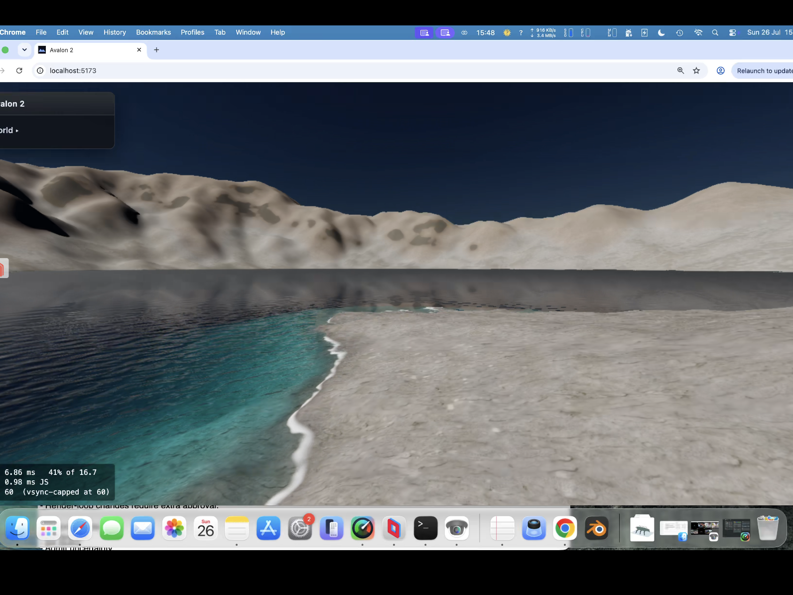

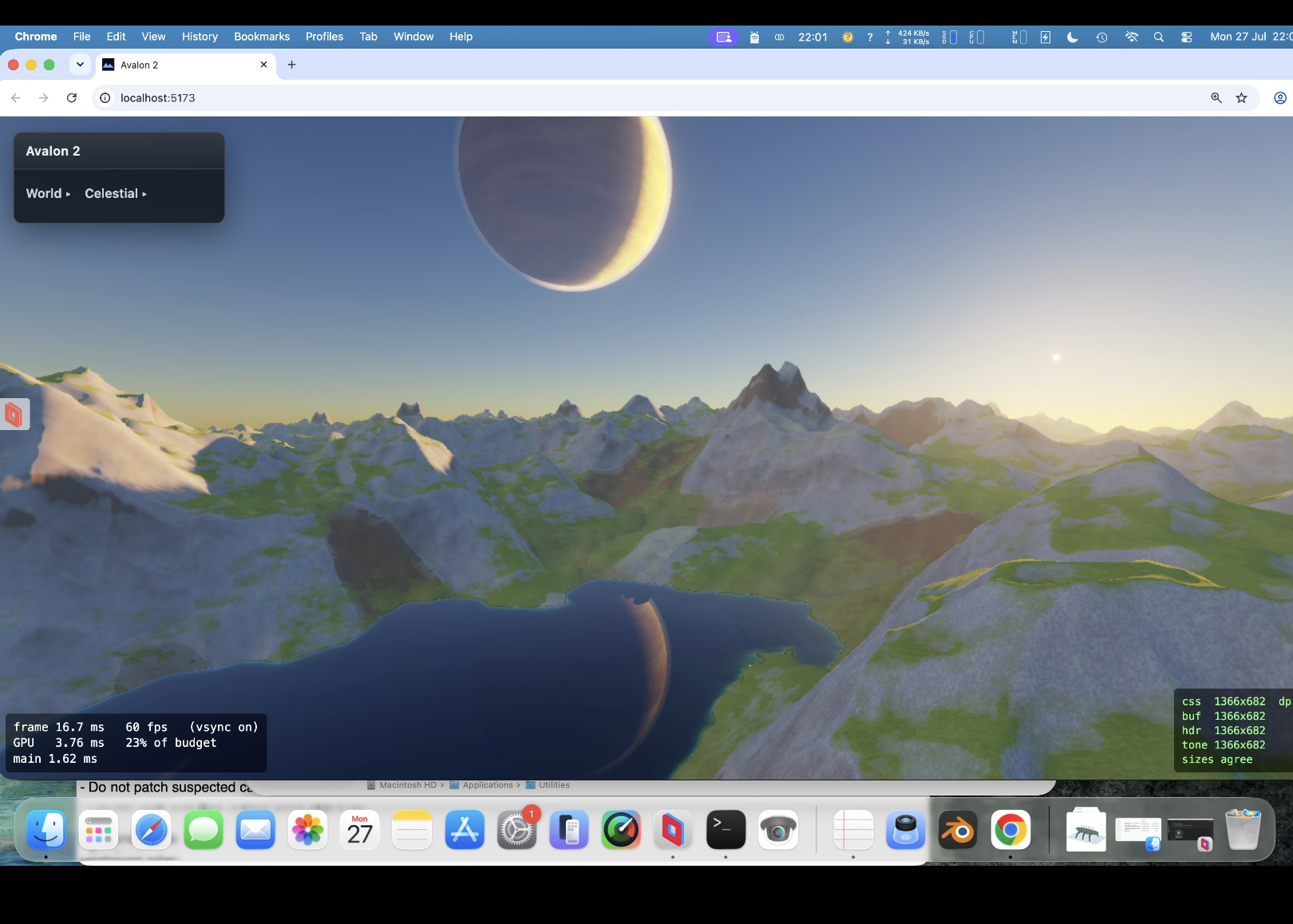

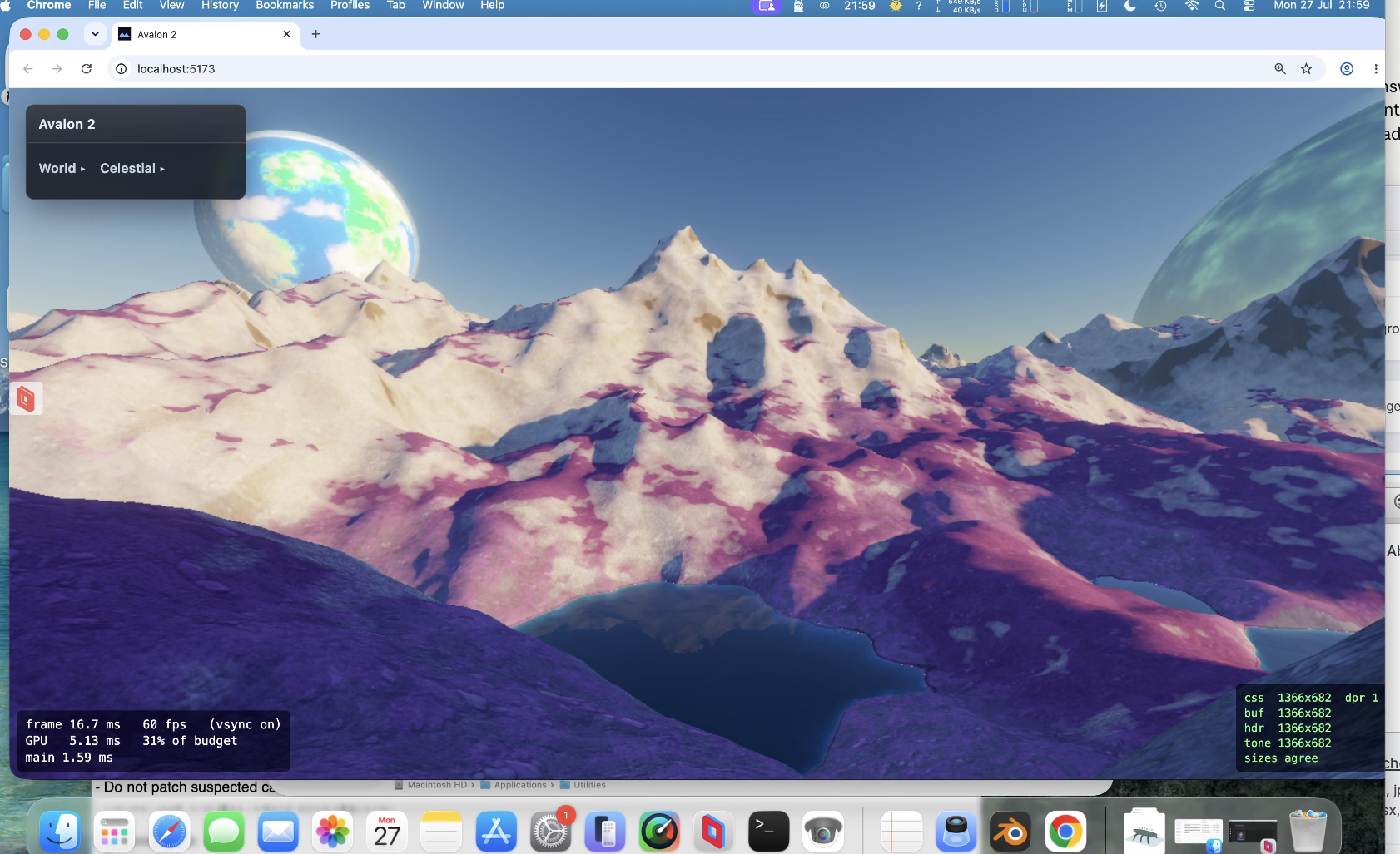

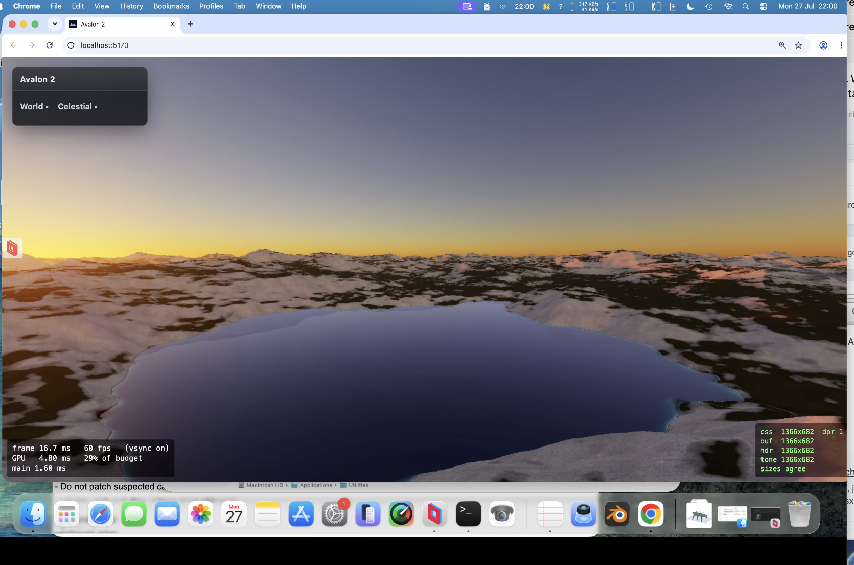

Horrific bugs I'd never had found. Absolute bitches - well above my pay grade. But.....better than my holiday snaps!

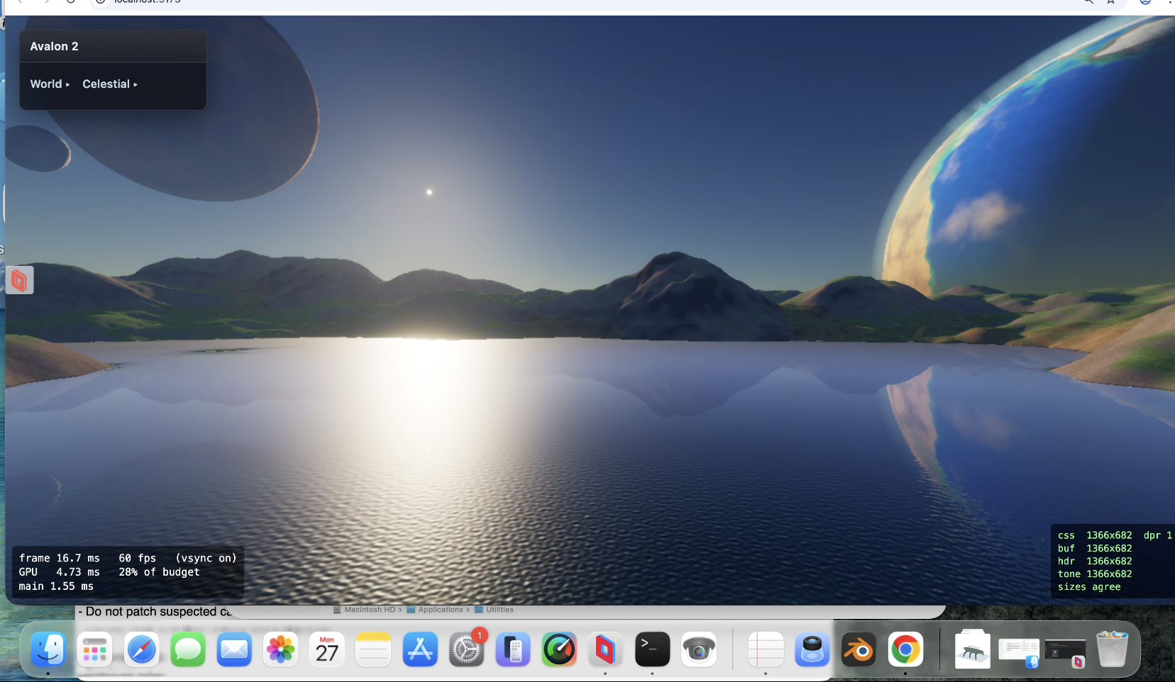

Hit 50% gpu with procedural background planets/nebula/stars. So optimise , optimise, optimise. Took a while now back at around 30% gpu. Proper (frustrating) exposure aswell. So when you look at something really bright you are blinded for a bit and colour 'seaps' back in. Trying to function like an eye rather than a camera (so binned lens flare). Going for clouds again (3rd attempt) - tricky one but got a 25 page spec for it. Then more fun... always bugged me with a height map that of course you cant have arches/overhangs/caves but have another spec for a hybrid system that allows such things.
Another sped up thing was that the baking was taking upto 4 seconds (which bugs me) ; down to 1 second now. So startup is far quicker.

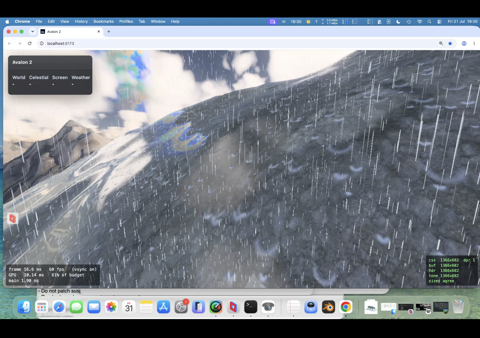

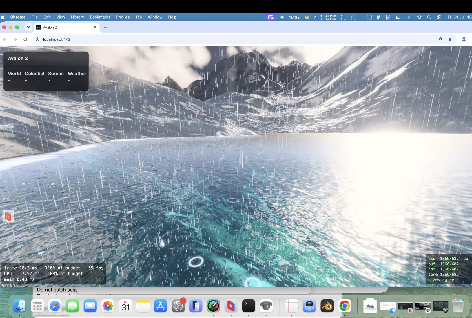

image.thumb.png.23785a7a02089b4c62d442128dbb91a6.pngTaken all day to get right ; Claude wants to quit many times!
Heavy rain actually runs down slopes! Looks fantastic. I dont think even the might Unreal Engine does this.
