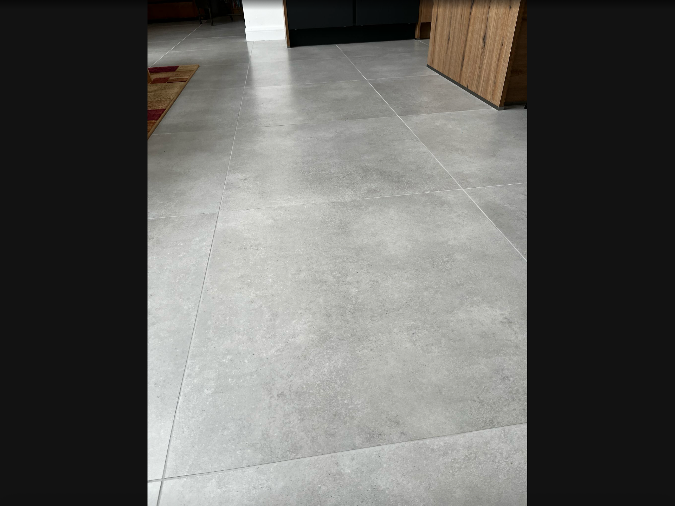

If a domestic client wanted a concrete look I'd recommend large porcelain with that effect ( very realistic,  as concrete tiles really could be made crack free). £50/m2.
Resin does not, of course, look like concrete.
If budget is of interest, you don't need concrete over concrete at all.
Porcelain tiles? I considered polished concrete but couldn’t stomach the cost for something I thought less durable.
This has put me right off! Thanks for this…
