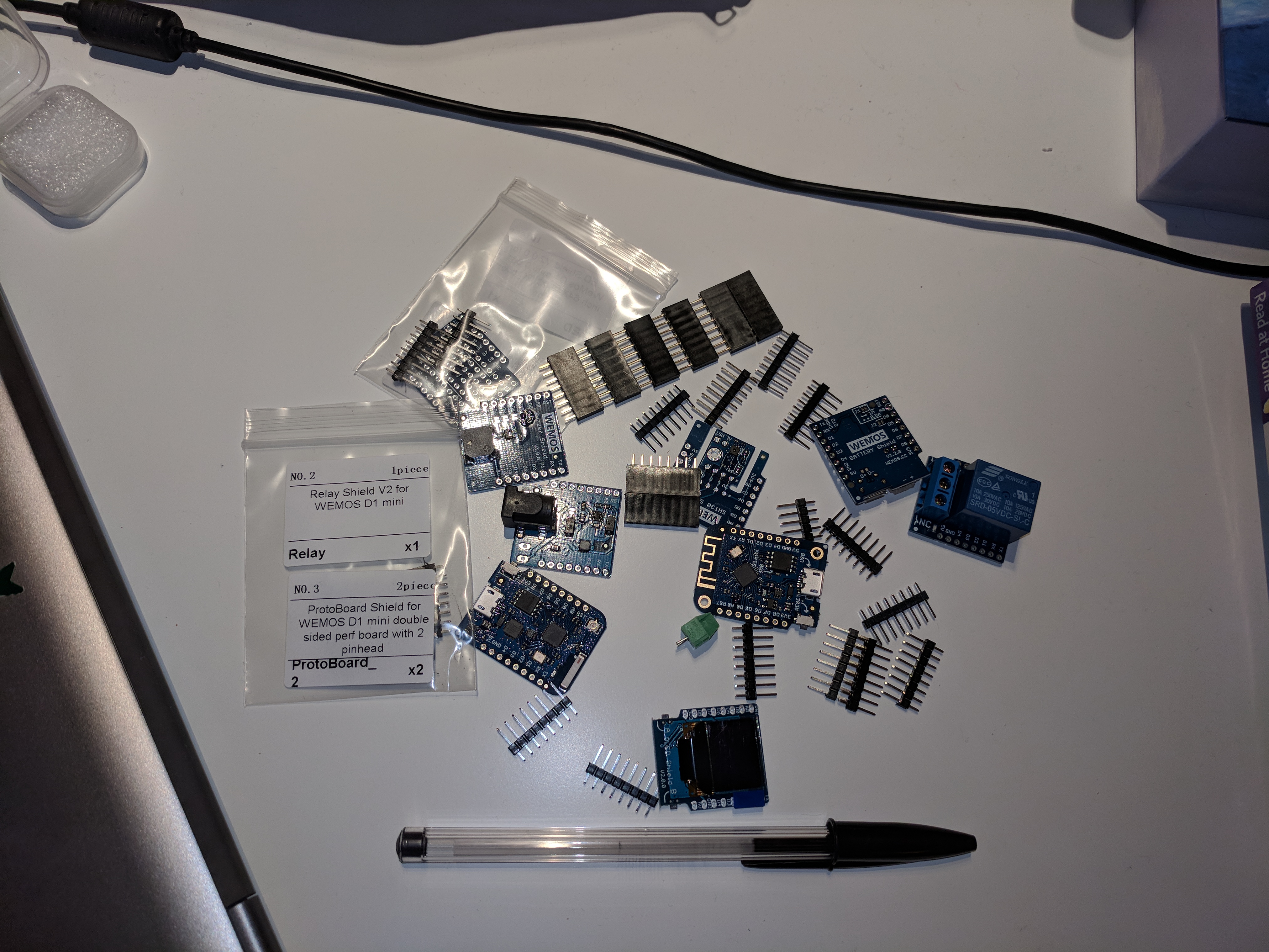

readiescards Posted February 6, 2018 Share Posted February 6, 2018 Wemos arrived, learning time now Link to comment Share on other sites More sharing options...

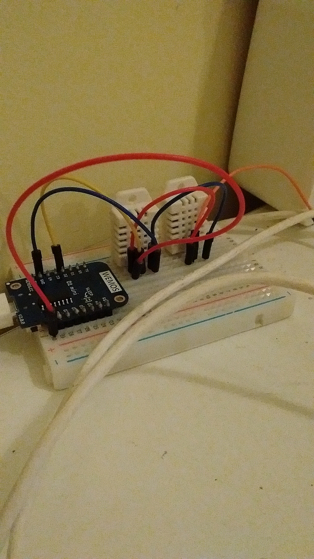

SteamyTea Posted February 19, 2018 Author Share Posted February 19, 2018 (edited) How are you getting on with the WEMOS I have managed to get mine connected to my router, then access via WebREPL or a USB Serial connection on PuTTY. It reads the DHT22s ok as well. That is as far as I have got. To connect to the router, I modified the boot.py file: # This file is executed on every boot (including wake-boot from deepsleep) #import esp #esp.osdebug(None) import gc import webrepl import network import dht import os import machine webrepl.start() gc.collect() def do_connect(): import network sta_if = network.WLAN(network.STA_IF) if not sta_if.isconnected(): print('connecting to network...') sta_if.active(True) sta_if.connect('XXXXX', 'XXXXX') while not sta_if.isconnected(): pass print('network config:', sta_if.ifconfig()) Next is to work out how to get the Wemos to send temperature data to a network drive. How much 'stuff' and you put into the boot.py file, or is it best to use a main.py file (think that runs at boot too) and use the os commands to run separate micropython files Edited February 19, 2018 by SteamyTea 1 Link to comment Share on other sites More sharing options...
