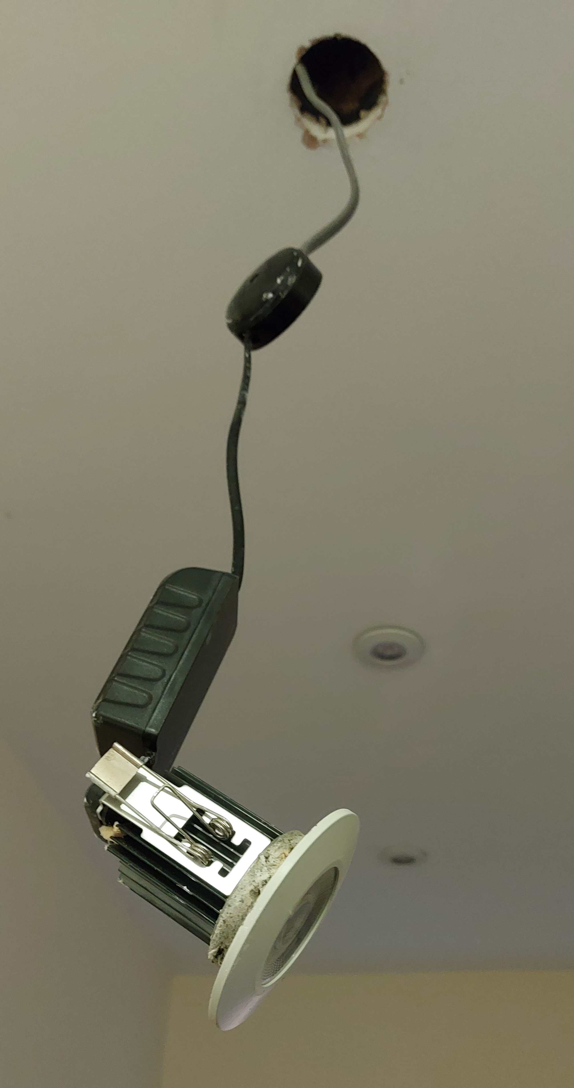

I thought this would be simple until I removed the failed one. This looks so complex and bulky, esp considering there are 10 like this.
10 years old or so, fitted by electrician so I'm not familiar with it.
I guess I just buy another, see how it is connected and either connect via the junction box or omit it.
Any advice?

Yes picture may help.
NEVER fit downlighters where you cannot change the lamp, and stick with 240V lamps e.g. GU10.
If you ignore that advice and fit downlighters with a fixed lamp, buy PLENTY of spares, so when they go wrong in 5 years time and they are no longer available, you at least have some spares to keep you going.

Oops, forgot the picture.
I've fitted some and changed the bulbs fairly regularly but this was by an electrician we trusted and we let him get on with it.
That's why I'm surprised how huge it all is.

Just open the circular junction box and remove the offending article.
Are these units in the pic fixed modules or can you replace the lamp?

The lights on SF and amazon seem to be integrated,  i.e. can't change the bulb.

He probably fitted his own JB's as some of the junction boxes built into light fittings are dire and impossible to connect 2 cables to (loop in and out to next fitting)
did the very same. Cut them off and replaced with the in-line Wago light boxes for each spot.

I'd really like a make and model if anybody has one to hand. Aurora do indeed look good but there are so many options, some with sub- boxes, some integrated
Base unit + bezel + lamp also looks sensible.

Yes, I've got 8 Aurora E8 fire rated dimmable LED down lighters in the hall. They're on for several hours a day and been installed for 5 years with no issue. https://www.tlc-direct.co.uk/Products/AUDE8CW.html
At one time I would have agreed with Prodave about replaceable lamps, however decent fittings are very reliable these days and even if you have a failure the holes are generally a standard size and replacements are not that expensive.

I've ordered that i the warm version, Very impressed with the TLC website, especially at the end when it lets you move the location pin on Google maps, away from the postcode node to the actual location. Evri need that.
I will see what they look like but am thinking I might as well use a cable from the light to the terminal block for ease of fixing.

That's done. Thanks all.
Very impressed with TLC. I ordered yesterday pm and it arrived* mid morning via their own van.
The nearest depot is about 12 miles away.
It was all ok to fit.... for ease I used the cable off the old light so just had to prepare and insert these into the snap-in fixing.
The only issues
1. I took family opinions and all said the existing light was yellow.  But compared to this new one they look blueish. hey-ho.
2. On tidying up I found I'd forgotten to fit the snap-on orange cover.
I cant see that it matters but will accept advice.
