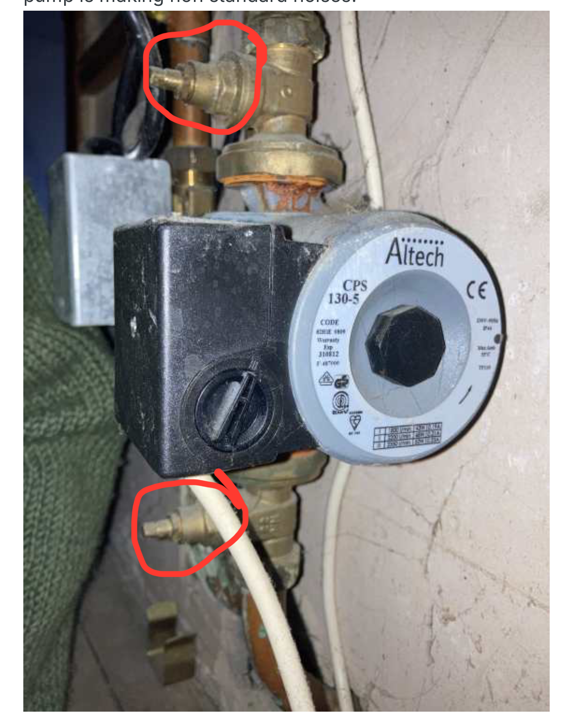

jfb Posted January 24 Posted January 24 Can anyone recommend a suitable pump replacement for this one? well, I’m assuming it’s the pump as the boiler is working but the heat never gets far from the boiler at all and the pump is making non standard noises!
Nickfromwales Posted January 24 Posted January 24 Gravity system with a heat only boiler? I'm less of a fan of Grundfos these days, and am steering towards Wilo more often. The 5 means 5m head, so most off the shelf standard circulators will do the job. This one may suit your needs and should be available locally LINK Hopefully the pump valves will hold well enough for a deft switch over, but expect them to not close fully.
John Carroll Posted January 24 Posted January 24 Open & shut the pump isolating valves 3 or 4 times, should then hold OK. I have a 6M Wilo Yonos Pico Pump, running fine and silent for the past 7 years. 1

jfb Posted January 24 Author Posted January 24 32 minutes ago, Nickfromwales said: Gravity system with a heat only boiler? Thanks for the quick response Nick. I’m not a plumbing expert but I think it’s a gravity system! The boiler does heating and feeds the hot water tank and there are a couple of tanks in the loft. im a bit worried about how well the isolators will work as I know there’s already an old isolator in the hot water cupboard that doesn’t turn! So im a little reluctant to have a go myself in case I can’t get the new one to fit properly. But it would be cheaper than getting someone in to do it!

Nickfromwales Posted January 25 Posted January 25 1 hour ago, marshian said: I think I'd do the job properly - drain system down and replace the valves at the same time as the pump but that's because I'd want to give the valves the best chance next time the pump needs replacing Yes, but what exactly is the point in fitting pump isolation valves, if you change them every time you change the pump? May as well just hard plumb the pumps at that stage. Worth seeing if they hold as it's a basement or summat by the look of it, so a few drops of water ain't gonna hurt, but the changeover will be a 30 min job.
marshian Posted January 25 Posted January 25 21 minutes ago, Nickfromwales said: Yes, but what exactly is the point in fitting pump isolation valves, if you change them every time you change the pump? May as well just hard plumb the pumps at that stage. Worth seeing if they hold as it's a basement or summat by the look of it, so a few drops of water ain't gonna hurt, but the changeover will be a 30 min job. I hear you but in my experience the pump valves have normally been in a heck of a lot longer than the current pump and are normally badgered Time before last when I replaced a pump the valves were badgered and I did it with the acceptance of some water leakage The next time I replace the pump I did pump and valves with a partial drain down - when that pump failed the valves held with the next pump replacement Caveat - I've been in this house since 1991 so it not like I've burnt thro pumps
Nickfromwales Posted January 25 Posted January 25 13 minutes ago, marshian said: I hear you Likewise, but these aren’t original-looking, old ass valves in the op. You know I’m like a dog with a bone so this one’s worth a bit of (maybe mis) adventure afaic. “What if they work?” 👀
marshian Posted January 25 Posted January 25 7 minutes ago, Nickfromwales said: Likewise, but these aren’t original-looking, old ass valves in the op. You know I’m like a dog with a bone so this one’s worth a bit of (maybe mis) adventure afaic. “What if they work?” 👀 Yeah but they look a bit leaky!!! Perhaps that's just me!!!
Nickfromwales Posted January 25 Posted January 25 Not the stems, just the pump nuts. Also, brass doesn’t rust so it’s the pump that’s corroding not the valves. Very likely the original pump has those nasty rigid washers, not the modern, more compliant rubber ones. Dog. Bone. 🤣 1

Onoff Posted January 26 Posted January 26 I'd give the pump threads and washer faces a good smear of Jet Blue Plus. Each to their own on goopy tub stuff but it's my goto. I use it mainly on compression fittings and find I don't need PTFE tape. The stuff stops that horrible brass squeak noise, let's you nip a bit tighter and fills any little voids, it's just wonderful. No more weepy joints here.
Nickfromwales Posted January 26 Posted January 26 6 hours ago, Onoff said: I'd give the pump threads and washer faces a good smear of Jet Blue Plus. Each to their own on goopy tub stuff but it's my goto. I use it mainly on compression fittings and find I don't need PTFE tape. The stuff stops that horrible brass squeak noise, let's you nip a bit tighter and fills any little voids, it's just wonderful. No more weepy joints here. Now I’m the complete opposite. Yes to putting something on the threads, but I always clean the mating faces and that allows the rubber to have friction. This otherwise, in the hands of someone not doing this day in day out, can lead to the rubber just being displaced and ending up in the centre of the fitting doing feck all. Threads yes, mating faces clean and dry for me.

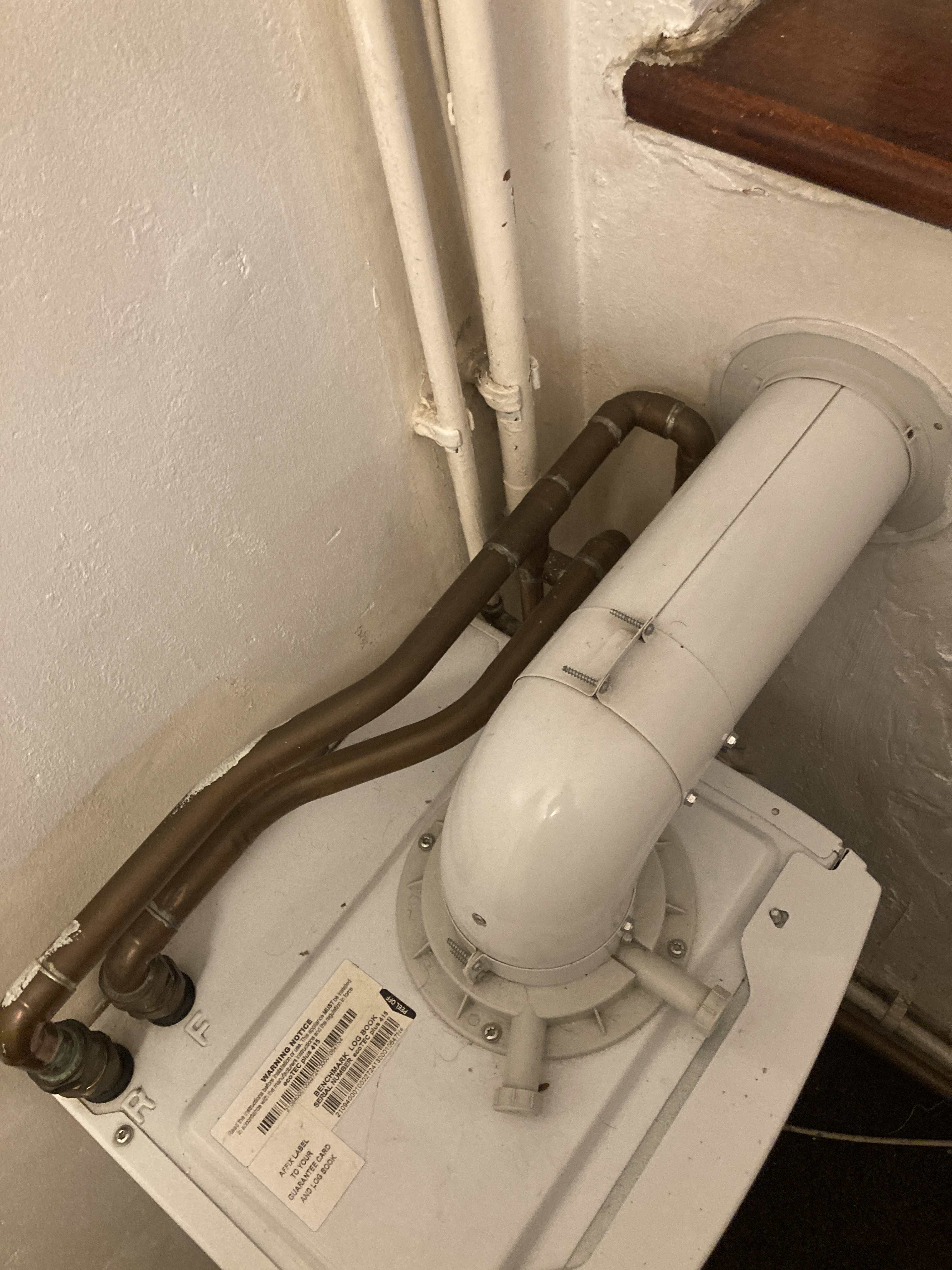

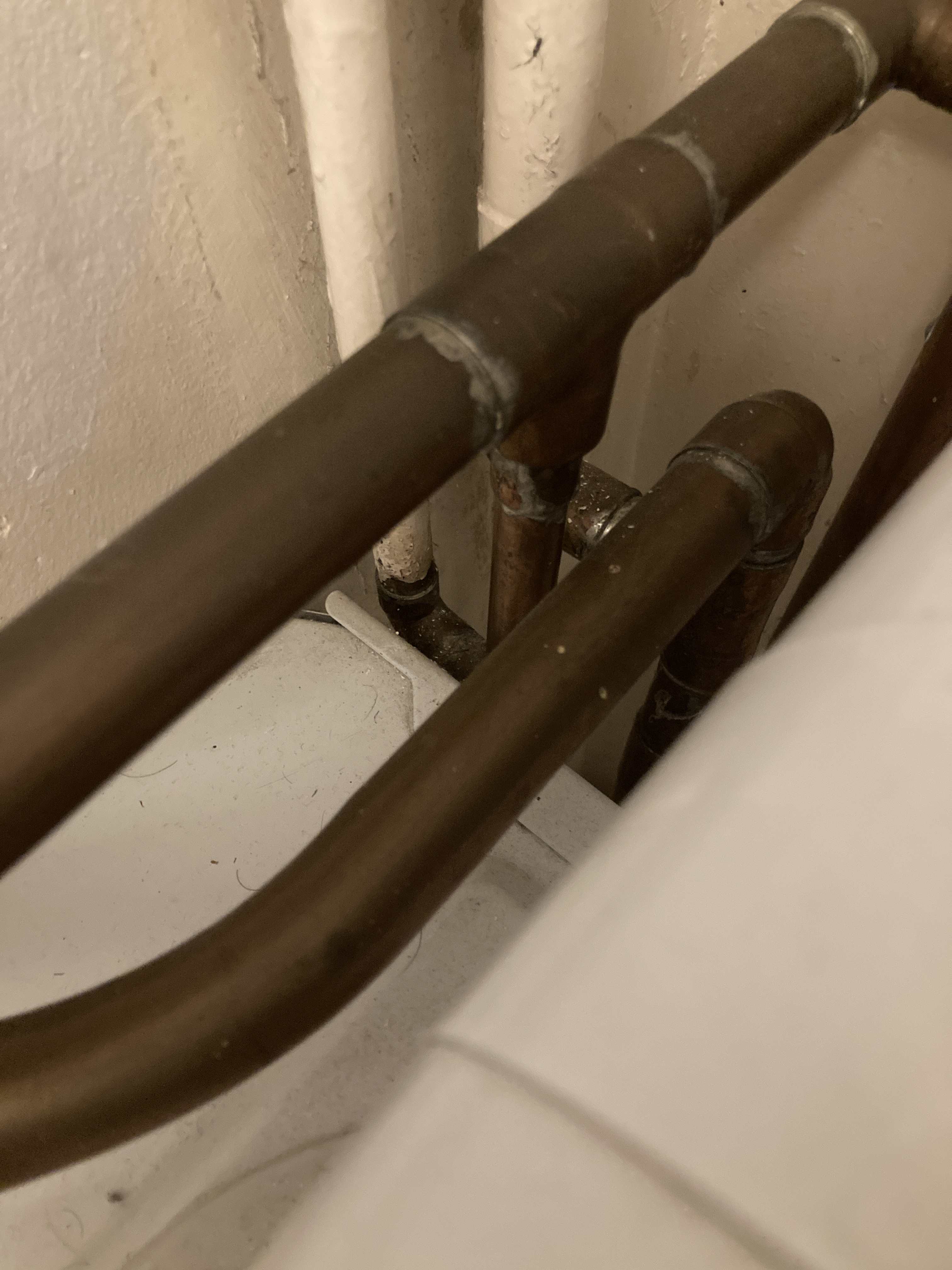

jfb Posted January 28 Author Posted January 28 Glad my pump woes are generating such a lively conversation! good news - managed to swap over the pump fine. No leaky isolators, all went well. Thanks chaps. bad news - similar problem, boiler fires up on demand and quickly gets too hot on flow pipe and my boiler (Vailant ecotec plus 415) comes up with F72 error (flow and/or return NTC fault). Ran the auto bleed function on the WILO for 15 minutes, tried with the circuit isolators (silver boxes - don’t know actual name!) manually opened, same result. Pump seems to be running fine just no flow from the boiler. Spoke to Vailant and their technical support said the F72 error meant the problem was external to the boiler. Spoke to plumber (too busy to come out but happy to do a video call while I was trying to get it working) and he said most likely an airlock or maybe sludge build up (though most of the rads were changed a few years back). Spoke to the gas safety check people (who came on Monday for the yearly checkup and reckoned it was most likely the pump) and they have suggested draining, changing a bit of pipe work (more below), filling with cleaner and circulating for a couple days, drain again and fill with inhibitor. the pipe work that they thought needed changing I presume is the ‘u’ section you can just make out in the pics (close up on second pic) on the return pipe work next to the boiler. He reckoned that was an airlock liability and I presume the plan would be to run a ‘t’ straight across to the main return pipe from the down pipe and getting rid of the ‘u’ does that sound like a reasonable plan? Pics in next post
marshian Posted January 28 Posted January 28 1 hour ago, jfb said: Glad my pump woes are generating such a lively conversation! good news - managed to swap over the pump fine. No leaky isolators, all went well. Thanks chaps. bad news - similar problem, boiler fires up on demand and quickly gets too hot on flow pipe and my boiler (Vailant ecotec plus 415) comes up with F72 error (flow and/or return NTC fault). Ran the auto bleed function on the WILO for 15 minutes, tried with the circuit isolators (silver boxes - don’t know actual name!) manually opened, same result. Pump seems to be running fine just no flow from the boiler. Spoke to Vailant and their technical support said the F72 error meant the problem was external to the boiler. Spoke to plumber (too busy to come out but happy to do a video call while I was trying to get it working) and he said most likely an airlock or maybe sludge build up (though most of the rads were changed a few years back). Spoke to the gas safety check people (who came on Monday for the yearly checkup and reckoned it was most likely the pump) and they have suggested draining, changing a bit of pipe work (more below), filling with cleaner and circulating for a couple days, drain again and fill with inhibitor. the pipe work that they thought needed changing I presume is the ‘u’ section you can just make out in the pics (close up on second pic) on the return pipe work next to the boiler. He reckoned that was an airlock liability and I presume the plan would be to run a ‘t’ straight across to the main return pipe from the down pipe and getting rid of the ‘u’ does that sound like a reasonable plan? Pics in next post I'll get shot for suggesting this but.................... 1. You did open the isolation valves up after fitting the pump? 2. You did bleed the pump after fitting (centre screw loosen it to allow the air out - they don't pump air at all well 3. Are you sure the isolation valves actually opened I'll get me coat
Nickfromwales Posted January 28 Posted January 28 1 hour ago, marshian said: I'll get shot for suggesting this but.................... 1. You did open the isolation valves up after fitting the pump? 2. You did bleed the pump after fitting (centre screw loosen it to allow the air out - they don't pump air at all well 3. Are you sure the isolation valves actually opened I'll get me coat You'd be shot if you didn't, ma' man.... 2 hours ago, jfb said: they have suggested draining, changing a bit of pipe work How long has this worked for, to date, without issue?
jfb Posted January 28 Author Posted January 28 1 hour ago, marshian said: I'll get shot for suggesting this but.................... 1. You did open the isolation valves up after fitting the pump? 2. You did bleed the pump after fitting (centre screw loosen it to allow the air out - they don't pump air at all well 3. Are you sure the isolation valves actually opened 1.Yes I did open them. 2. auto bleed button pressed and on for a while 3. Well, I’m not sure how to answer that so I guess no. I didn’t test that when I had the pump off, maybe I should have. But the isolators seemed to twist shut and open nicely.
