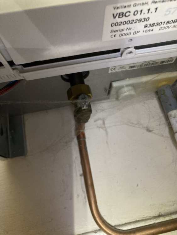

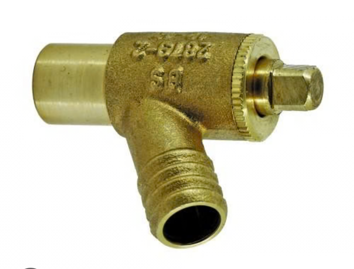

Most boilers have a drains off point at the underside of the boiler. Not all, but the majority.
You can connect a hose to this, poke the other end down a drain, and open the drain off to pull water and air down / through / out of the hose.
You do this with the system on and running btw.

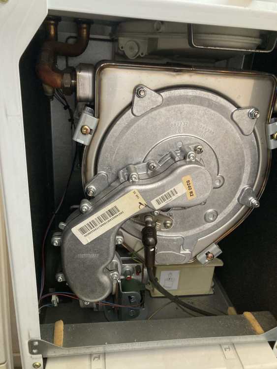

Can you have a look for a drain on the boiler? Dont mistakenly open the combustion chamber looking for it though(!) just look under it or take the white metal case off at most. If you don’t see it then, you don’t have one.
There is very little pipe work to see. Gas enters from the bottoms and flow and return on top.

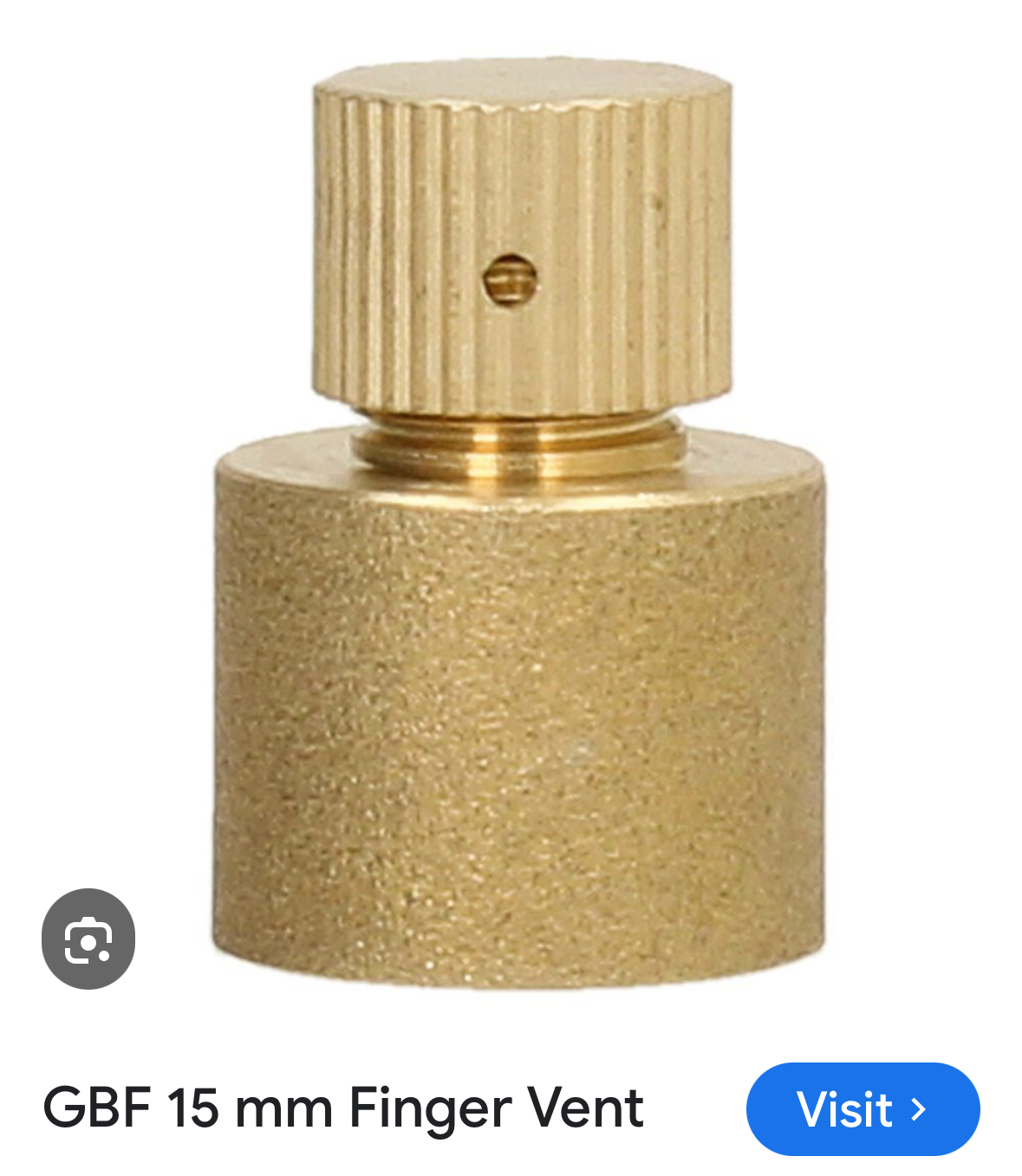

On 29/01/2026 at 14:20, Nickfromwales said:
There should be at least a manual air bleed then? How hard have you hunted for one?
So……….
i managed to find this little beauty!
Im wondering if that is an auto vent (that maybe ceased on the auto bit).
opened it and there was gurgling and eventually water came out.
fired up the boiler and it got going, much gurgling, but didn’t stop straight away like it had. But would go into anti cycling mode, but not turn off and get going again after it had cooled down again. Eventually some low heat to radiators, but not smooth.
went up to the vent again to open and see if it would let air out (a little came out).
trying hot water now and it is consistently working at a high temperature so that’s good!
if I continue to struggle to get the hot water working properly am I right to think that going back to open the vent is a good idea to try and get rid of any more air?
and is it likely an auto vent that has ceased to auto vent and that I could replace it with a functioning auto vent?

Cant really say from the pic, but if you’re getting movement then it was defo air locked.
Happy days.
15 hours ago, Nickfromwales said:
Happy days.
Yes indeed.
