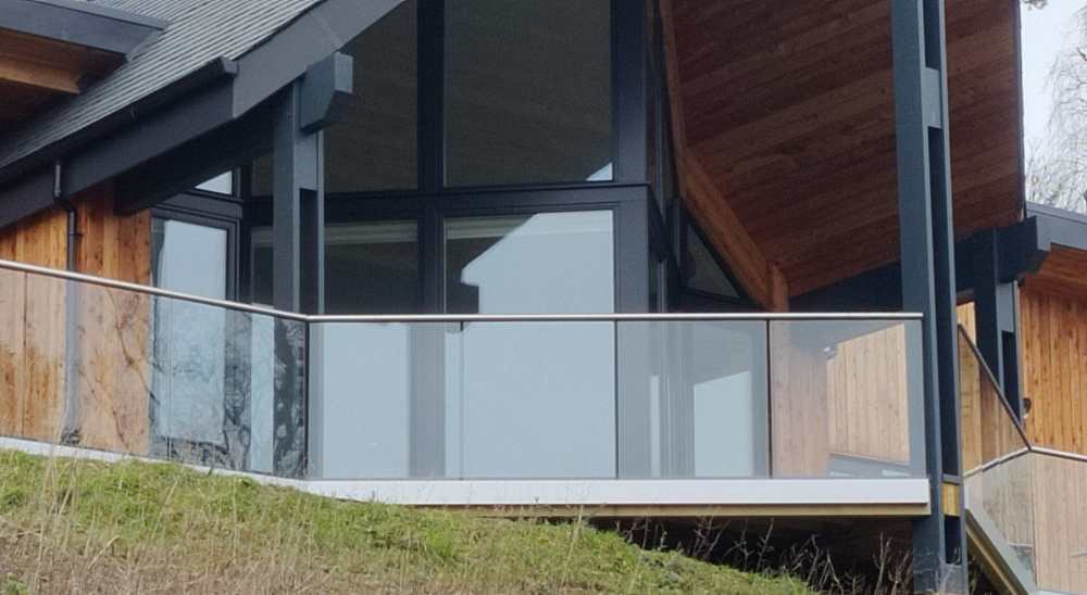

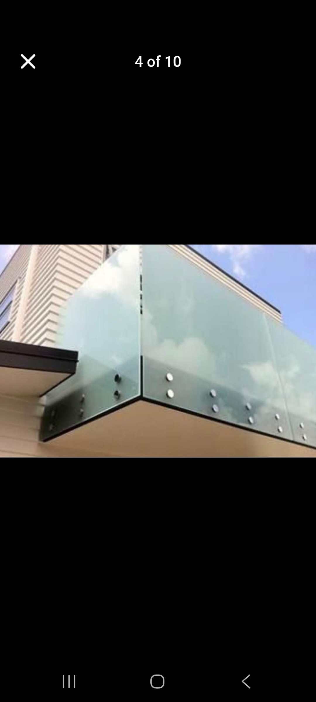

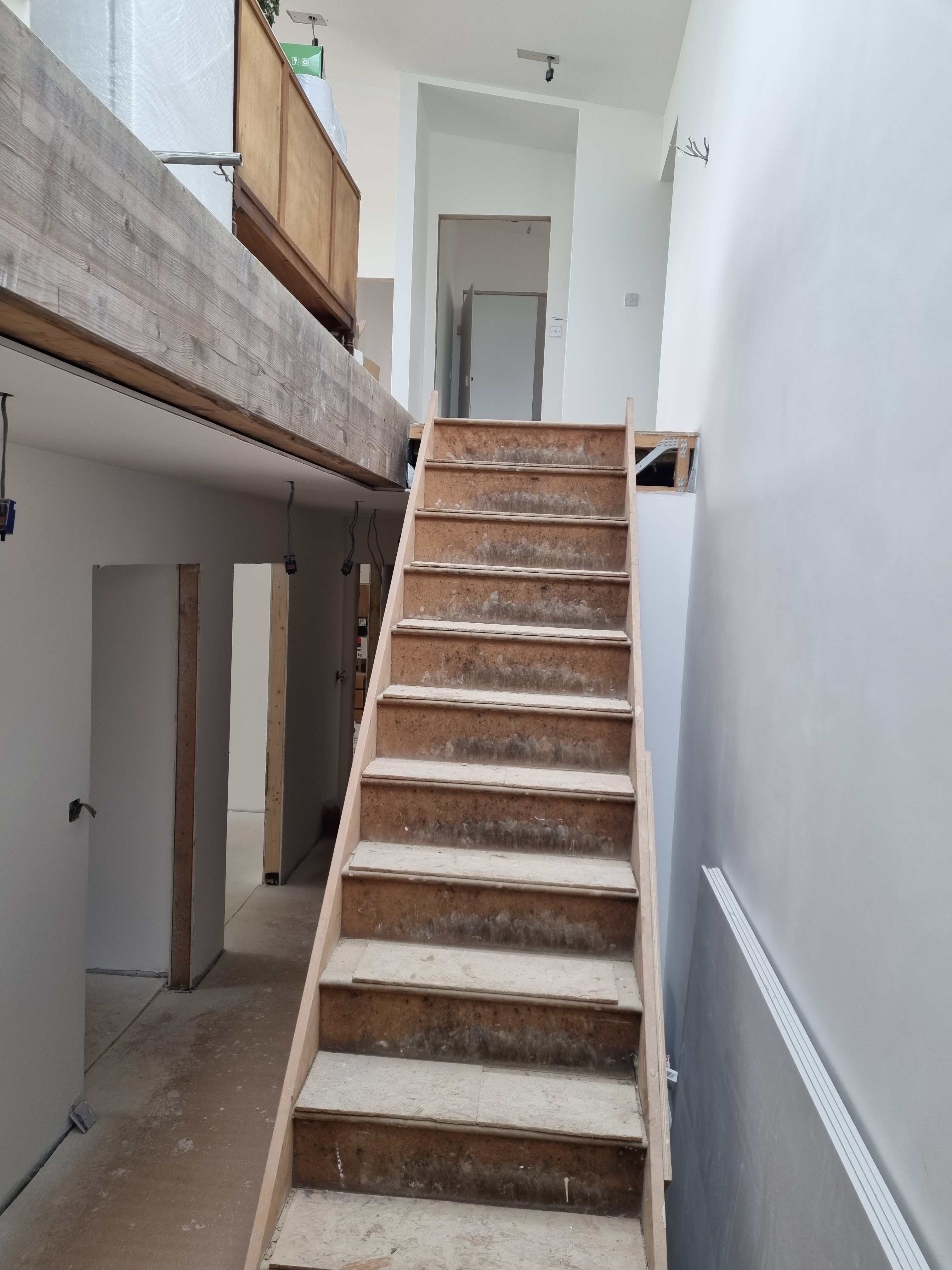

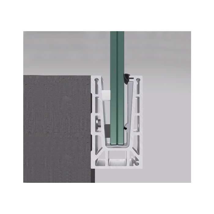

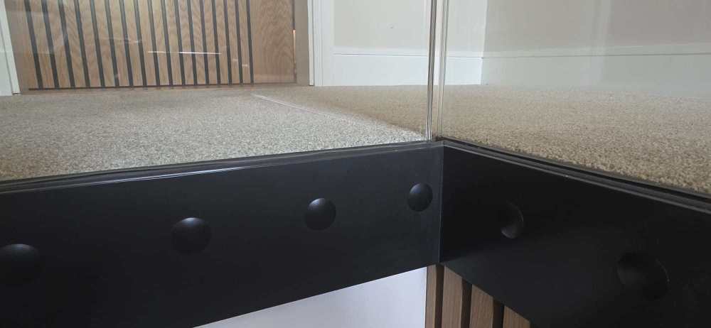

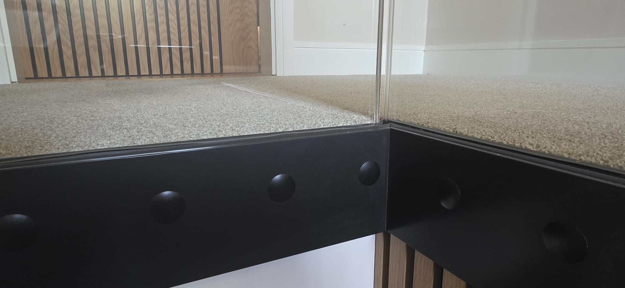

January 24Jan 24 Hello all. The final stairs are in place and we need a balustrade along the Glulam beam in the picture below. For reference it is 360mm deep by 142mm wide. Our preference is for a glass balustrade possibly with a hand rail on top. We have two options for fixing - either point fixing to the side face (example in second picture for reference only), or a rail fixing on the top of the beam (example in third picture for reference only). I know there are also side fixed rail systems as well but they will not meet the desired/required "look". I know the main issue is going to be fixing (bolts/screws) into the glulam beam. You can see we have clear access to top and bottom of the beam, but would have to disturb the plasterboard (yes, already painted!) to get access to both sides of the beam, which I'm prepared to do if necessary. What would be your approach (top rail or point fixing) and what fixing would you recommend? One "outside the box" idea I had was a routed groove in the top of the beam and using relevant rubber seals (as would be used in a rail fixing) fit the glass into the routed groove. Anyone care to comment on this idea.
January 24Jan 24 18 minutes ago, BotusBuild said: One "outside the box" idea I had was a routed groove in the top of the beam and using relevant rubber seals (as would be used in a rail fixing) fit the glass into the routed groove. Anyone care to comment on this idea. BCO may not sign you off with a DIY solution. Plus, you’d be interfering with the structural integrity of the beam, so would need prior approval from both SE and BCO. I like both other options, so as ever this is down to the decision maker in the house 👀.
January 24Jan 24 Author Never thought it would work to be honest, just one of those "brain not doing enough so fill it with craziness" moments 🙂 OK folks, so its down to recommended fixings to use for each of the proper two options.

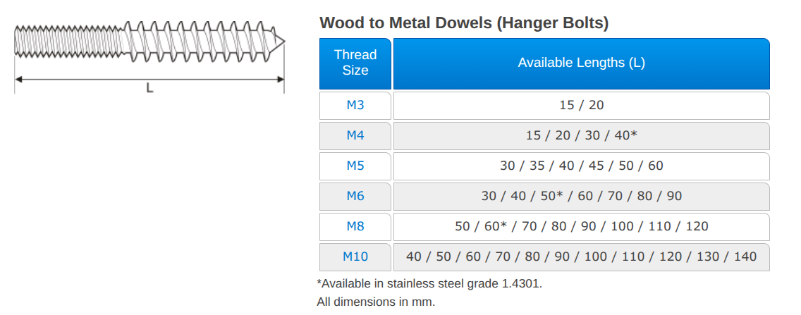

January 25Jan 25 On 24/01/2026 at 14:24, BotusBuild said: These? (the M10 version) Should be plenty beefy enough. Just need to have these in reasonably high frequency if the glass is to be leant against / accident / misadventure etc.

February 5Feb 5 How do you know that the fixings and the beam will pass the 25mm deflection test at 0.36kn/metre at 1100mm? I assume this needs a calc from an engineer or the beam to be specced for this purpose?

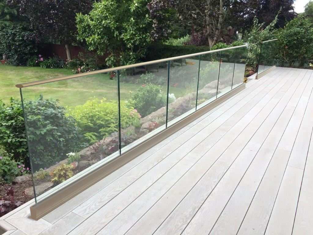

February 5Feb 5 I bought mine from here https://www.made2measure.co.uk/glass-balustrades/?mh_keyword=balcony glazing system&gad_source=1&gad_campaignid=12052583245&gbraid=0AAAAADv1etNOPVsB6l6fBCLWEMa72dGOx&gclid=Cj0KCQiAnJHMBhDAARIsABr7b844WI-m1FTO32K-Blto5enxEUMAp2YkU1fodvh8LLpF7khwS1hhwYMaAhGSEALw_wcB Go to the useful information section, all the design certification is there, with approved mounting schemes for the various products etc. Just bought the appropriate hardware, downloaded the certificate and structural engineer signed it all off. Zero thought, fully approved, simple.
February 5Feb 5 This manufacturer has guidance for fixing their channels in various conditions https://posiglaze.co.uk/
February 5Feb 5 Author 32 minutes ago, Stratman said: This manufacturer has guidance for fixing their channels in various conditions https://posiglaze.co.uk/ Certification/Accreditation only mentions concrete and steel. I have messaged them about fixing to the glulam beam.
February 5Feb 5 Author Happy Days. Made2Measure (link in JohnMo's message above) has wood connection certification with M8/80mm long at 200mm spacing (400mm with no wind loading) using Fisher FPF-WT YZP (https://www.fischer.co.uk/en-gb/products/screws/wood-construction-screw-powerfast/powerfast-fpf-wt-zpp)

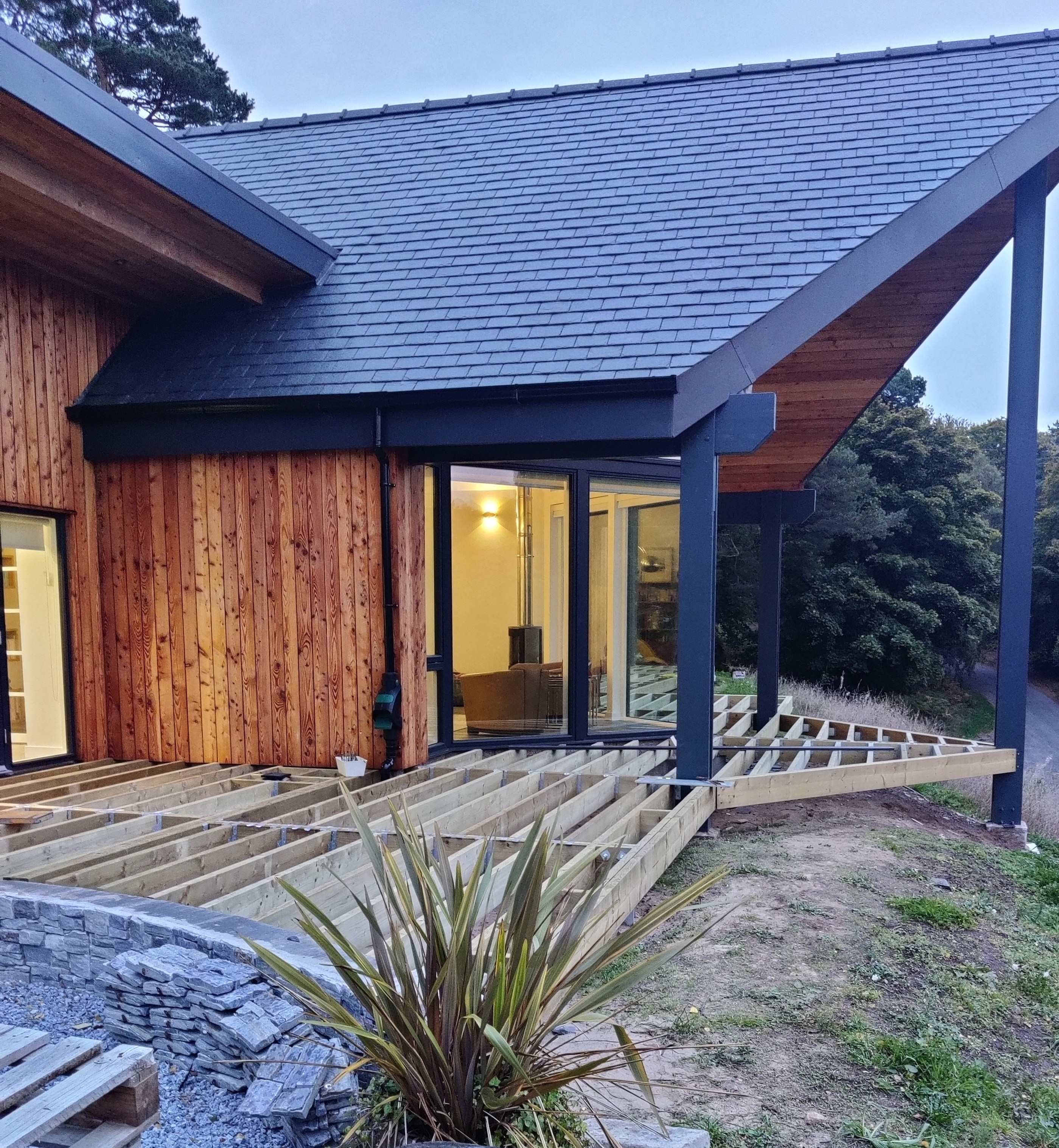

February 5Feb 5 Mine was outside in a high wind load area, plus a massive drop in areas. Face mounted on timber structure.
February 6Feb 6 22 hours ago, lookseehear said: How do you know that the fixings and the beam will pass the 25mm deflection test at 0.36kn/metre at 1100mm? I assume this needs a calc from an engineer or the beam to be specced for this purpose? All BCO’s I’ve ever seen just give it a poke / push and smile, possibly just wind, and move on to the next item. Glaziers were more concerned about size (length) of the glass, thickness etc and wanted lots of info before they’d even let me place the order! Good guys, and very conscientious tbf.
February 6Feb 6 Author 13 hours ago, JohnMo said: Face mounted on timber structure. Nuts and bolts and big washers behind the wood?
February 6Feb 6 Just now, BotusBuild said: Nuts and bolts and big washers behind the wood? Our edge trim is two layers of 10x2 timber, so I just used M10 x 75mm hex drive flanged coach screws. Used an impact driver to drive them in.

July 30Jul 30 On 05/02/2026 at 22:36, JohnMo said: Mine was outside in a high wind load area, plus a massive drop in areas. Face mounted on timber structure. Looks great. Is there no concern that conventional timber will move as it dries and transfer stress to the glass panels? O don't suppose that's an issue with Glulams though.
July 30Jul 30 7 minutes ago, MortarThePoint said: timber will move as it dries and transfer stress to the glass panels? The glass sits in a robust aluminium channel, the channel is bolted to the wood. So glass and wood are completely isolated from each other.
July 30Jul 30 1 minute ago, JohnMo said: The glass sits in a robust aluminium channel, the channel is bolted to the wood. So glass and wood are completely isolated from each other. I see, I thought the aluminium was a trim over the glass which was bolted directly to the timber.

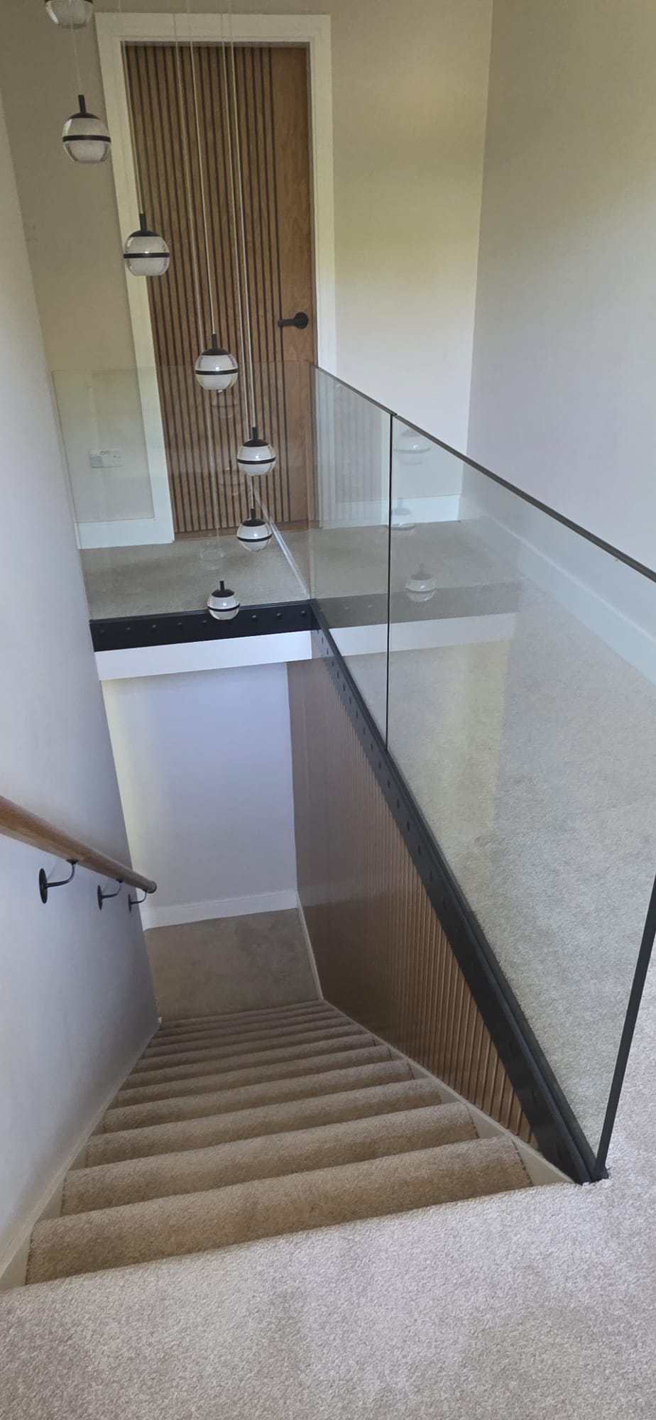

July 31Jul 31 You haven't said what your floor surfaces are upstairs. If you go for the surface-mounted spigots then you will have to consider how to "end" your surface covering, whether carpet or boarding etc right above your glulam. I went for a surface-mounted option per JohnMo's suggestion and I can heartily recommed FH Brundle and their product offering (pics below) - the pricing was incredibly keen Link here: https://www.fhbrundle.co.uk/products/18SB19B__Includes_19mm_Glass?campaign=506233955&content=&keyword=&hsa_acc=1133268878&hsa_cam=506233955&hsa_grp=1271037173114202&hsa_ad=&hsa_src=s&hsa_tgt=pla-4583039411608752&hsa_kw=&hsa_mt=e&hsa_net=adwords&hsa_ver=3&msclkid=ec2a85bb0fc1131b4c0fefd760f900b2 Regards Tet
July 31Jul 31 Author The glulam beam sits proud of the finished floor, as an architectural feature. The channel will sit directly on the glulam beam.
September 17Sep 17 Author After a frustrating time getting damaged deliveries of channels, I scrapped using a recommended supplier from this here hub and found a new supplier closer to home where a perfectionist could collect and transport the good themselves. Also, the top rail came in one piece (5750mm cut to length) which was an interesting 27 mile drive on top of a Volvo V50. But we have started... First piece not quite vertical as two wedges missing from kit. Being posted out to arrive over weekend Edited September 17Sep 17 by BotusBuild
