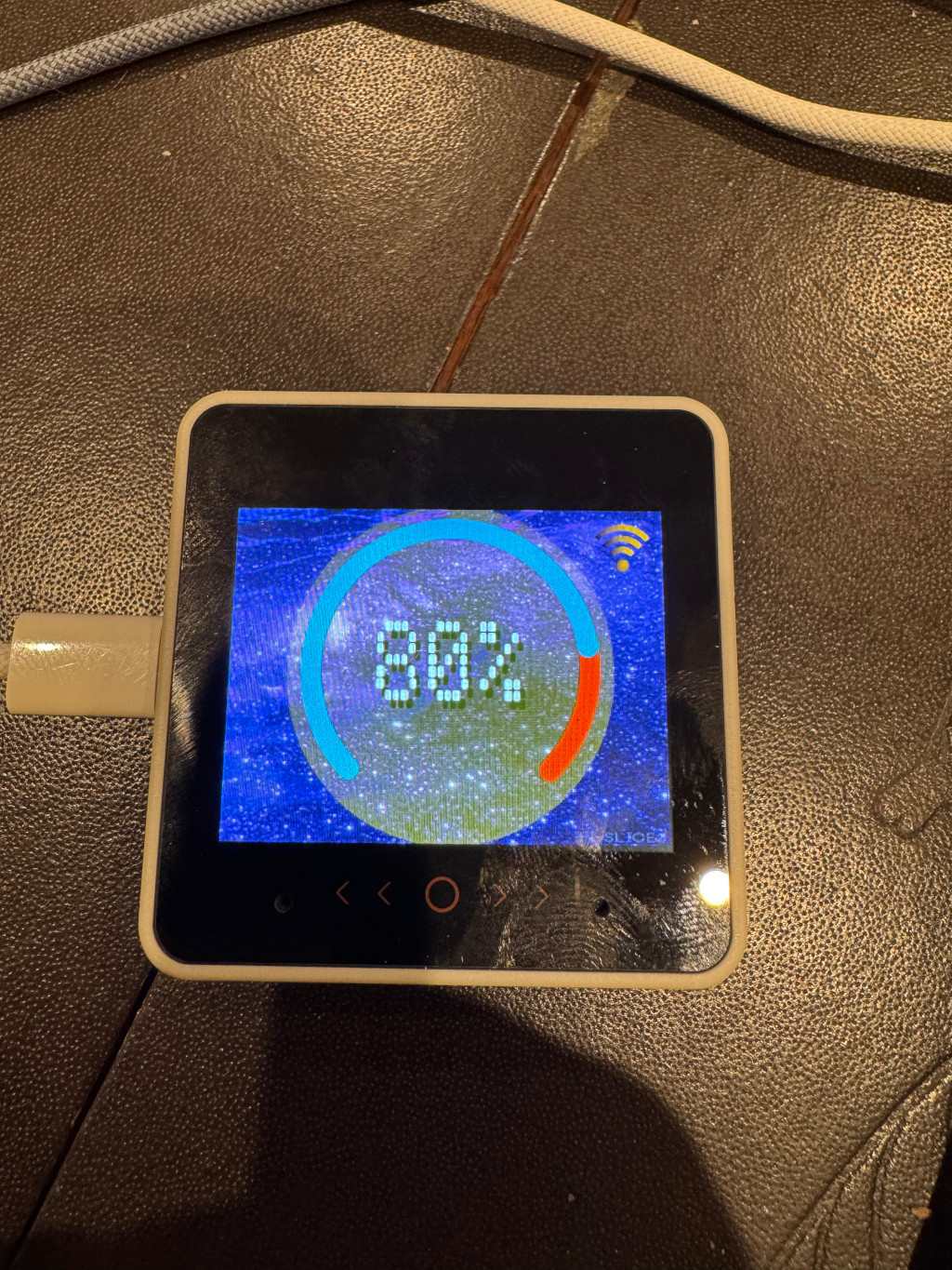

So first screen is the % of water in the barrel ( this it gets via HA from a standard esp32 with a ultrasonic transducer and mqtt)
Backdrop is animating .
Wifi symbol to show if connected or not.

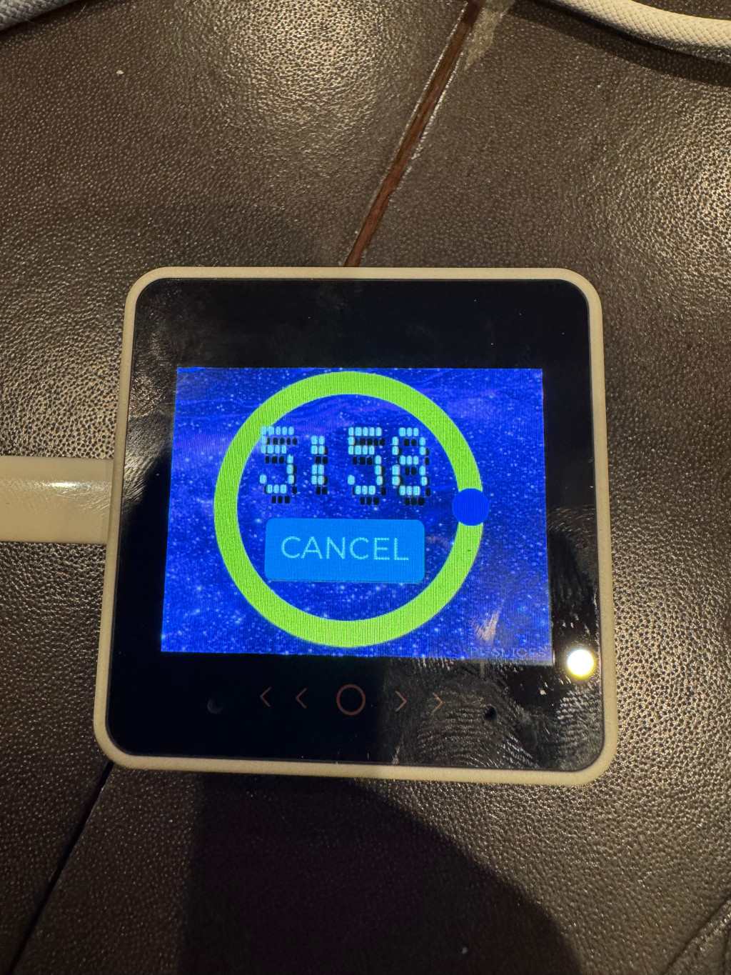

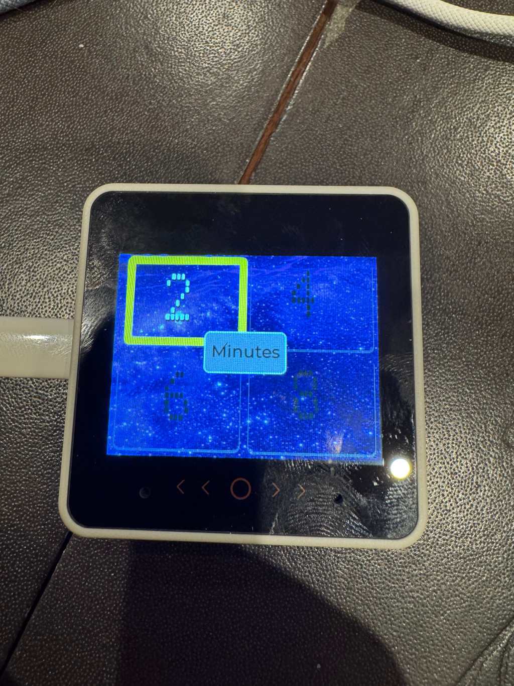

2nd screen choose minutes 2/4/6/8 ( some graphics to finish )
Plays a pcm audio e.g. "2 minutes selected"
3rd screen
Timer countdown.
Uses mqtt to tell HA to turn on the shelly outdoor wifi switch to the pump

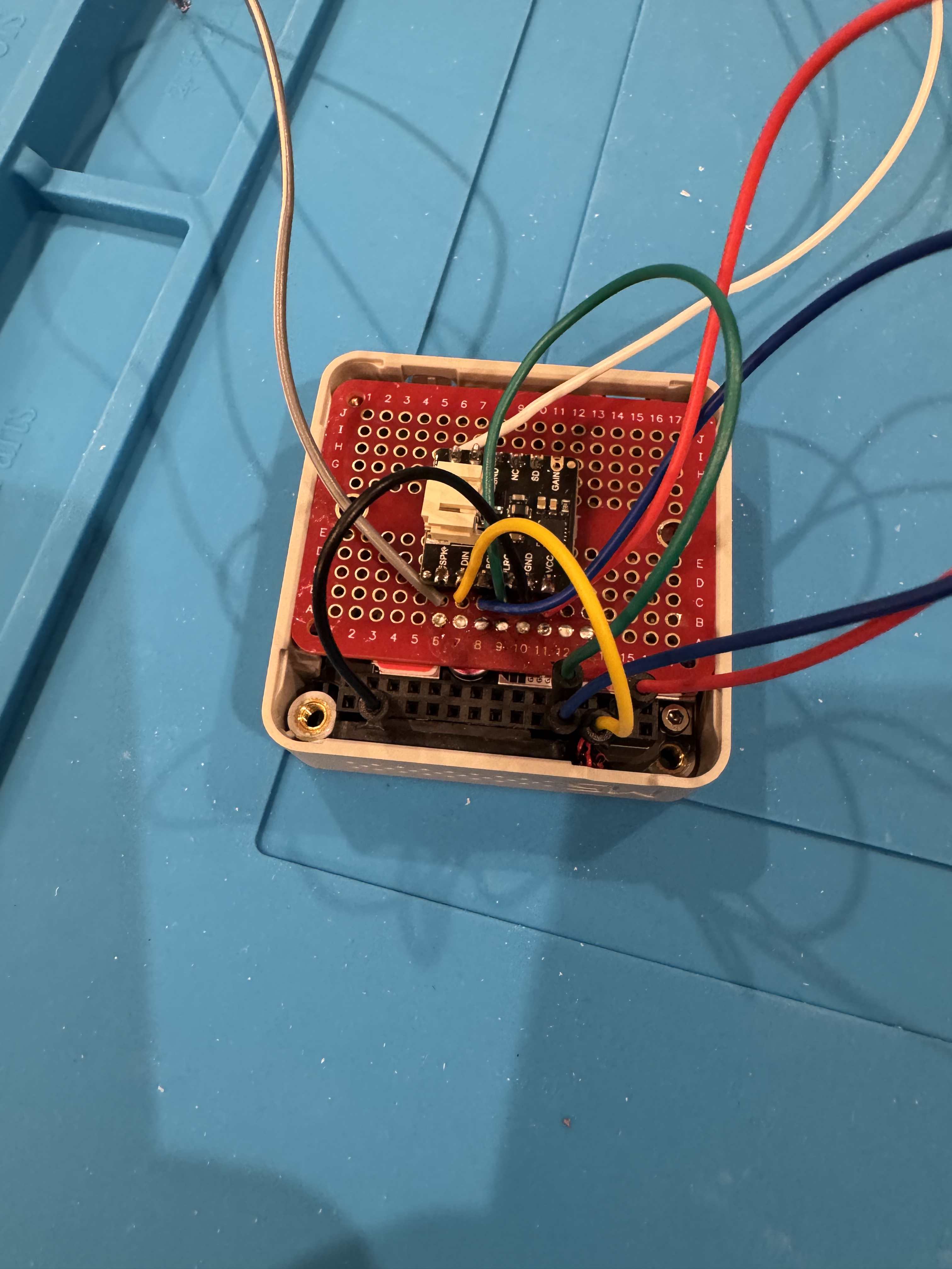

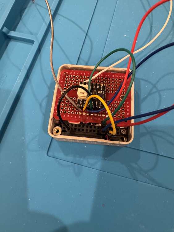

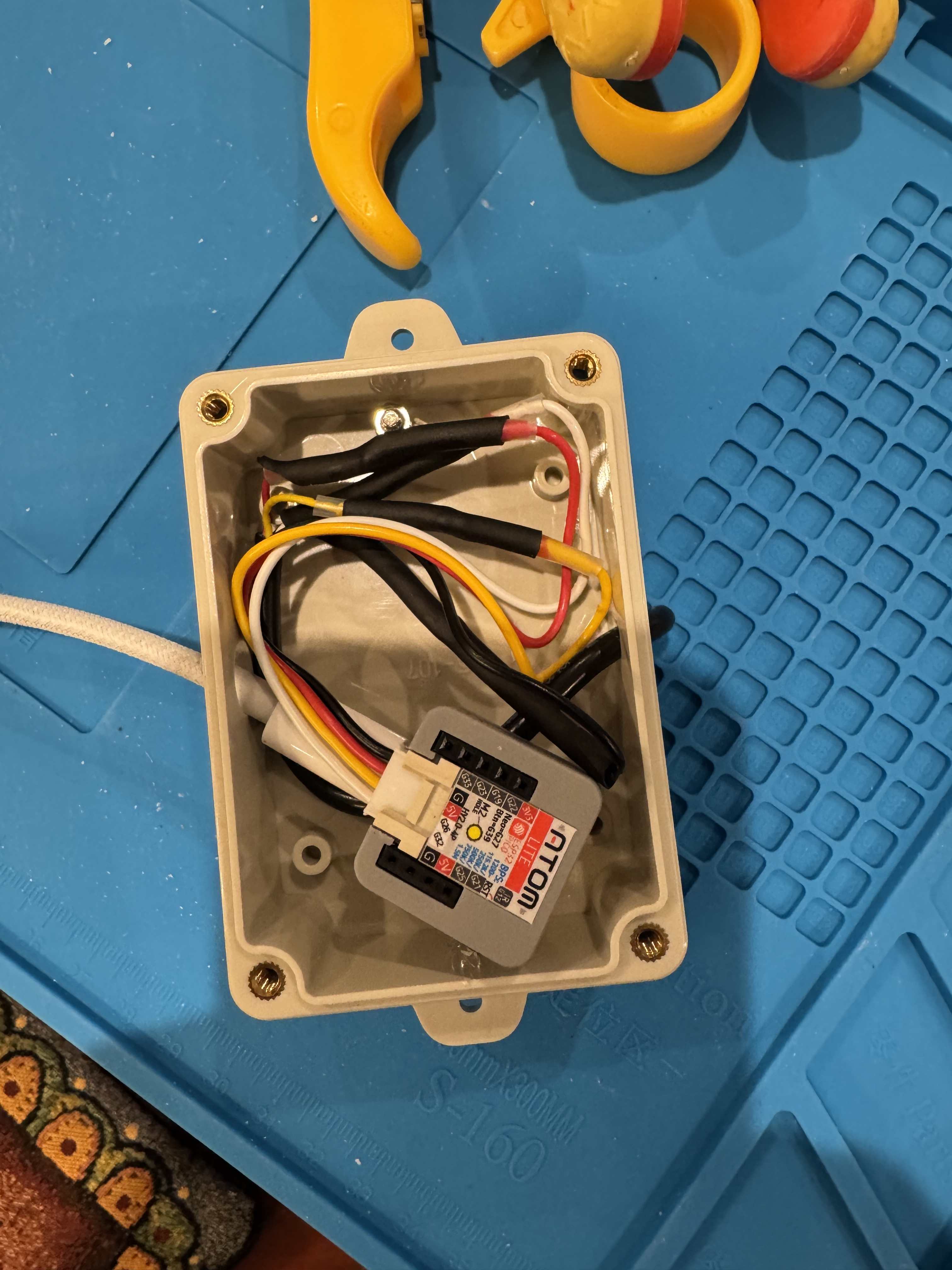

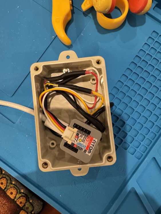

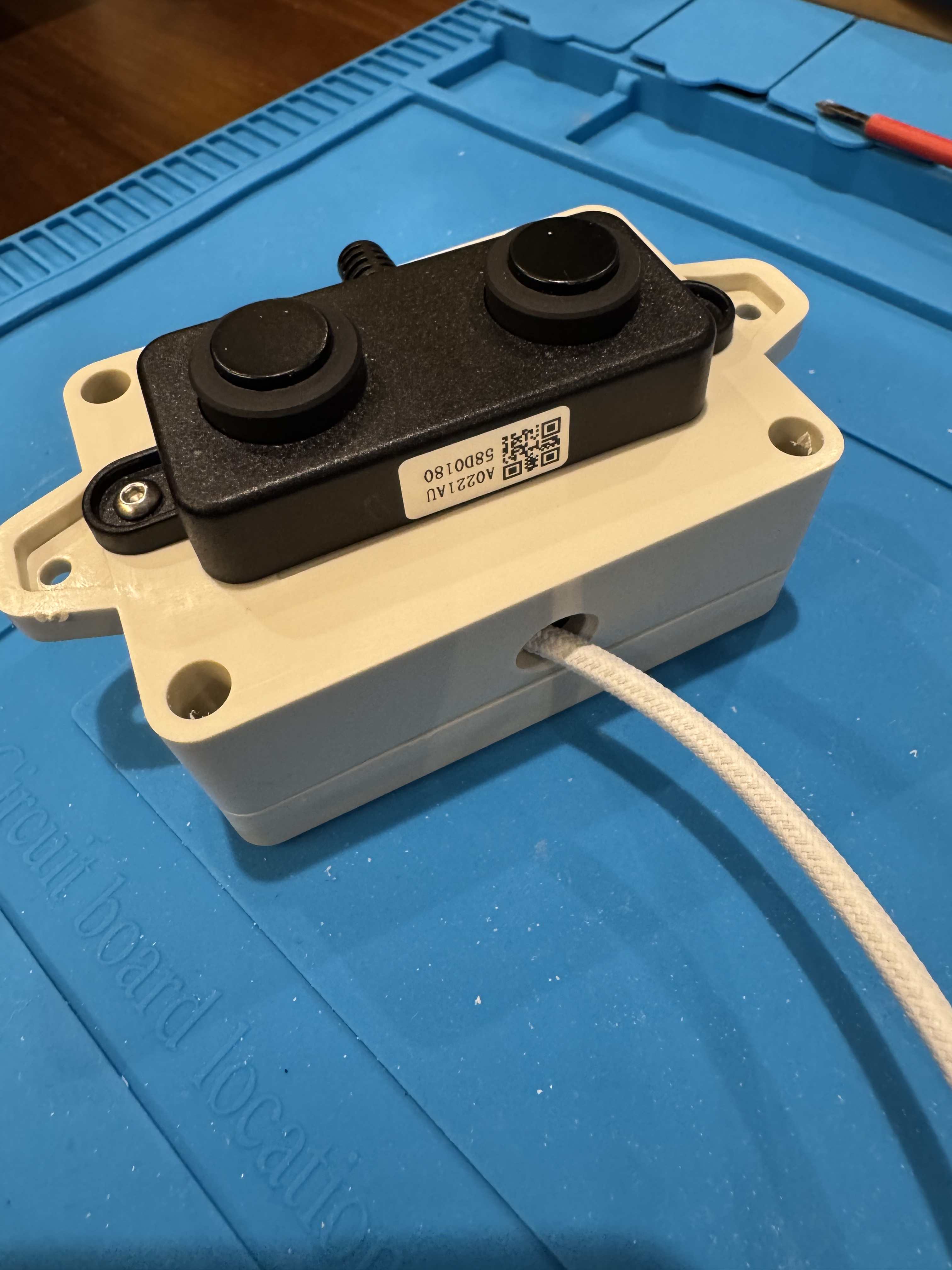

Swapped to an esp32 lite atom . So small .
Attached ultrasonic transducer - all seems good . The 2 holes ; ultrasonic lead and usb psu . Couldn’t find grommet connectors for usb lead where it fits through and they tighten for a waterproof connection . So just pumped both holes with ct1 😉
Discoverd these ‘ things ‘ you slide over a wire . Twist two wires together , move the sleeve and heat ! . Soldered joint and heat shrink in one ! I then heat shrank ontop .
Tomorrow once ct1 is dry will do a test deploy outside I.e fix to a wooden batton and put it across water barrel opening .

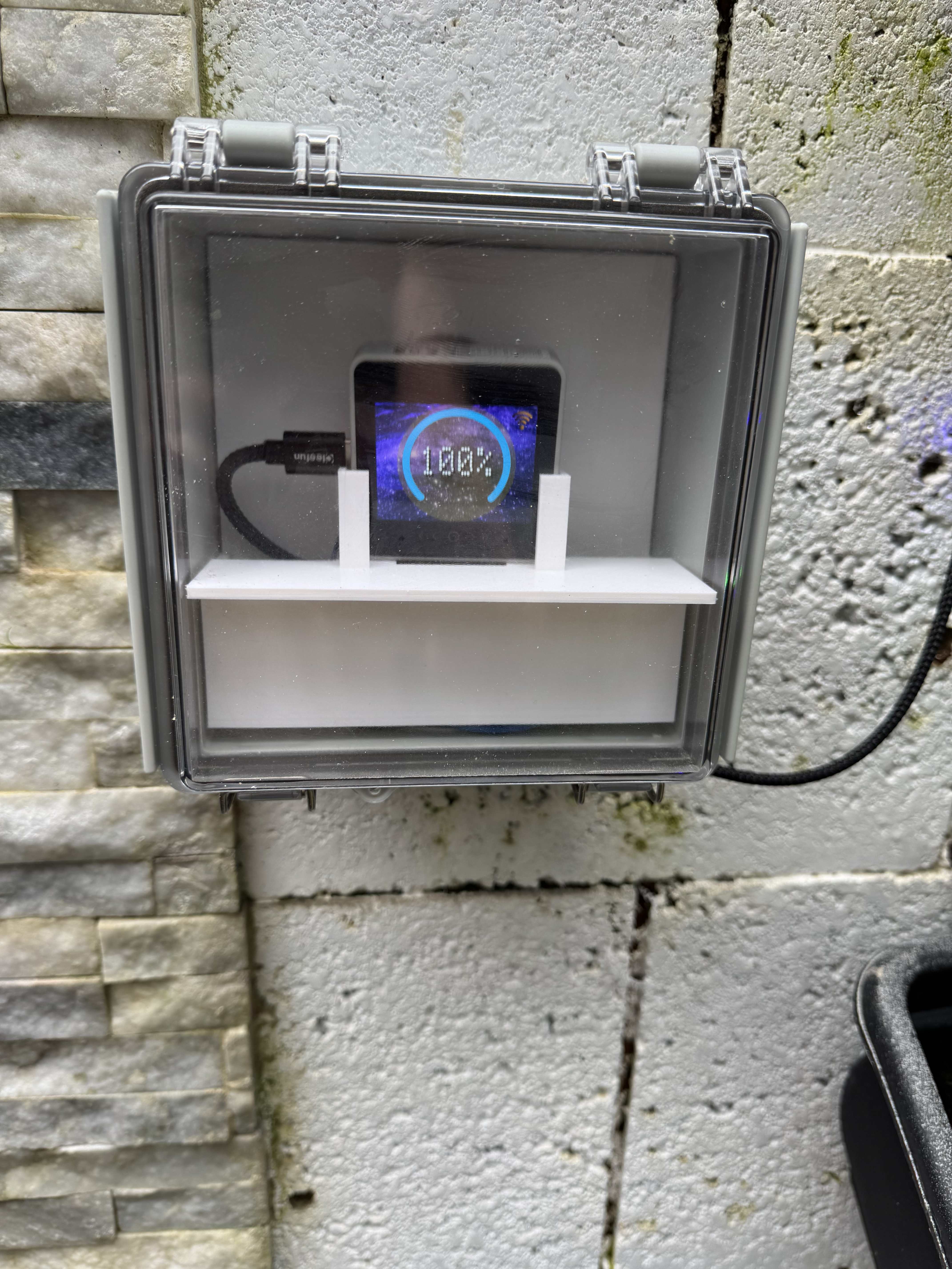

Deployed !
Loads of issues with the 3d printed case . I’ll rethink that .
Is that a 3D printed transparent cover on the box? I didn't know you could print clear plastic.
No . The box is bought. The internal white support thing to house cores3 , speaker , amp etc - needs redesigning

(expletive deleted)ing depth sensor ! It’s shite ! Or at least the beam is so wide it’s useless in a water barrel

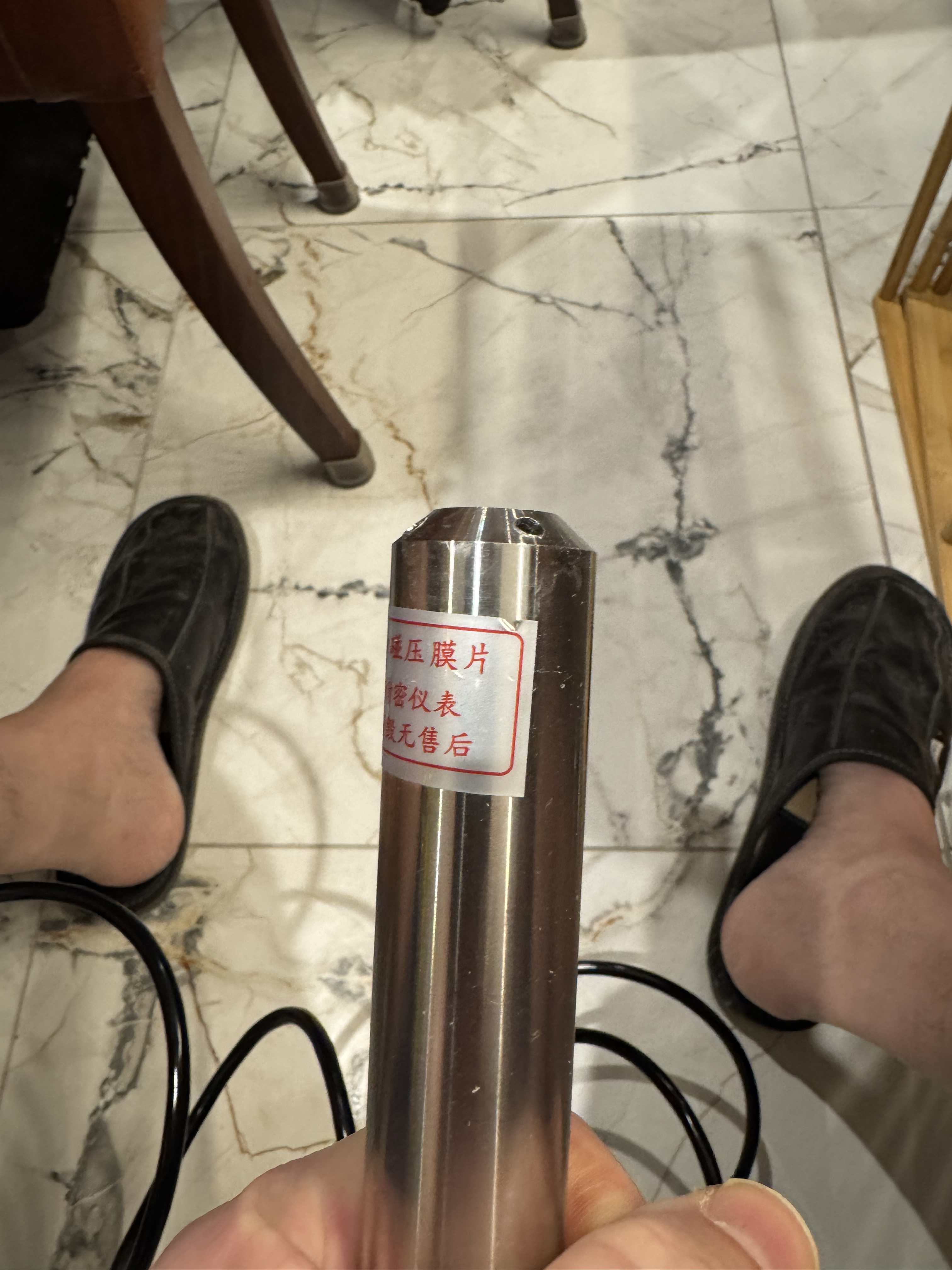

code not an issue with ChatGPT but the supplied analog to digital converter that came with the probe is shite . Completely non stable readings even when not in water !
Quick chat with my best mate and we ordered a different one . With current code worked instantly.
The percentage water remaining seems incorrect ( though the calcs were based off the tank height ) . Rather than bring in and reflash ( didn’t add OTT updates ) - might just frig the number by a multiplier to scale it better in home assistant .Doesn’t need to be especially accurate but reasonable .
