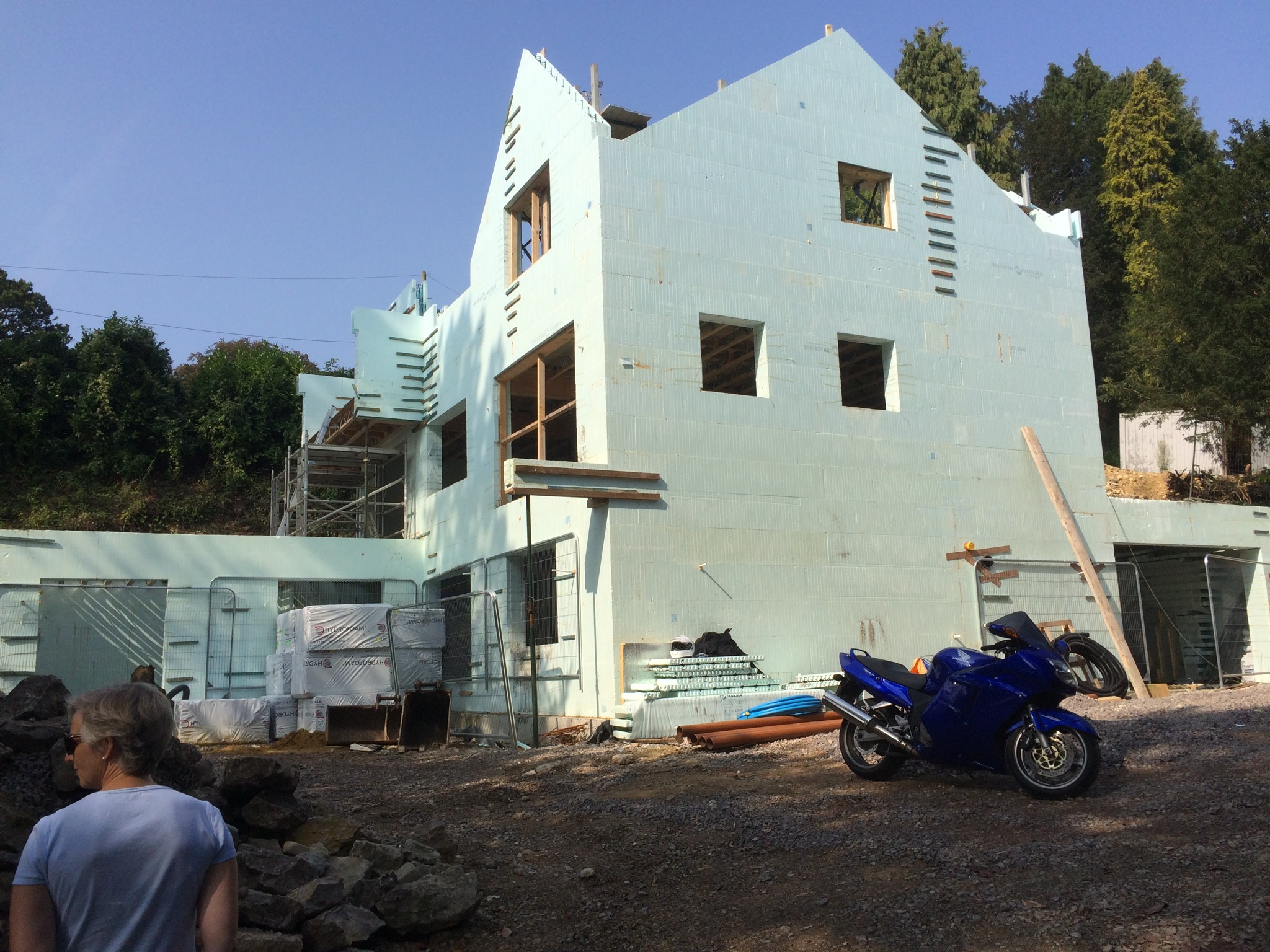

We lived in our ICF house for 7 years - when I measured the gas bill it was £365 per year, in other words £1 per day. You start saying it is not worth insulating any more than that. It's a good system and living inside so much thermal mass is beneficial.
Our builder had to go on a training course, and with oversight from the supplier all went well. image.thumb.png.ce0bf67e4d9c5cc68c17038d961e4e82.png
