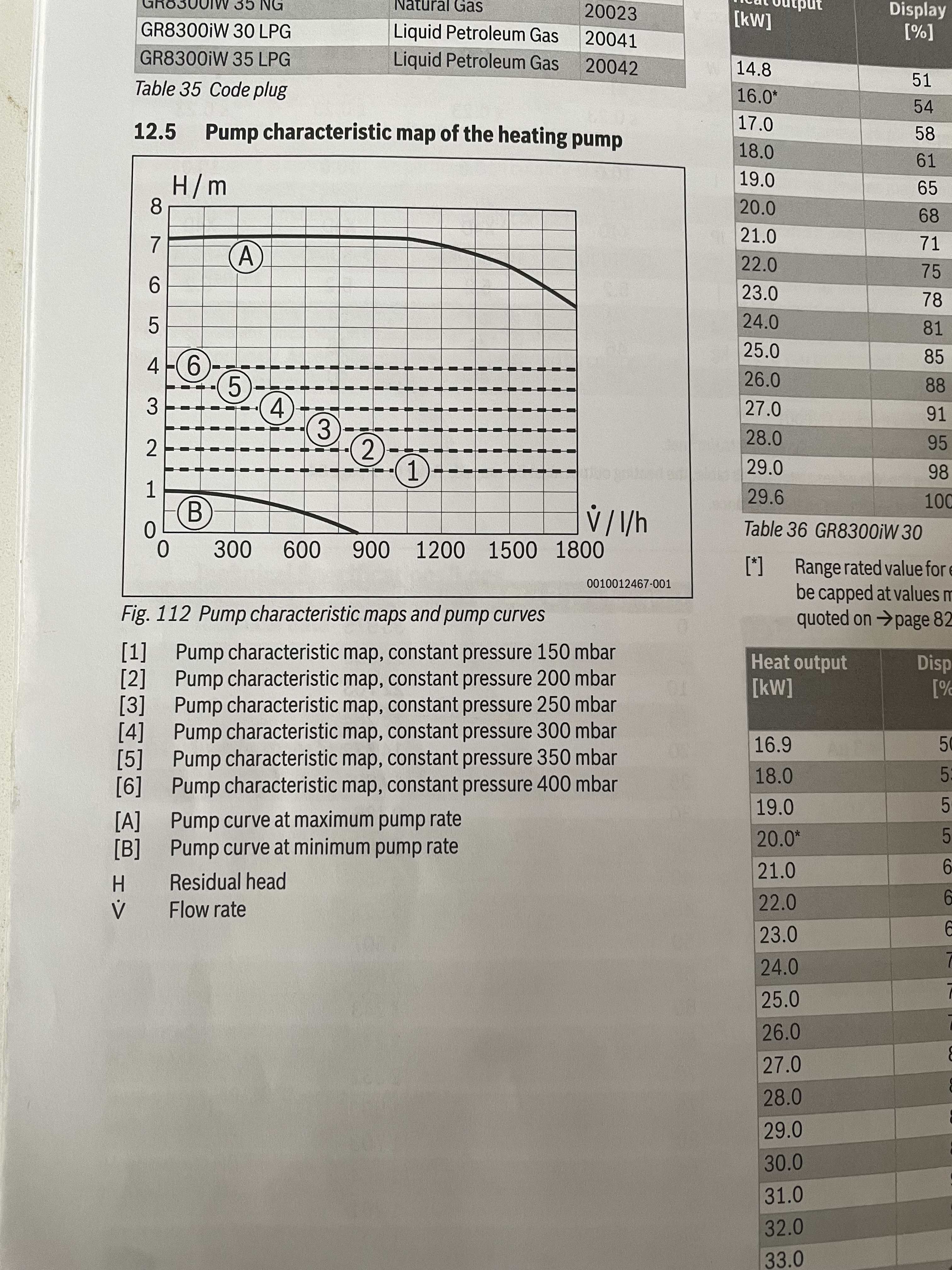

EinTopaz Posted 11 hours ago Author Posted 11 hours ago (edited) 2 hours ago, JohnMo said: So that is just the restart hysterisis. Doesn't the lower pump speed, just drive a lower output of the radiators, and then drive shorter boiler cycles, as there is less to take the boiler heat away? id have thought so. But looking at the data I logged side by side with the previous test. It reached target temp around about the same time. All rads felt hot. The only difference was the dt was mostly around 25 rather than 20 in the test previous. Whether that’s better or worse. I couldn’t say. edit: previous test was pump setting 6 at 400mbar, this test was pump setting 4 at 300mbar Edited 11 hours ago by EinTopaz
