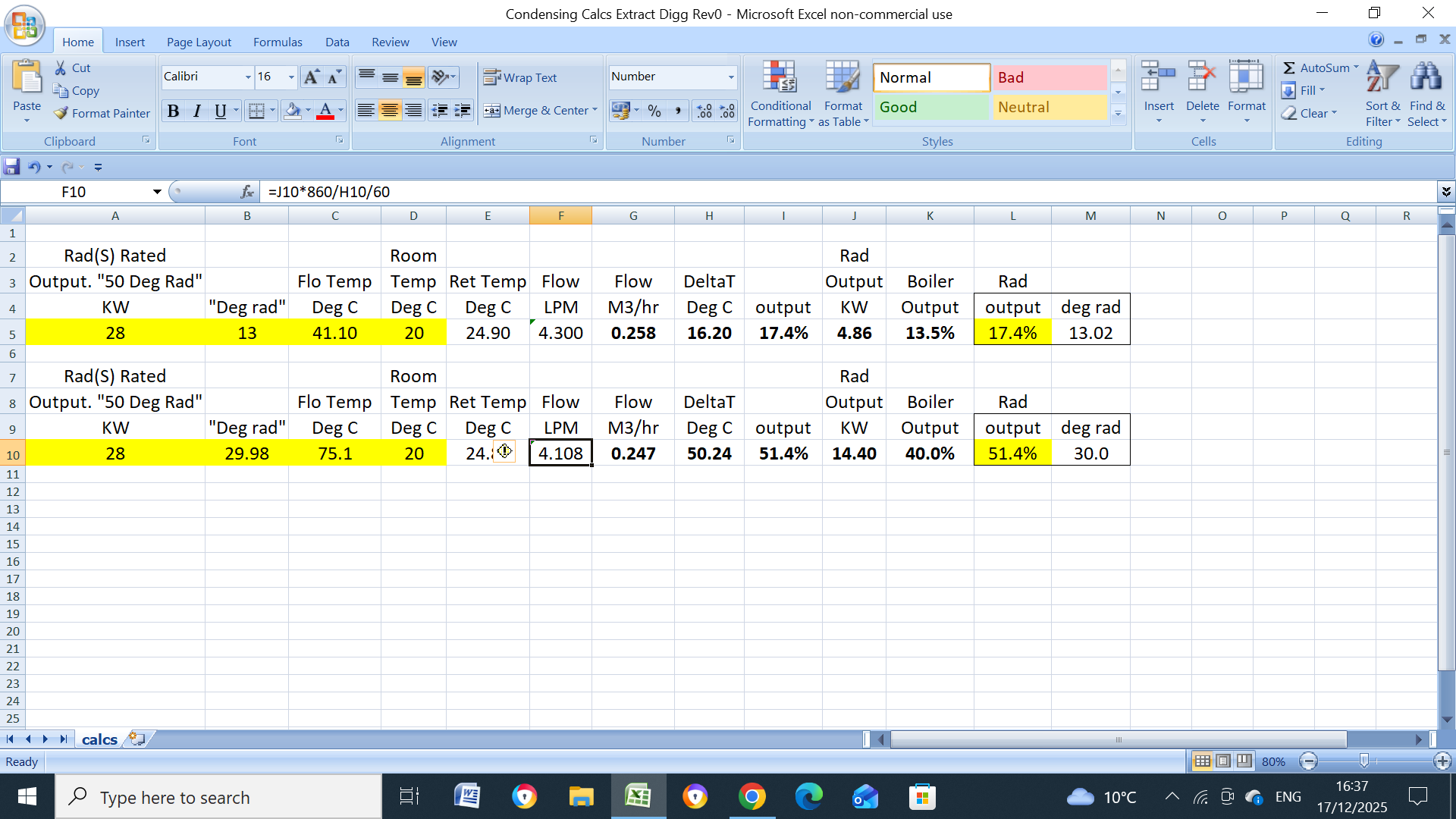

Can you recall what the boiler modulation was with your 41.1C/24.7C flow/return temperatures and was it and those two temperatures reasonably steady? If not, have you any numbers (modulation + flow/return temperatures) when it was?.

Looking at the datasheet the output of the boiler is 3.5 to 35kW. So pretty good modulation. Flow required through system is well below my heat pump and your piping is well suitable to my flow rates.
Small point not that it matters in this case but WB 35 kW boiler is 5.1 kW min according to the install manual
Was very surprised to see the 30 kW had a 3.0 kW min (Bet that it's impossible to achieve in reality
Interesting, if the measured flow&return temperatures are a steady 41.1C/24.7C then the boiler is just about running at its minimum output, by calculation its running at 4.86kW, 13.5% modulation but at a utterly abysmal flowrate of 4.4LPM, on the other hand, if, by some miracle its running with a flowtemp of 75C but with the same return of 24.9C then it's output is 14.4kW, 40% modulation,  but at a huge dT of over 50C which most boilers would not continue running with, (max dT normally tolerated is ~ 30C), the WB does not monitor the return temperature.
Edited by John Carroll
I suspect it's a coincidence. I have measured at the gas meter when the boiler burner output says 40%, I did the 3minute measure at the meter and it is using the correct amount of gas at that modulation.
