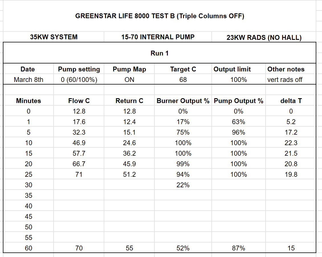

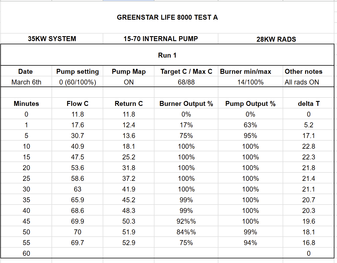

Hey all sorry was away for a bit on holiday... lovely not having to stress about heating when you're in a warm country eh.
I ran some more tests and logged the data. I may have mentioned already but I have a mix of type 22 and triple column rads in this system too. Those triple column rads always take a lot longer to warm up because of the amount of water content in them, its maybe 70L just in those as they're huge. So i wanted to do an A/B test with all rads on Vs all rads on bar the triple column ones. To see if it would affect the ramp up time by much. My thinking was, if the heat up time is very similar then the issue is likely that the pipes in the subfloor are losing lots of heat (as they're maybe 50-60meters of piping down there in total).
Also taking your advice from the forum I ran both of the tests in pump setting 0 (proportional to burner mode), in which the range min was set to 60% and the max set to 100% Test A was all rads on, Test B was all rads on Bar the triple column ones. Note: i've set the target to 68c now rather than 60 just to see if it helped speed the ramp up too.
On test B it did heat up quicker, but also tripped the burner out at 27minute mark....I imagine because without the triple column rads TRV's on, it was just too much heat for the system.
I've got a few other things i want to try in my next set of runs.... but before I speak to them, what do you think of the above? On Test A i'm still a little baffled that the boiler is reacting so slowly to modulating down.

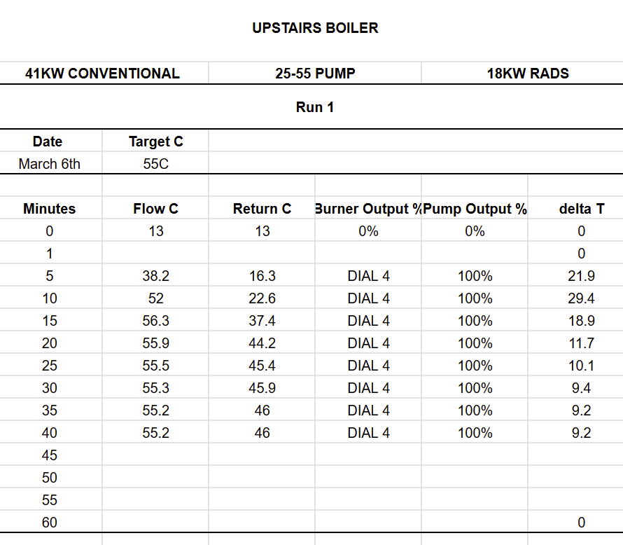

Perfomance wise, i want it run more like the other boiler I have at this property. I'll put the data log of that one below. Its 41kw CDI conventional (with grundfos 25-55 pump) and powers around 22kw of rads. i've no issues with that boiler. It warms up fast, Runs exactly as I want it to. im sure it is overpowered for that system but again, no issues with overshooting or anything like that. Just works (tm). I wish the greenstar 8000 life in question here ran more like that.

That doesn't seem efficient to me
Sorry confused - the way you want to operate isn't efficient anyway. So are you fussed about efficiency? You seem willing to spend thousands to get a poor efficiency system anyway. I'm not even convinced you need you need two boilers, but hay ho.

The boiler's behaviour in reaching 100% output seems quite reasonable IMO, 5 minutes to reach 75% and a further 5 minutes to reach 100%, my daughters Vokera Vision 20S is pretty similar except, as it states, in the MIs.... it takes another 10 minutes to increase the output from 75% to 100%., it probably doesn't take quite 5 minutes to reach 75% but ~ 2 or 3, not a whole not different.
Yep, from monitoring i think this is just standard behaviour from modern boilers. Though as part of the test yesterday I did try setting the burner min output% to 45% (default is 14%). It did shave a few minutes off reaching 60c, but i think it also caused further problems with the boiler not being able to properly modulate down once it had hit/exceeded target temp. I need to confirm that today with another test, may've been a coincedence.
