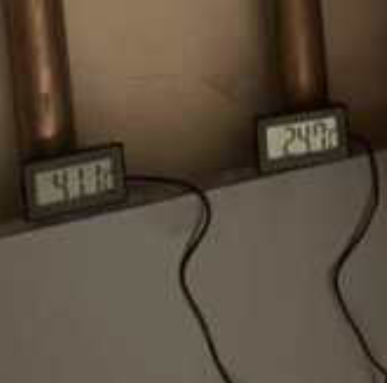

Op says target temp of 70C. With the flow temp on pipes ony reaching 53-54, I wonder what the return temp is on the pipes as that would tell up a lot. @EinTopaz?
Good question. The flow pipe at 53/54 the return tops out at around 42. Generally speaking the delta stays at 20 ish or so for a while, then after the first hour once the flow stops climbing, the return closes the delta down to 12ish, worst case sometimes as low as 9ish if I leave the boiler on for ages.

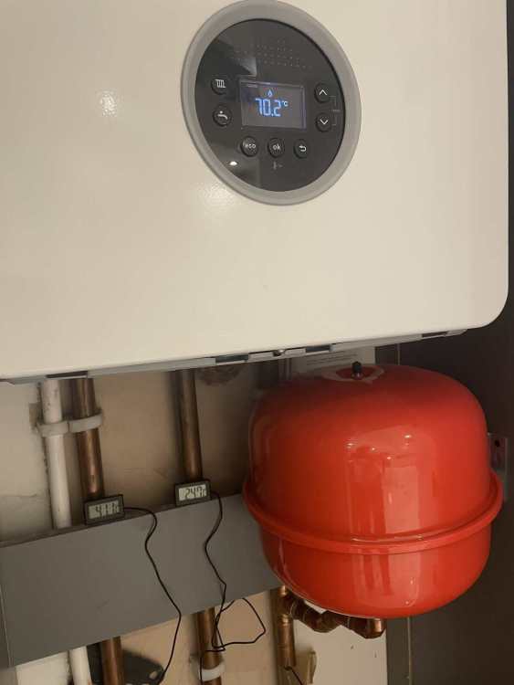

@EinTopaz
Sounds like a restriction. Can you post some pics of the valves under the boiler, the ones that actually connect to it.
This stinks of one of the flow or return valves being only partially open.
Next check is to remove the head off the zone valve and move the spindle manually. Do this with the boiler at 70° and then see if the temp shoots up on the flow pipe stat.
Pipework / sizing is A OK. 👍. No issues there.
Hey @Nickfromwales thanks for the reply. I put a video on Vimeo of the valves under the boiler, and the mag filter etc, those are the only valves I can see physically.

I think more the point that it’s getting to 70° as it’s unable to dissipate heat and therefore is overshooting?
It is overshooting yes. In normal operation, it sometimes goes as high as 6'c over target and flicks the burner off for a minute or so. The temperature rapidly drops during that minute. Then when it comes back on its a very low% burner output and creeps back up to target temp then stays there pretty stabley. But still with the 20'c differential between LCD display and flow pipe.

I reckon flow is choked. Usually a partially open valve on the jig, or a partially open gate (pump) valve.
I hope you're right. Let me know if anything looks untoward in the video link above.

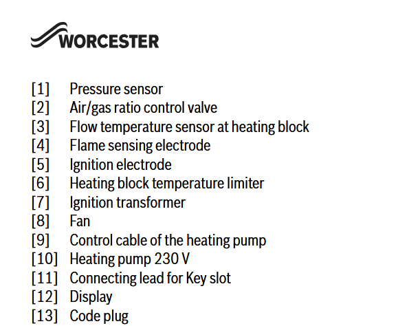

My favourite pastime is reading "Boiler Installation" manuals
Item 3 - Flow temp sensor at the heating block..............
Seems the boiler can be range rated although I'm not sure how low it can be rated - looks like it can't be range rated to min of 5.1 kW but it can be throttled back to around 15 kWh as a max
Settings under "heating" menu it seems
Also seems like the pump curves can be adjusted too but I think I'd start with capping it's enthusiasm to ramp up to 90%

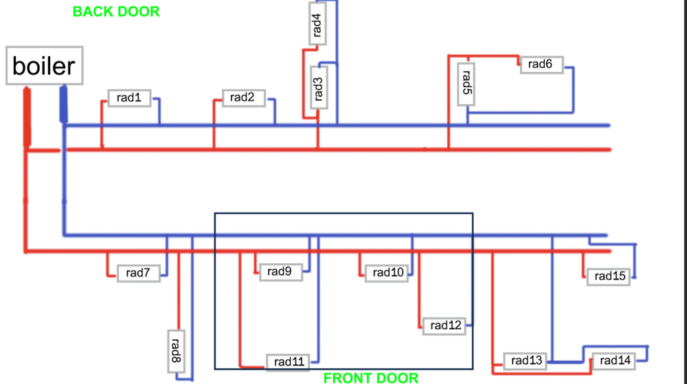

21 hours ago, EinTopaz said:
36KW system boiler and CH only. It powers 15 radiators, 11 x type 22 and 4 x triple column which sum total around 28kw total @ T50
Can I ask a basic question, how big is the house and what is the calculated heat loss.  For 36kW, it has to be pretty big, uninsulated and pretty drafty.  Is this the case?
Boiler are pretty simple in a lot respects.  They are trying to heat water, the bigger the boiler the higher the flow of water needs to be to move that heat away.
