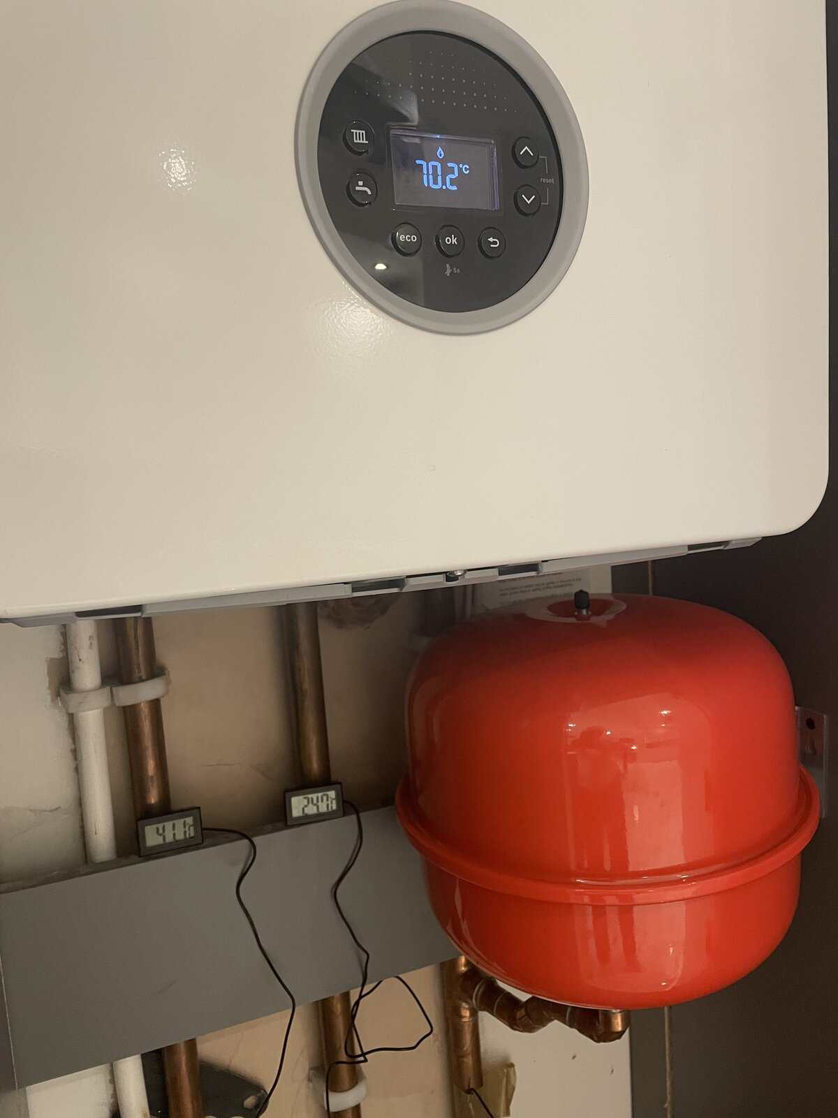

  • The most notable issue is that is the boiler seems to be reaching (and actually slightly overshooting) target temp of 70'c within 10minutes of it firing up from cold. This is displayed via the boilers LCD display . Yet despite this, the flow outlet pipe and all radiators take longer to get hot to the touch, and the flow pipe and radiators never seem to get higher than around 53-54degrees, which ofcourse is way cooler than what the boiler LCD display is showing. So there seems to be a fairly large temperature differential between what the boiler thinks the flow temp is and the heat of the stuff outside the boiler. Almost as if the boiler can't get the heat away from itself...? I've added a photo of this too showing the LCD display and thermometers I put on the flow/return pipe.

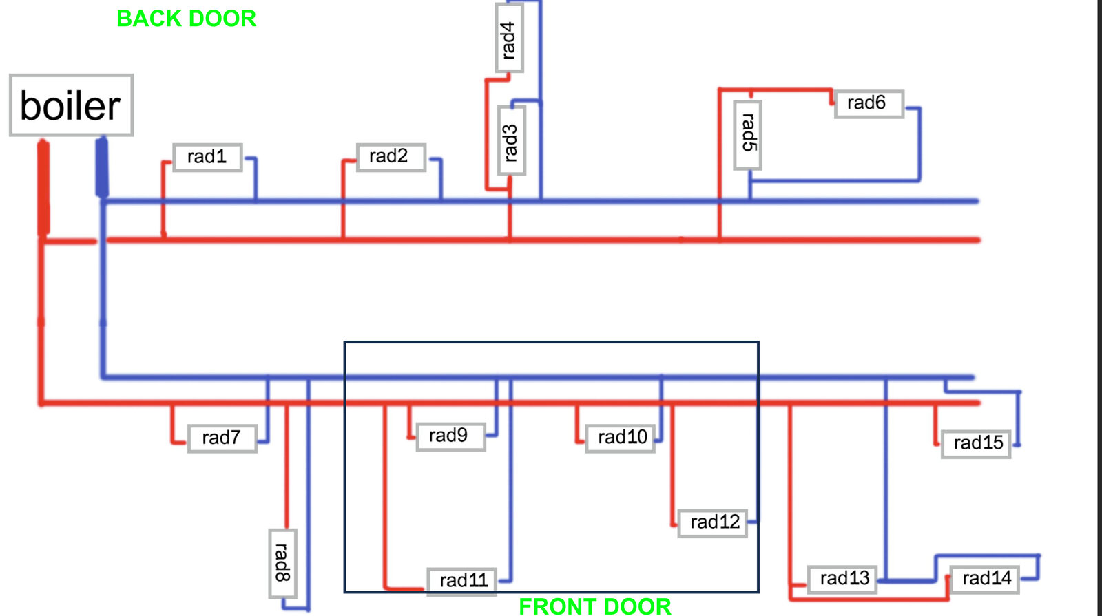

System design image
(thick lines 28mm, medium lines 22mm, thin lines 15mm, black square outline is the 4 x triple column rads)
Lcd readout image (left thermometer is flow, right is return)

I'm guessing there is an auto bypass fitted somewhere on the system near the boiler? IIRC the minimum length of pipe for this according to the MIs is about 3m?
You're pretty much overpiped, so on a gas boiler upping the 22mm pipes to 28mm would make no difference.
As you've surmised, you have a flow problem, but it may not be low flow, but flow returning back to the boiler through a portion of your pipework acting as an uncontrolled bypass. Last time I had this was with 2 37kW Worcesters piped into a low loss header.
I've just re-read your op where you say the the flow pipe out of the boiler doesn't rise in temperature. Again, you've surmised correctly. This can often happen when the heat load in the circuit is too low for the output of the boiler - the boiler fires up and before it gets to modulate down the water in the heat exchanger gets too hot. Are you experiencing short cycling? As it does the boiler get really hot, like 80C plus and then turn itself off for a while before re-starting?

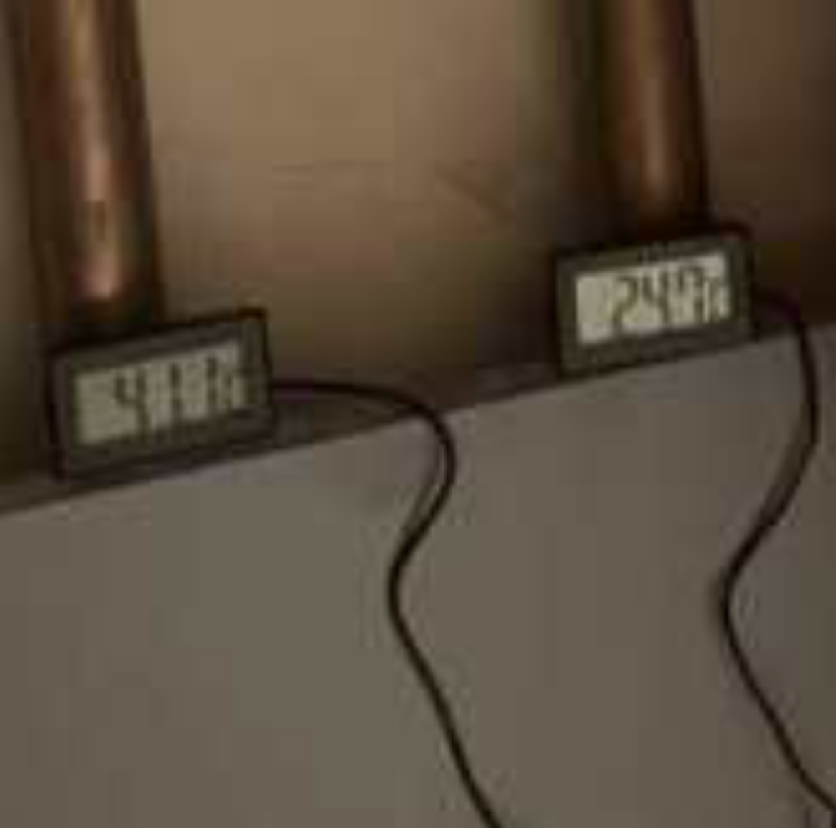

Op says target temp of 70C. With the flow temp on pipes ony reaching 53-54, I wonder what the return temp is on the pipes as that would tell up a lot. @EinTopaz?
Zoom in and see the two Amazon stats on the pipes.
They aren't normally too bad for accuracy as long as they are tightly encased in some foam lagging - if just cable tied to pipes they are pretty poor temp indicators

If the boiler is producing 70 deg heat (according to the display) then unless the display is miles out or it's indicating a set point rather than an actual temp out - I would expect a similar temp at the flow pipe - so I'd wonder where the heat is going!!!
3 minutes ago, SimonD said:
Yes, possibly, but it's intriguing that the Delta t across flow and return is about 16C.
The boiler would shut down the burner way in advance of reaching 70° though, if there’s any discernible flow out to a circuit getting rid of heat?
This looks like it ‘kettles’ quite soon after the burner ignites and there’s an unavoidable overshoot.
It’s not going anywhere.
Light, overheat, shut off, cool down a bit, repeat.

I fail to understand how a flow pipe leaving the boiler can be 30 deg lower than the water temp reached inside the boiler - it's likely to be 30-40 cm of pipe max so unless it's going via a blast freezer there is heat going somewhere
