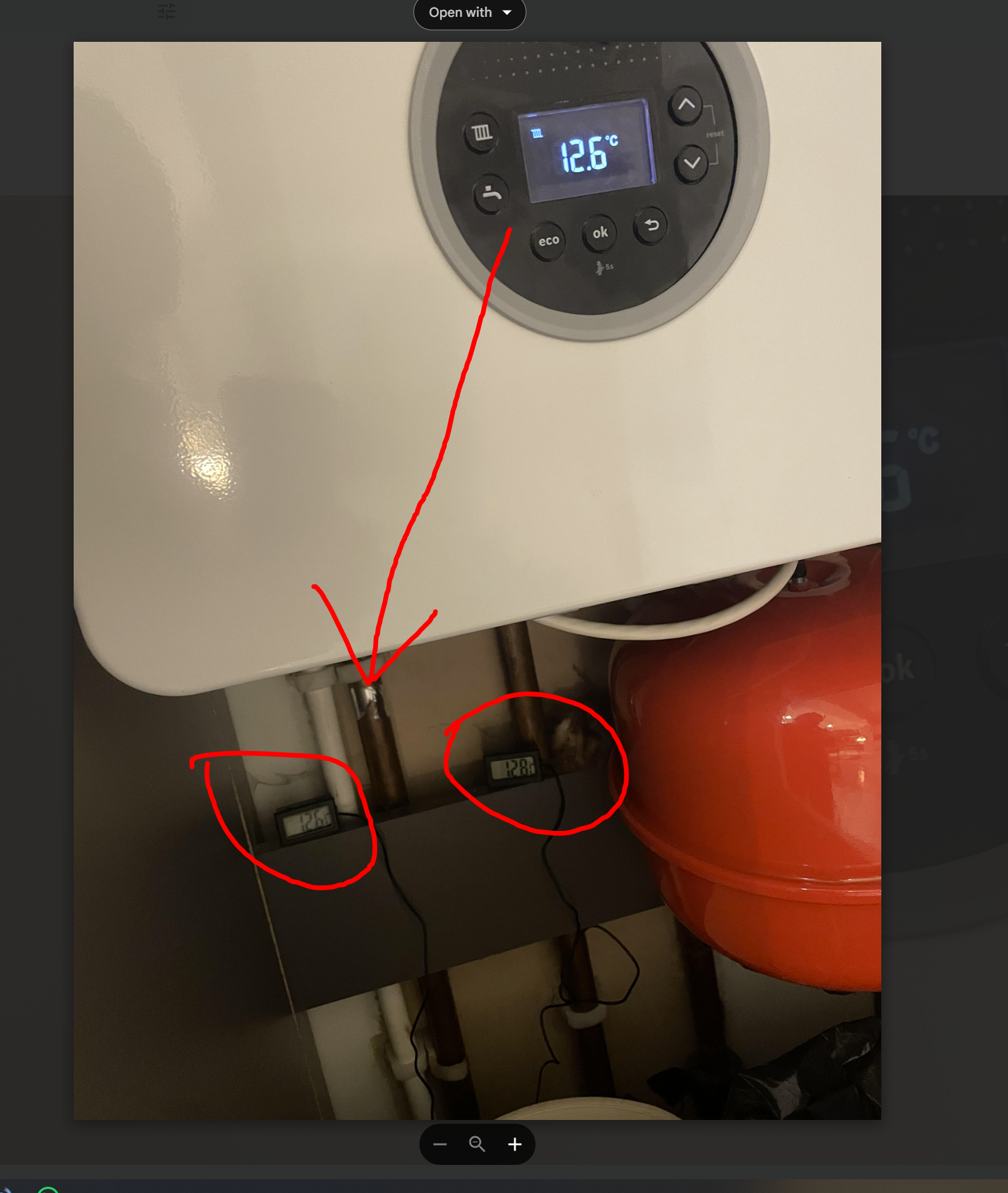

SimonD Posted December 19, 2025 Posted December 19, 2025 2 hours ago, EinTopaz said: The flow pipe is 20'c cooler than the boiler is saying. 1 hour ago, John Carroll said: Since WB know that a huge dT exists as measured by their own instruments then they just can't wash their hands of the problem?. Any engineer worth their salt would open up the boiler and measure the actual temperature of the heat exchanger particularly where the flow exits the chamber and even better next to the sensors the boiler is using, not just the flow and returns outside the boiler. I don't think they measured a huge DT? but suggested increasing the set temp to increase the flow temp. Now they're by accounts coming back with a new pcb, which seems sensible. There a just too many unknowns right now. What controls is the boiler wired up to? Are they WB modulating ones or third party?

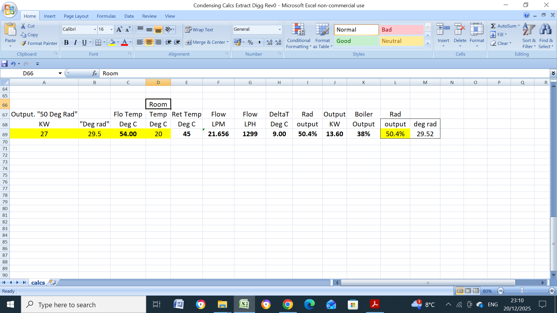

John Carroll Posted December 19, 2025 Posted December 19, 2025 3 hours ago, SimonD said: Any engineer worth their salt would open up the boiler and measure the actual temperature of the heat exchanger particularly where the flow exits the chamber and even better next to the sensors the boiler is using, not just the flow and returns outside the boiler. I don't think they measured a huge DT? but suggested increasing the set temp to increase the flow temp. Now they're by accounts coming back with a new pcb, which seems sensible. There a just too many unknowns right now. What controls is the boiler wired up to? Are they WB modulating ones or third party? WB certainly confirmed that the external flow sensor was reading the same as their one and presumably the return, but not sure about this one. I might have missed it but what did or do the external sensors read after a extended boiler run?. if both known, then very easy to calculate the flowrate as the constant boiler output will also be known, 40%??.
John Carroll Posted December 19, 2025 Posted December 19, 2025 4 hours ago, JohnMo said: But it has a modulating circulation pump which will change output based on dT, so not sure that can be fully true. This boiler doesn't measure the dT because it doesn't have a return temperature sensor, also the pump is (customer) clamped to virtually constant speed. 1
EinTopaz Posted December 20, 2025 Author Posted December 20, 2025 On 19/12/2025 at 14:54, John Carroll said: What's your next move?. Since WB know that a huge dT exists as measured by their own instruments then they just can't wash their hands of the problem?. I've WB coming back on Monday, with a new control board. Will show them the issues. I would've liked to go down the sub floor myself between now and then and have a look at where the single 28mm flow and returns each split into dual 22mm ones. If those splitters have valves on em, im wondering if they've been left partially closed. I've mentioned already... but last WB guy, as I stated above very much did try to wash his hands of it and said its normal to have a difference between boiler target temp and flow pipe temp. I challenged that. He didn't really have a good come back. And just said we should raise our boiler target temp to 80. Which has brought the new kettling symptom in now. This is why I've asked for a more senior gentleman to come, this time.

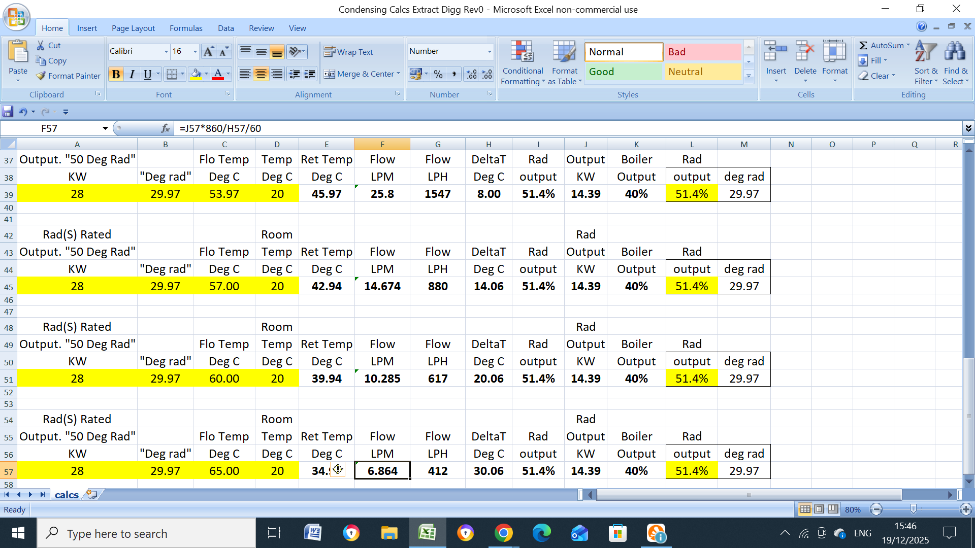

EinTopaz Posted December 20, 2025 Author Posted December 20, 2025 On 19/12/2025 at 20:21, John Carroll said: I might have missed it but what did or do the external sensors read after a extended boiler run?. if both known, then very easy to calculate the flowrate as the constant boiler output will also be known, 40%??. If the boiler is set to 68'c target temp, it settles at around 70'c after an hour. At this time, the flow pipe will max out around 54'c and the return 45'c, I appreciate that delta between flow/return is too small for a modern boiler. it does maintain 20'c delta for the most part but really closes down after the boilers been on for a while.

EinTopaz Posted December 20, 2025 Author Posted December 20, 2025 On 19/12/2025 at 17:01, SimonD said: Any engineer worth their salt would open up the boiler and measure the actual temperature of the heat exchanger particularly where the flow exits the chamber and even better next to the sensors the boiler is using, not just the flow and returns outside the boiler. I don't think they measured a huge DT? but suggested increasing the set temp to increase the flow temp. Now they're by accounts coming back with a new pcb, which seems sensible. There a just too many unknowns right now. What controls is the boiler wired up to? Are they WB modulating ones or third party? They did acknowledge a huge DT between boiler and flow pipe. But tried to tell me that it's normal. Which sounded like BS. Also tried to say it was 100% likely a system issue. Which sounded like I was being palmed off. The boiler is wired up to Hive, and for all these tests ive been running it on boost mode. I dont think that makes any diff to running it normally tbh, but just for clarity.

MrPotts Posted December 21, 2025 Posted December 21, 2025 18 hours ago, EinTopaz said: If the boiler is set to 68'c target temp, it settles at around 70'c after an hour. At this time, the flow pipe will max out around 54'c and the return 45'c, I appreciate that delta between flow/return is too small for a modern boiler. it does maintain 20'c delta for the most part but really closes down after the boilers been on for a while. My boiler delta between flow and return is also around 10c after the boiler has been on for a few hours and it doesn’t cause any issues. I have a WB Greenstar system boiler though. 1

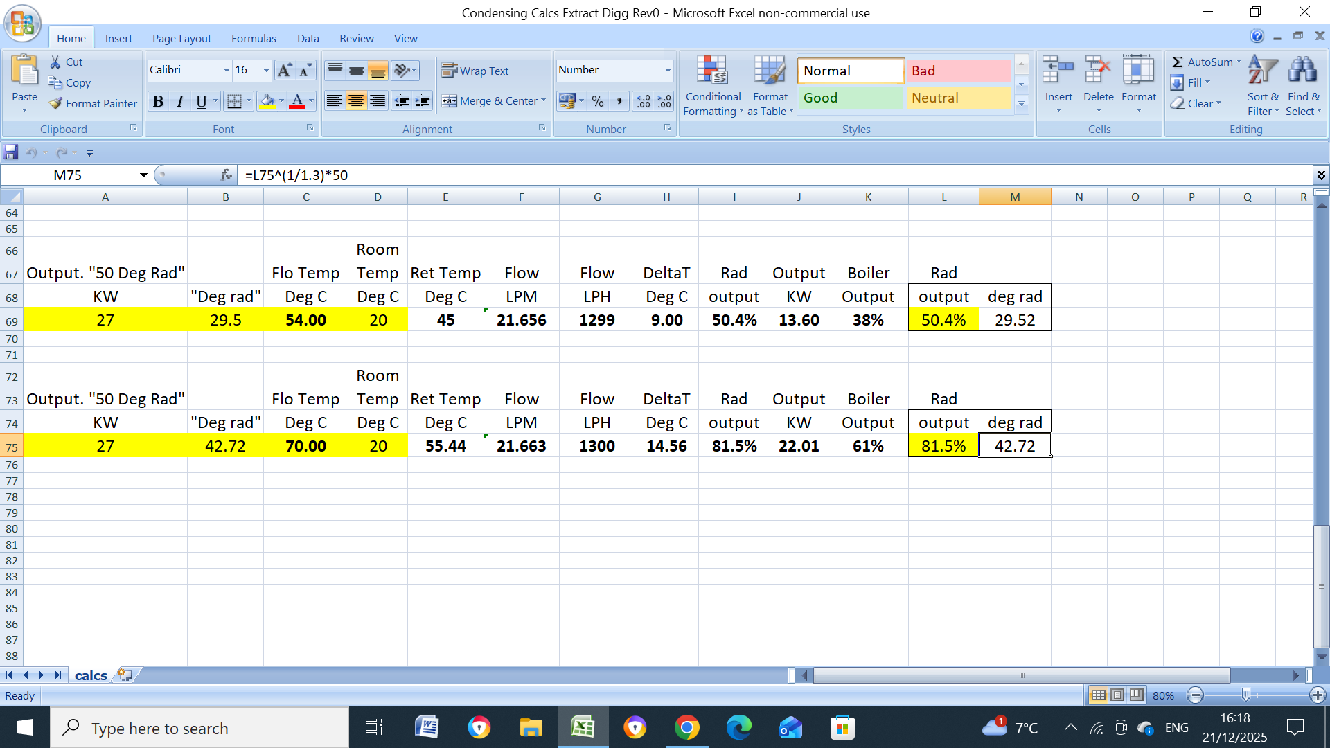

John Carroll Posted December 21, 2025 Posted December 21, 2025 Rad dT is a moveable feast if the flowrate remains constant like it does on quite a lot of boilers. In the above (subject boiler) a 54C flow temprature results in a boiler output of 13.6kW with dT of 9C, if that flow temperature was increased to say 70C either manually or by outside temperature compensation, the boiler output will increase to 22kW but the dT will also increase, to 14.6C, for the same flowrate of 21.7LPM.
EinTopaz Posted December 21, 2025 Author Posted December 21, 2025 18 hours ago, John Carroll said: One very important bit of data...what was/is the boiler output % with the above 54C/45C?? By that time, it will have modulated down to 40% output and stayed at around that.
EinTopaz Posted December 21, 2025 Author Posted December 21, 2025 6 hours ago, John Carroll said: Of course they will equalise, the $64,000 question is why is there is such a difference in temperature between the alleged flow target temperature and a measurement on the flow pipe a foot or two away from it, hopefully, all will be revealed tomorrow. Exactly this, hopefully the Senior engineer doesn't try to say that this is normal. a couple degrees, sure, but not 20,
