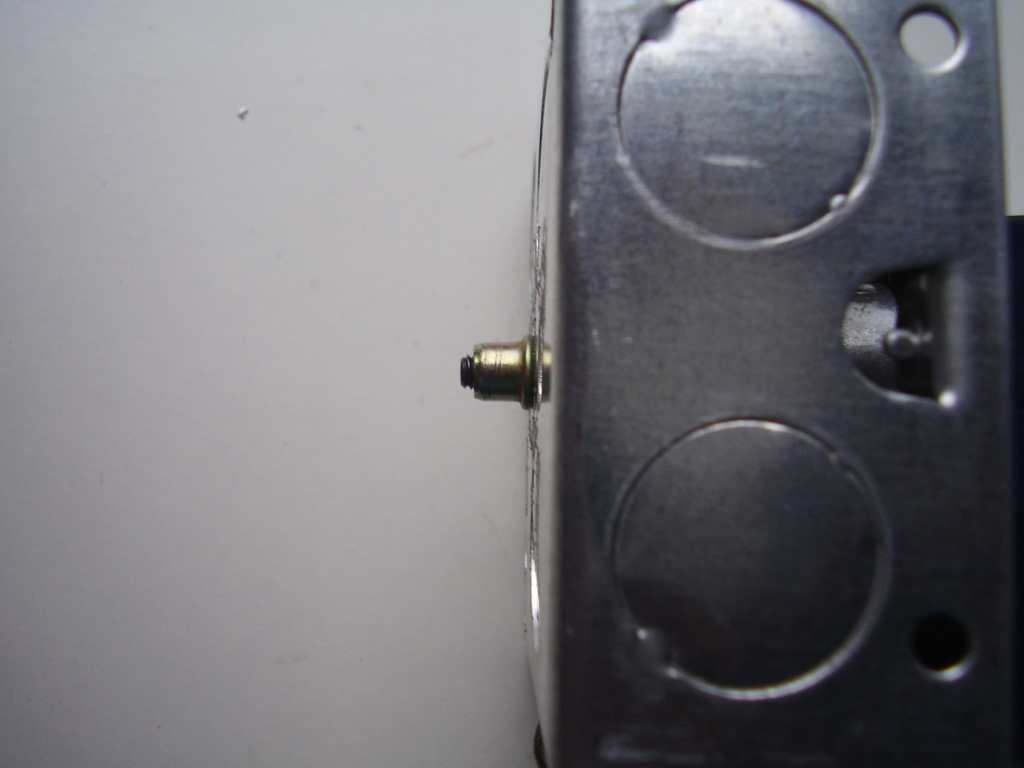

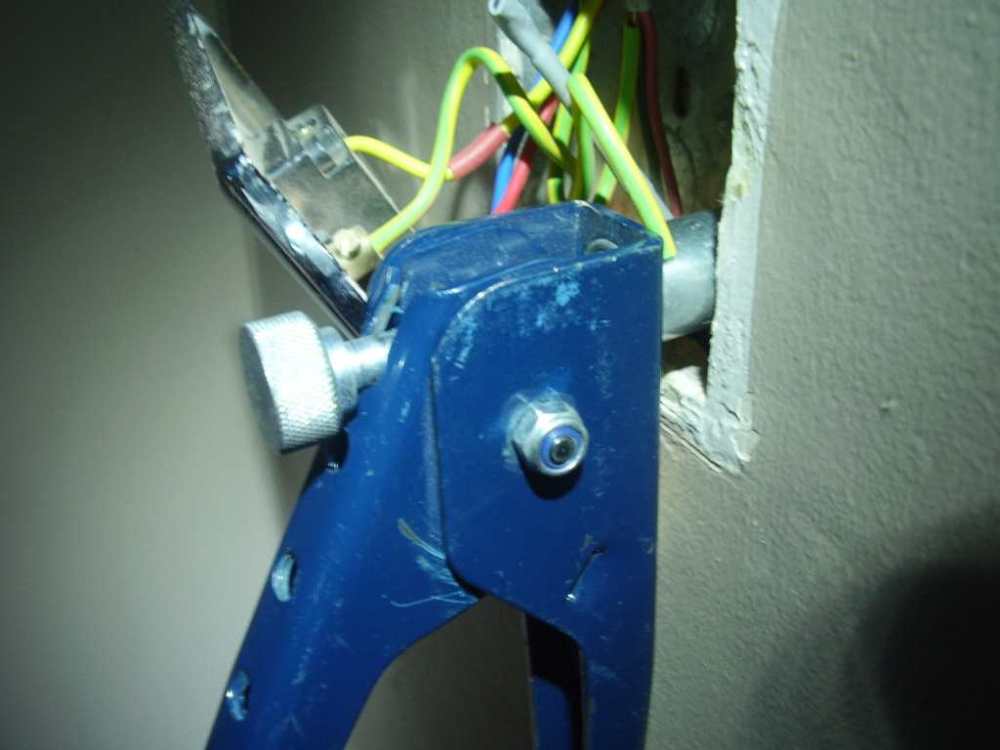

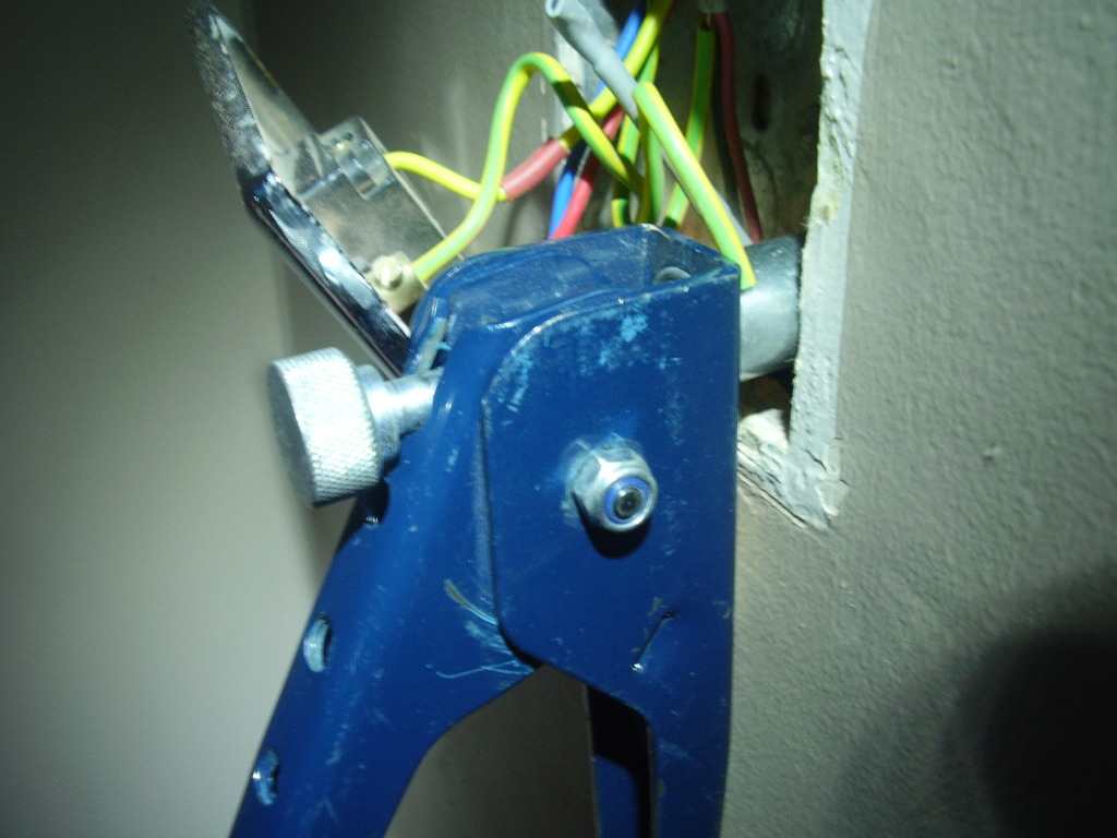

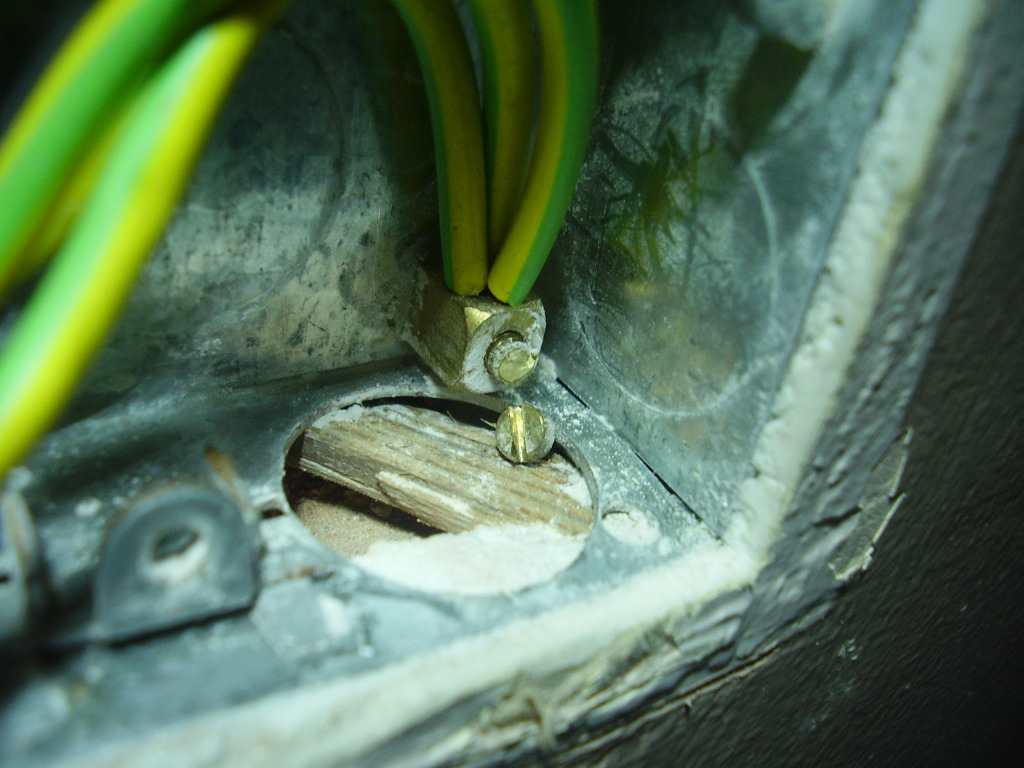

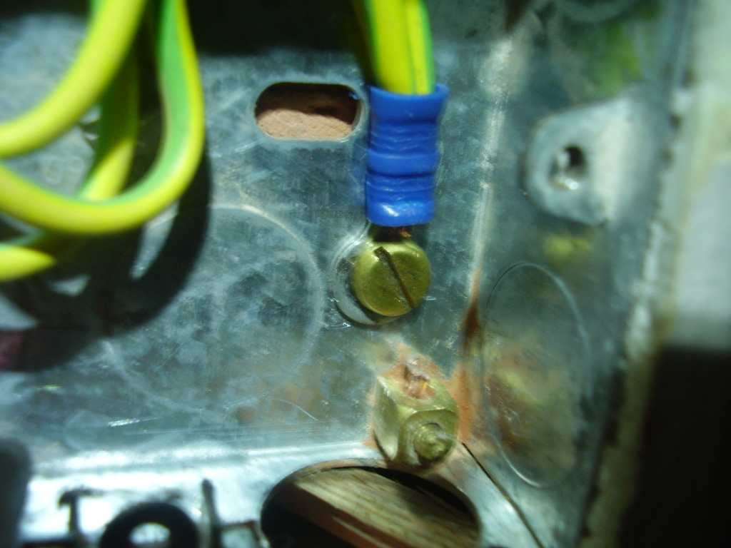

December 5, 2025Dec 5 On 03/12/2025 at 10:02, sgt_woulds said: Old ones won't have bonding connecteions for metal face plates, but those can be soldered on without removing from the wall. Other than that, as long as they are deep enough to take the gubbins for modern sockets without crushing cables I can't think of a reason to replace them? Not what the OP is talking about as he's confirmed above. Again an aside to the thread but on the subject of back box earth terminals, where I've come across the odd one that's damaged I've drilled and fitted a Rivnut and ring crimp Broken screw: Rivnut tool: New earth termination vs old: Rivnut shown here on a loose back box just for clarity:
