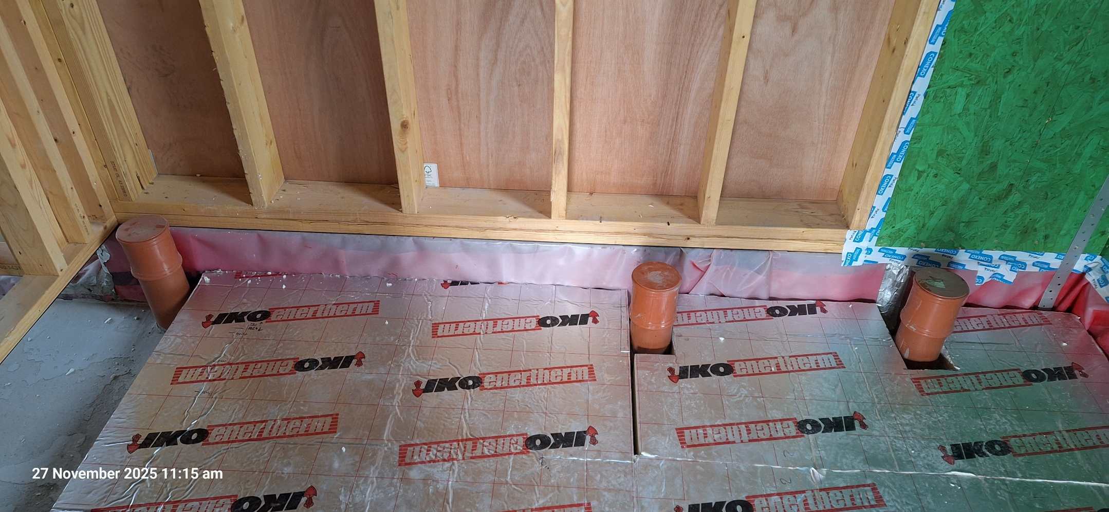

I have a 110mm male stub sticking up through my slab from the rest bend under the slab (currently covered with a femal blanking cap). I need to connect the soil stack to this.

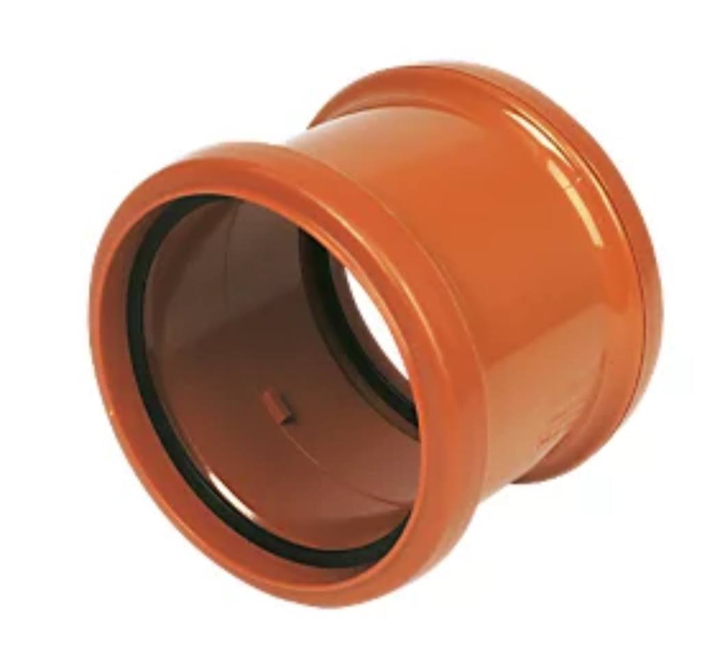

Is it OK to use a female/femal push-fit double socket (e.g. https://www.screwfix.com/p/floplast-push-fit-double-socket-pipe-coupler-black-110mm/47977) at the bottom of the stack? Just a little concerned about the stack contents falling the height of the house, hitting the male end with some force and escaping the rubber seal...but can't see another way of doing it?
(soil stack on the left - the other 2 are for sink & toilet which I guess will also have to be female/female connectors)

If you study a female - female coupling when mated to the respective pipes, there is literally nothing for "passing material" to hit on it's way past.

To me the photos look like you already have a "double female" connector in place on each soil stub coming up. You can see there's a little internal stop that the pipe inserts as far as. In your case, more importantly it stops the connector slipping down.

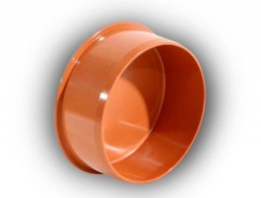

Each appears to then be capped with one of these. These can be simple removed by getting a flat blade screwdriver under the lip and levering up. As an aside I always use a silicone spray or smear of silicone/plumbers grease when assembling this stuff:

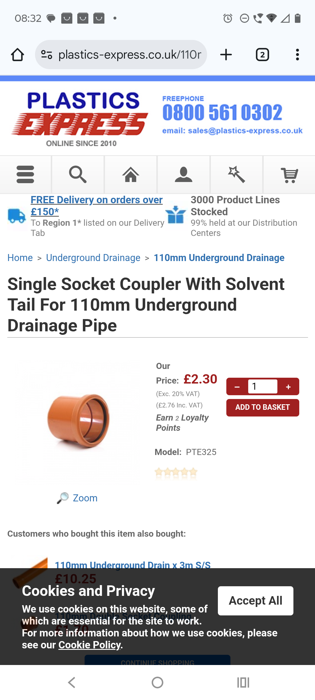

Random site but another option. Solvent weld one of these on the stub pipe:

Having said that, the solvent weld option looks less risky. Inspection of the pushfit does show that the downstream male end will simply be in the center of the fitting against the small stop tab, but there is no lip so nothing but air pressure preventing contents sliding down the outside of the male pipe's chamfer.

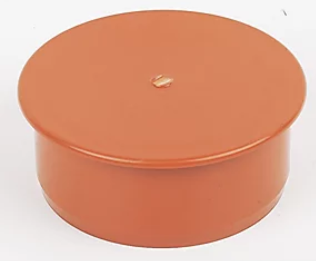

Unless I'm mistaken, the caps that the groundworks guys left are a single piece. Will have another look at them though, thanks @Onoff
The bend at the bottom is under the MOT and slab so well beyond my ability to inspect it 20 times a day like I do with most of my other "worry-it-might-not-be-tight-enough" jobs 🤣
I think you're mistaken 😂

Solvent weld is good, BUT.  It can't be undone.  So make SURE before fitting the solvent weld coupling that you have the height right and you will never ever want to remove it again to adjust the height with respect to finished floor level.  AND make sure you use plenty of solvent weld adhesive and do it thoroughly.  Otherwise a poorly done joint that leaks cannot be undone to re do it.
If in doubt practice on some scrap pipe and fittings first.
Id be steering well clear of solvent weld where passing thru a floor slap just put the pipe in and stop worrying
Yep, dry fit any solvent weld assembly first and put an alignment mark on adjoining fittings with a Sharpie.
Slap on the solvent weld and as quick as you can fit together and align the marks.
Nothing so complex needed here.
