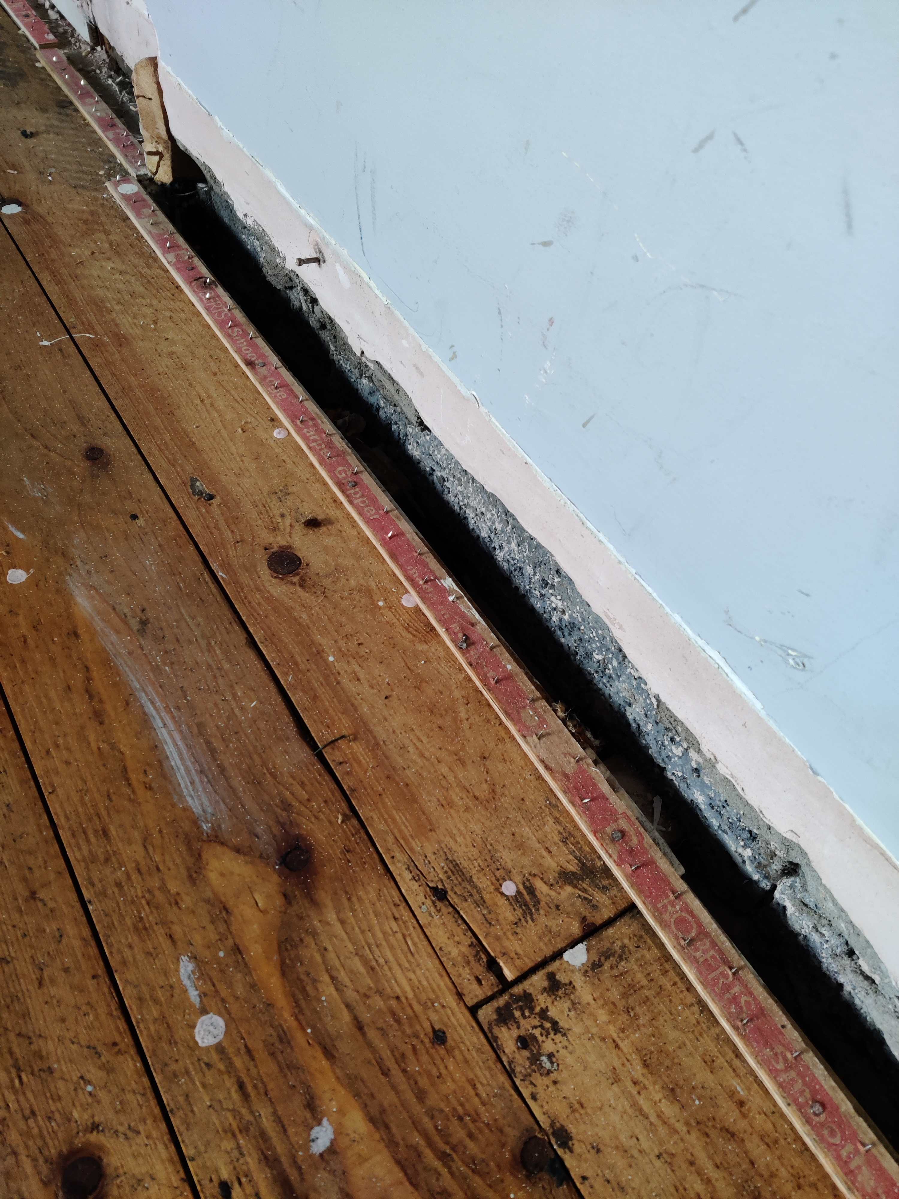

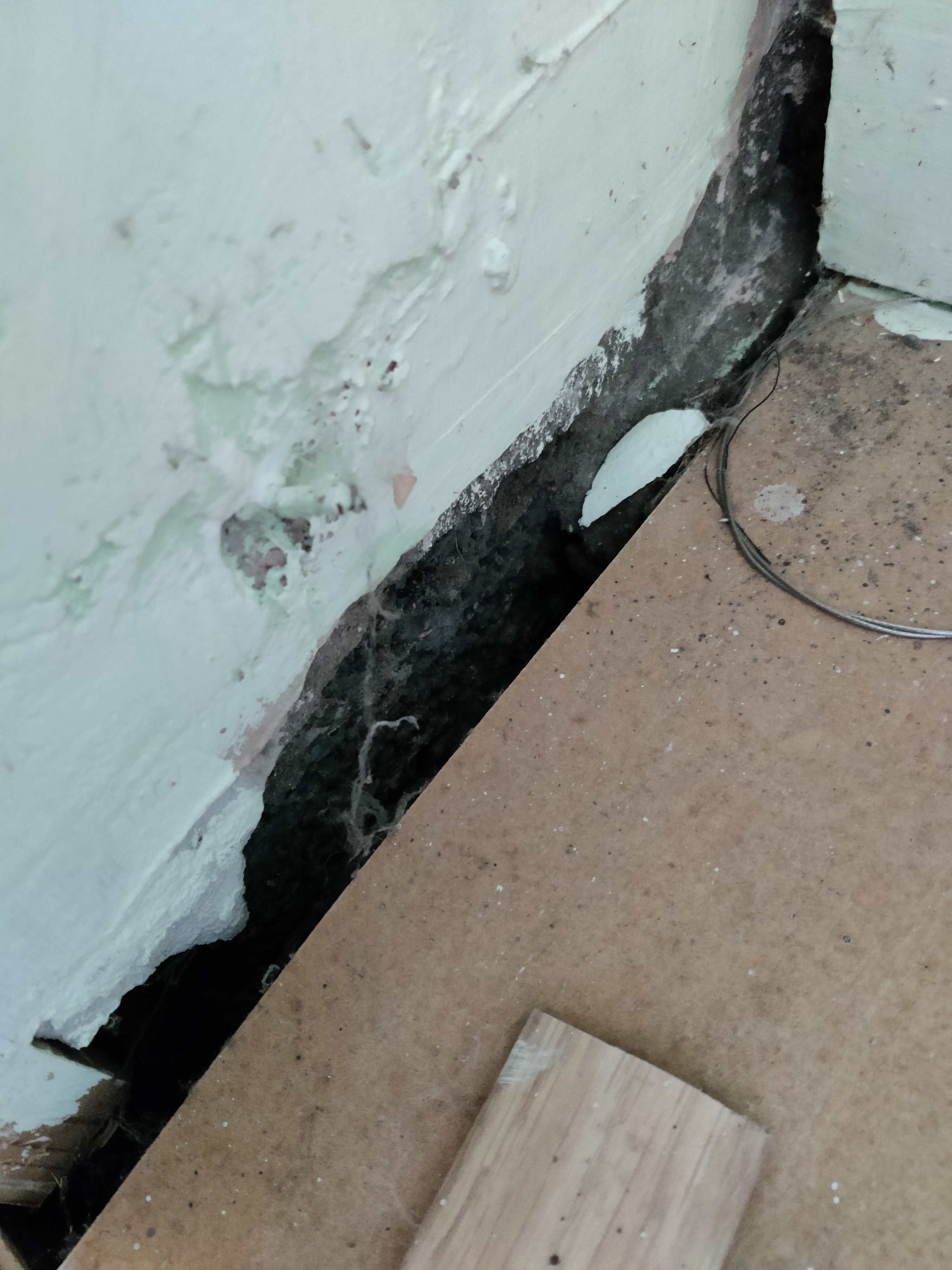

November 29, 2025Nov 29 My 1960's dormer bungalow is also incredibly cold in the winter which is worse when the wind is blowing Having recently removed the skirting in all the ground floor rooms, I found gaps you could fit your hand in, straight into the ventilated sub floor The sub floor timbers were in perfect condition! I would check your rooms for air leakage points, as I imagine, like mine , some of your heated air is being drawn through the house and into the sub floor Beyond that, but more intrusive, is insulating below the floorboards as others have mentioned
