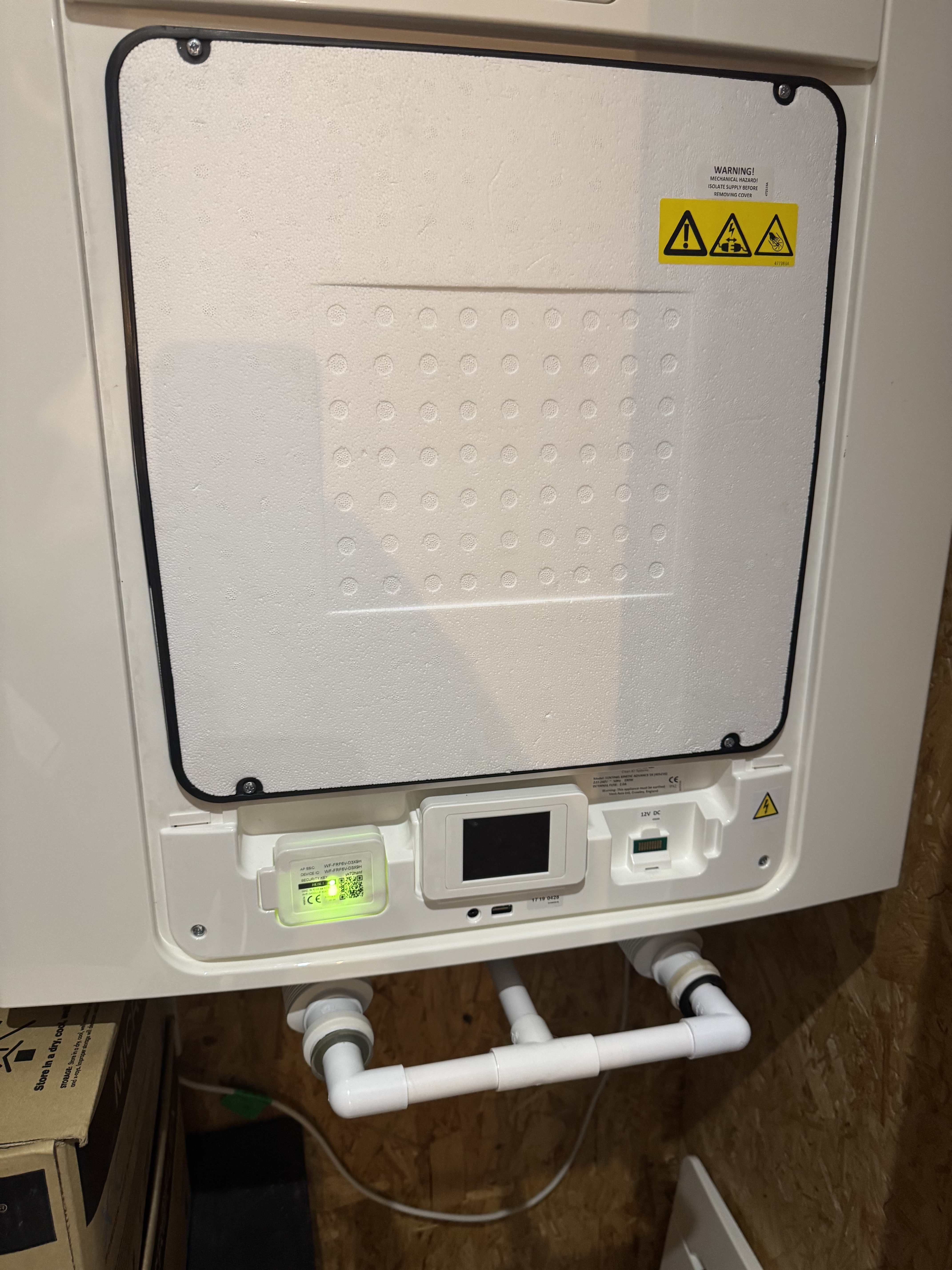

Pocster Posted November 24, 2025 Posted November 24, 2025 Hard to explain . Like a vibration / whoosh and then settles so not constant . Assume fans dying . If I open this up ok to just wd40 the bearings ??
Pocster Posted November 24, 2025 Author Posted November 24, 2025 Apparently bearings are sealed so no wd40 . Will take it apart tomorrow

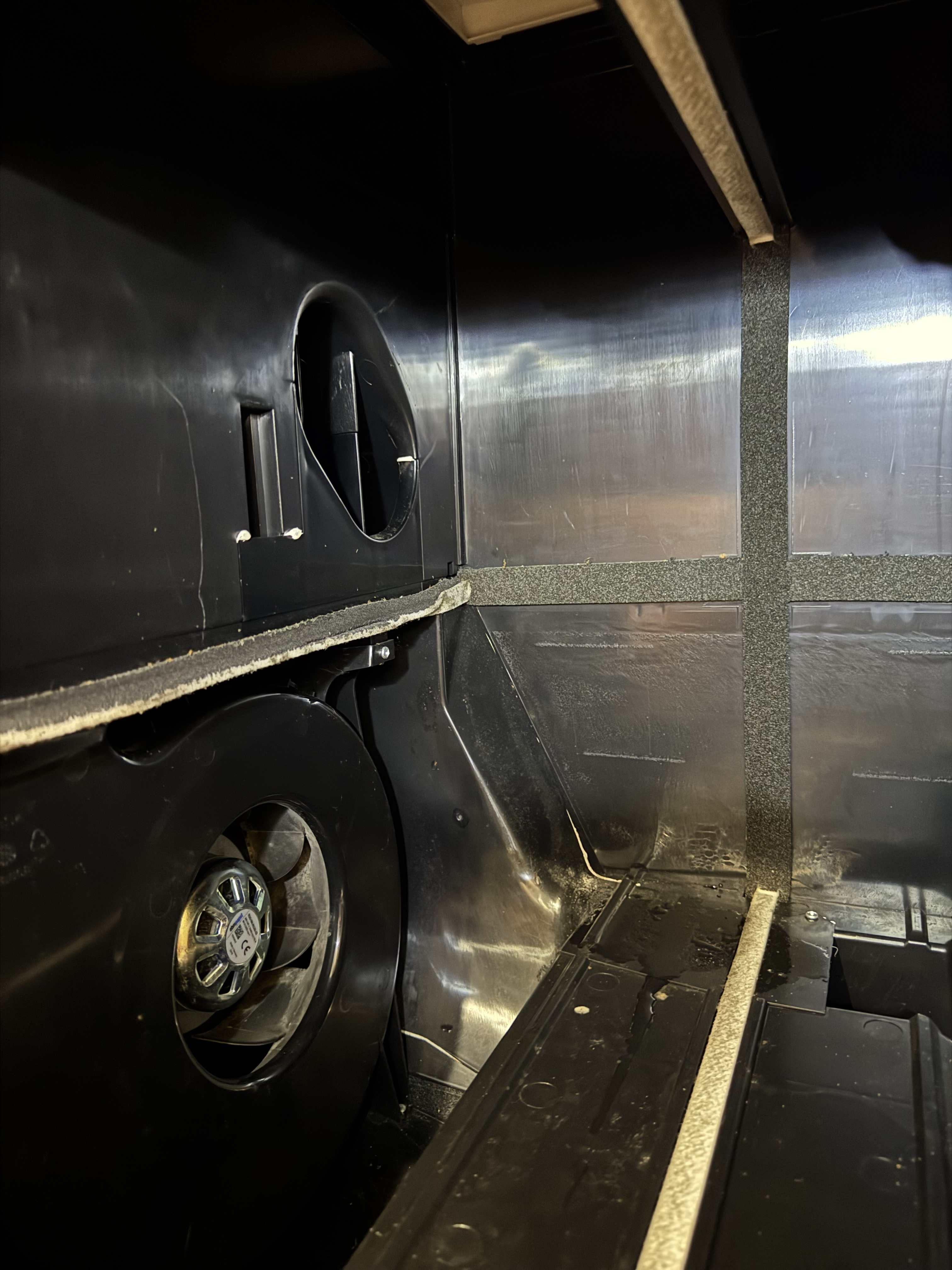

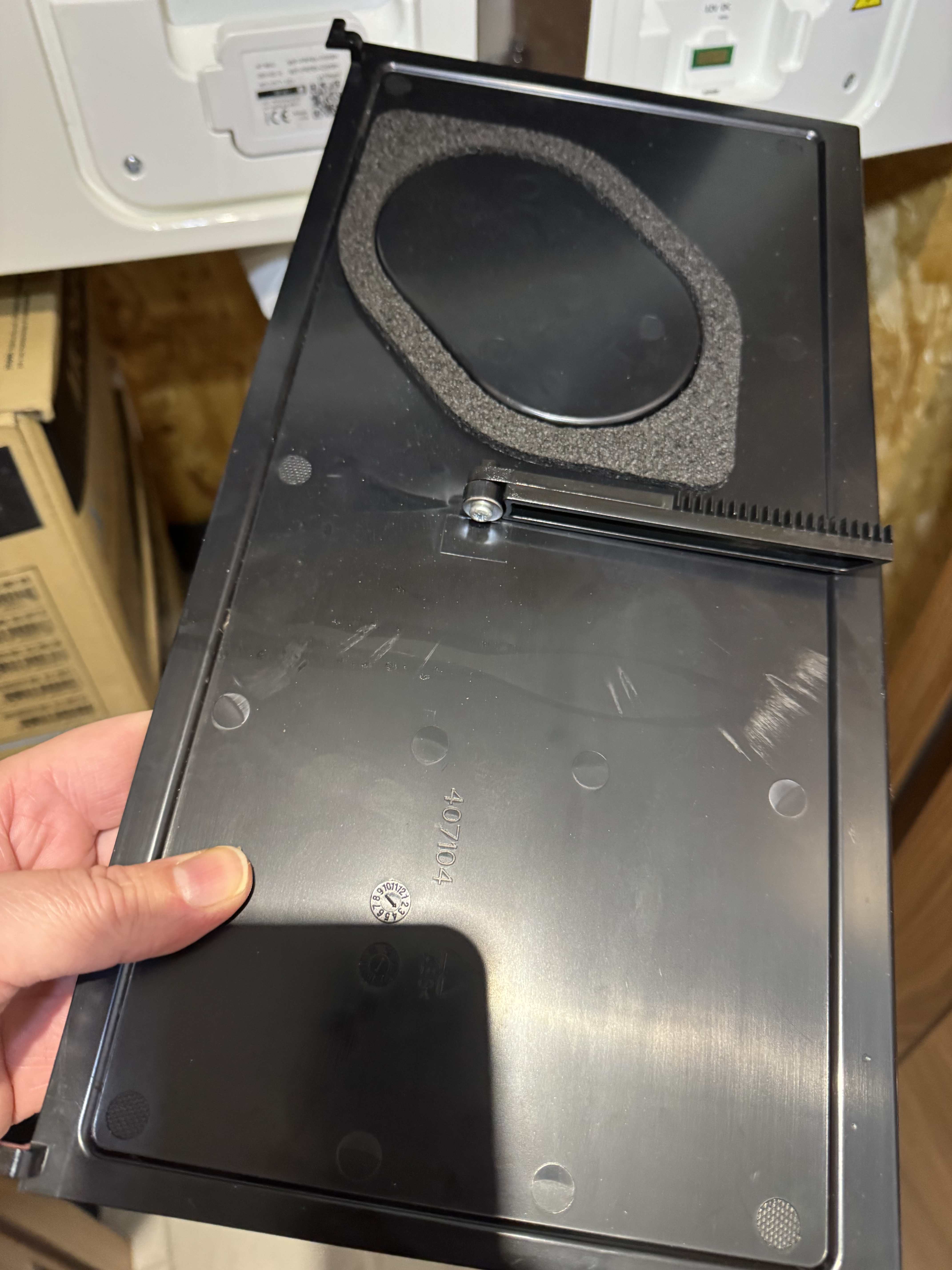

Pocster Posted November 25, 2025 Author Posted November 25, 2025 Opened it up and this bit fell out ! This the summer bypass thingy ? Struggling to get it back in
Pocster Posted November 25, 2025 Author Posted November 25, 2025 Ok I’m confused . Powering it on causes a whirling noise presumably for this arm . But I can’t get the arm in and close the flap

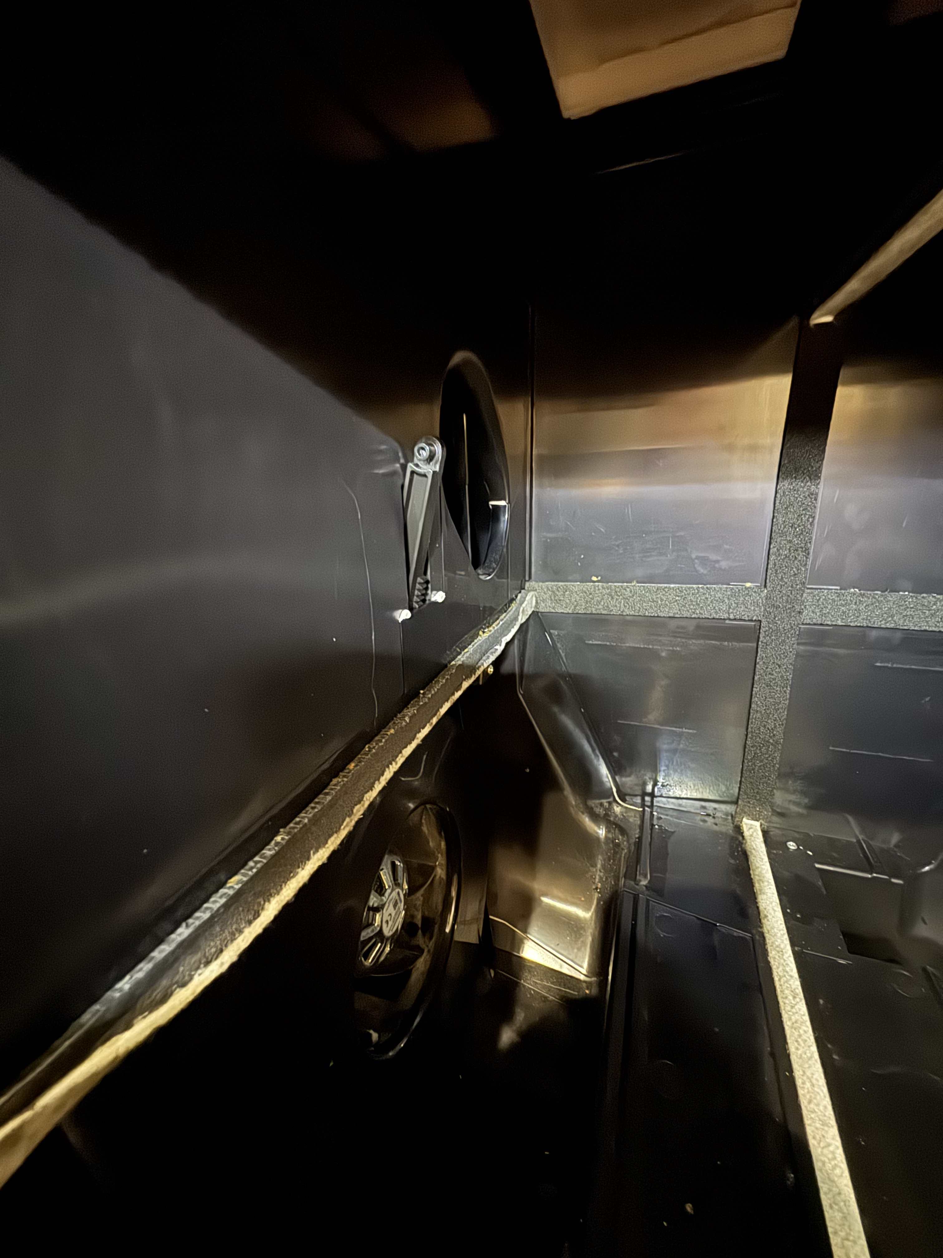

-rick- Posted November 25, 2025 Posted November 25, 2025 Hopefully you spotted it but it doesnt look like the hinge at the bottom left is in correctly. From the earlier photo it looks like that end has to clip in first then the other end will snap in place? Other than that observation I can't help you. Do you have a service manual? If not, find one? 1

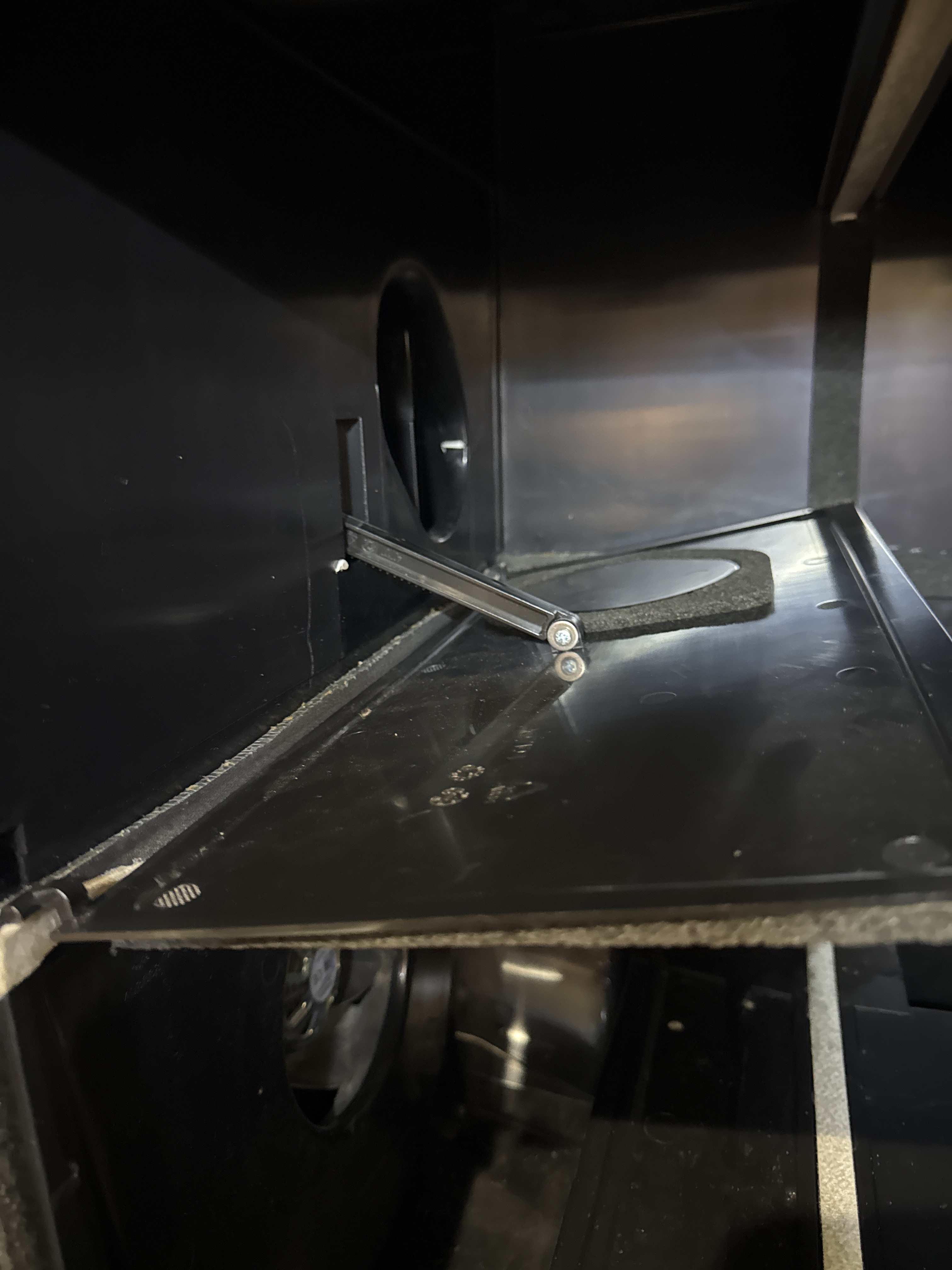

Pocster Posted November 25, 2025 Author Posted November 25, 2025 I can get the bottom clips in that’s okay . But as that arm goes in the slot- it gets stopped before I can get the panel closed - like it’s hitting something
Pocster Posted November 25, 2025 Author Posted November 25, 2025 Found manual online . Vent axia kinetic advance sx . Doesn’t even show this internal panel and arm
Pocster Posted November 25, 2025 Author Posted November 25, 2025 Even taking the arm off the panel it won’t go in 🙄
Pocster Posted November 25, 2025 Author Posted November 25, 2025 lol ! Nearly shit myself . Decided to turn it on whilst holding the arm in the slot soots. It took the (expletive deleted)er ! if I just permanently turn off summer bypass then I need not care ? ( obviously at the moment can’t get arm to fix to panel )

-rick- Posted November 25, 2025 Posted November 25, 2025 1 hour ago, Pocster said: lol ! Nearly shit myself . Decided to turn it on whilst holding the arm in the slot soots. It took the (expletive deleted)er ! if I just permanently turn off summer bypass then I need not care ? ( obviously at the moment can’t get arm to fix to panel ) Turn it on put it in bypass and let it stick its tongue out for you to inspect. Then reassemble and let it revert to normal mode? 1 hour ago, Pocster said: Can I find replacement fans …. 🙄 maybe … but how (expletive deleted)ing much !!! Time to order some bearings then? 🙃
