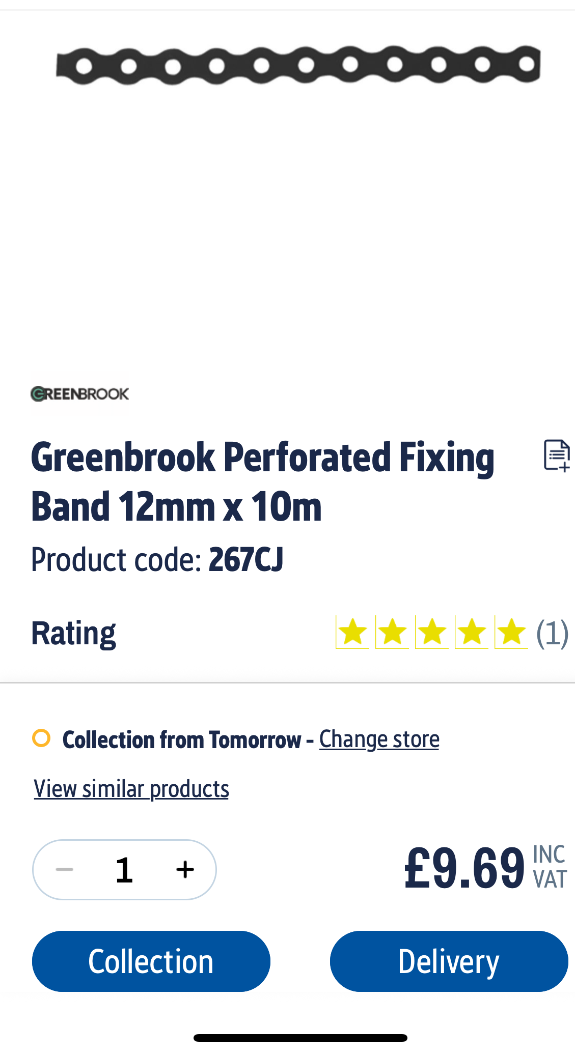

Russell griffiths Posted November 18, 2025 Posted November 18, 2025 Use metal strap band the stuff that has the nice rounded edges, not the square profile galvanised stuff. use metal and you have covered yourself. 1
