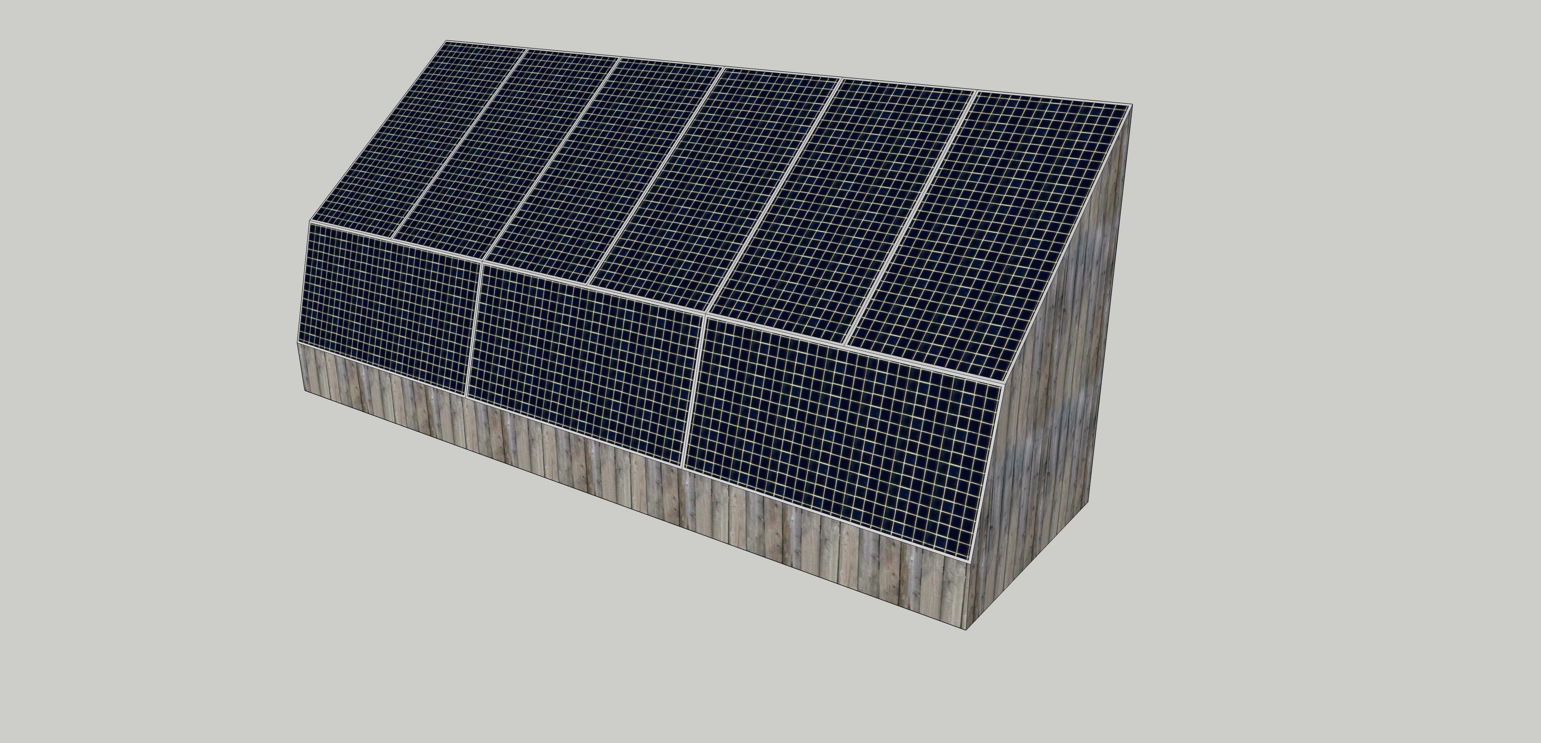

OK I am settling on a design.
Assuming that I can erect 12m2 of ground mounted PV within permitted development, I'd be putting up a structure that's 3m tall at the highest point, and which would have six 590w panels along the top at a 39° angle, plus another three horizontally along the front at 74°. I've arrived at these figures after spending a few hours farting about with PVGIS and I think they're optimal. It does take me slightly over the 12m2 footprint but I don't think anybody would notice, and if they did, I'd just have to bring those three extra panels all the way to vertical. I'd have a 3.68kw inverter for the top panels, and a 2kw one for the extra three.
The array would be mounted out behind the house, at a distance of around 20m.
Where's the best place to put the inverters? I could see it being fairly easy to build an enclosure under the panels. Then run SWA down to the house?
Are there any rules that need to be followed about building the structure? I could obviously just use wood but perhaps unistrut would be longer lasting. Inevitably I'd be very tempted to box it in underneath, lots of people seem to do that.
If fully boxed in, it would look something like this:
Why 2 inverters? You'll need DNO permission with potentially more than 3.68kw of export.
Put the lot on a single inverter. Most/lots of inverters can have way more DC input power than the headline power rating
If you enclose the underside then it's no longer a ground mounted PV array but a building clad in solar panels so any planning limits would be those for a garden building rather than a PV array....not sure of Scottish rules though!!

You need to be careful with voltage drop on the AC side. The inverter can trip if grid voltage is high and you have a voltage drop. You are better taking the voltage drop on the DC side.
Turn into a shed, then it's not a ground mount array.
I thought I'd need a second inverter because the extra three panels will see quite different conditions. Maybe I'm overthinking it. Tbh they don't add a huge amount, it would be easier just to stick to the main array of six.
