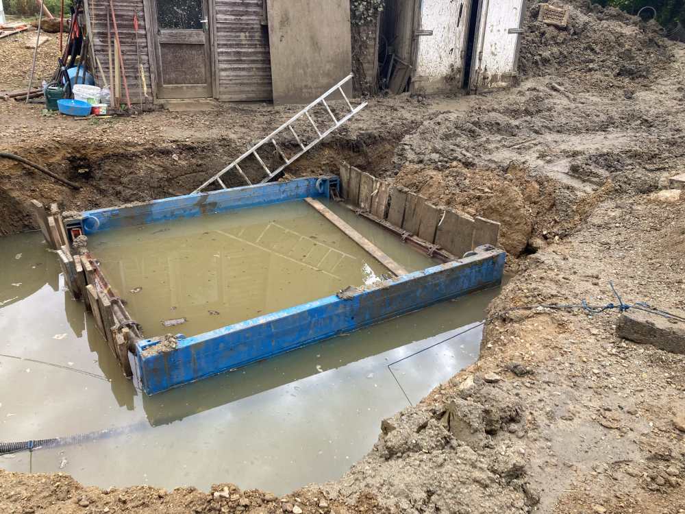

Russell griffiths Posted Sunday at 18:57 Posted Sunday at 18:57 side loads can be controlled with good shuttering, pumps are essential, plus a spare pump, and a spare pump for the spare pump. I actually had two submersible pumps running as we filled with concrete,both these pumps are still in the ground buried under 4 tonne of concrete. we started digging without the box shuttering and had to stop work and re think and come back to the job with some proper kit. 1

Russell griffiths Posted Sunday at 20:28 Posted Sunday at 20:28 Concrete depends on if you are filling a wet hole or dry hole, I still had water coming in that was being pumped out at the same time, if I turned the pumps off it would be 1m deep in an hour. so concrete was bone dry mix out of a truck that mixes on site, like a kerb mix dry just binding together, I filled the hole burying the pumps and kept them running, I expected them to stall out or blow a fuse, they just kept pumping and I watched the outlet hose, when it slowed down and looked like I was pumping concrete water I turned them off and cut the hose and leads of and carried on filling with dry mix. 1

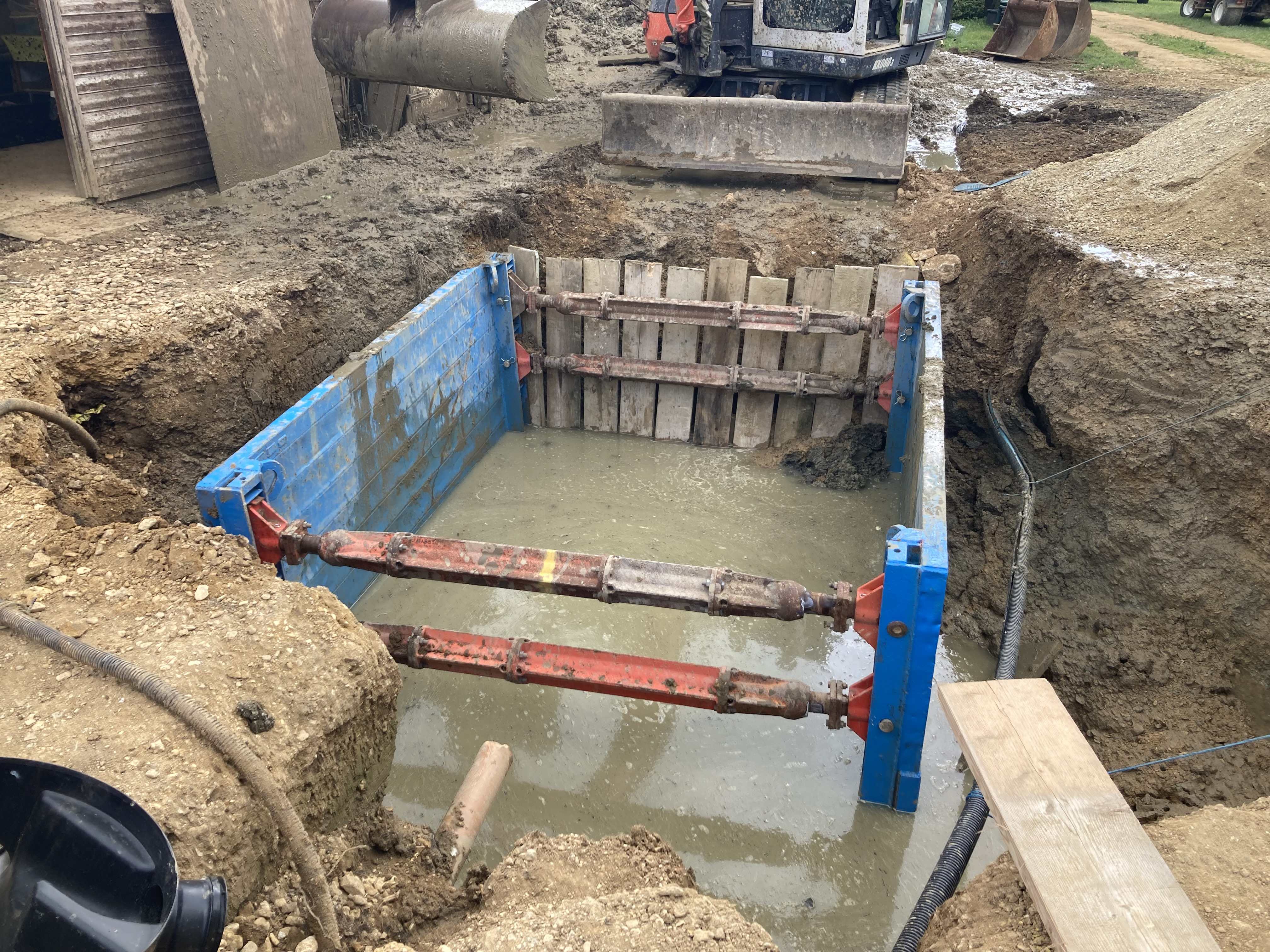

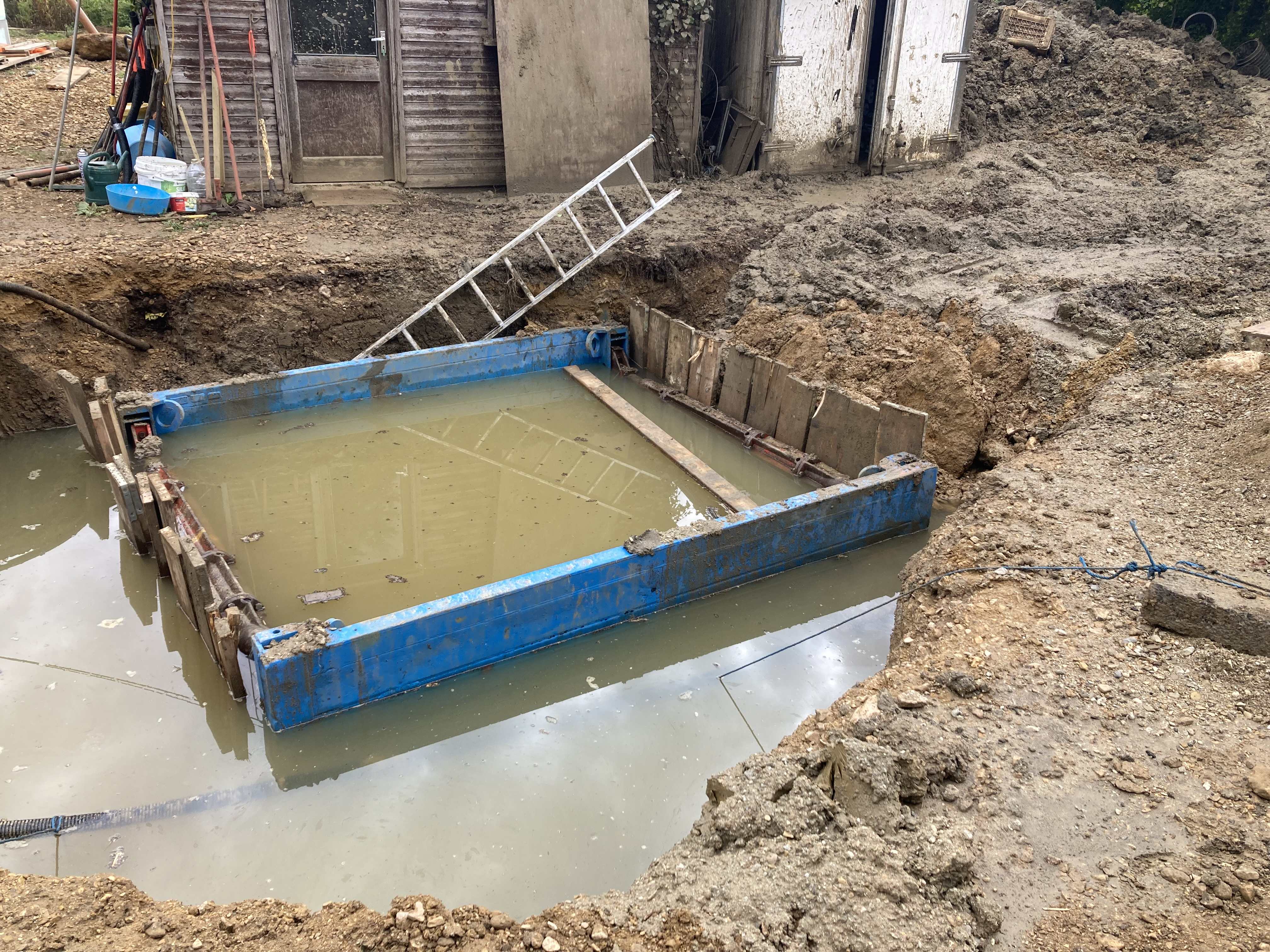

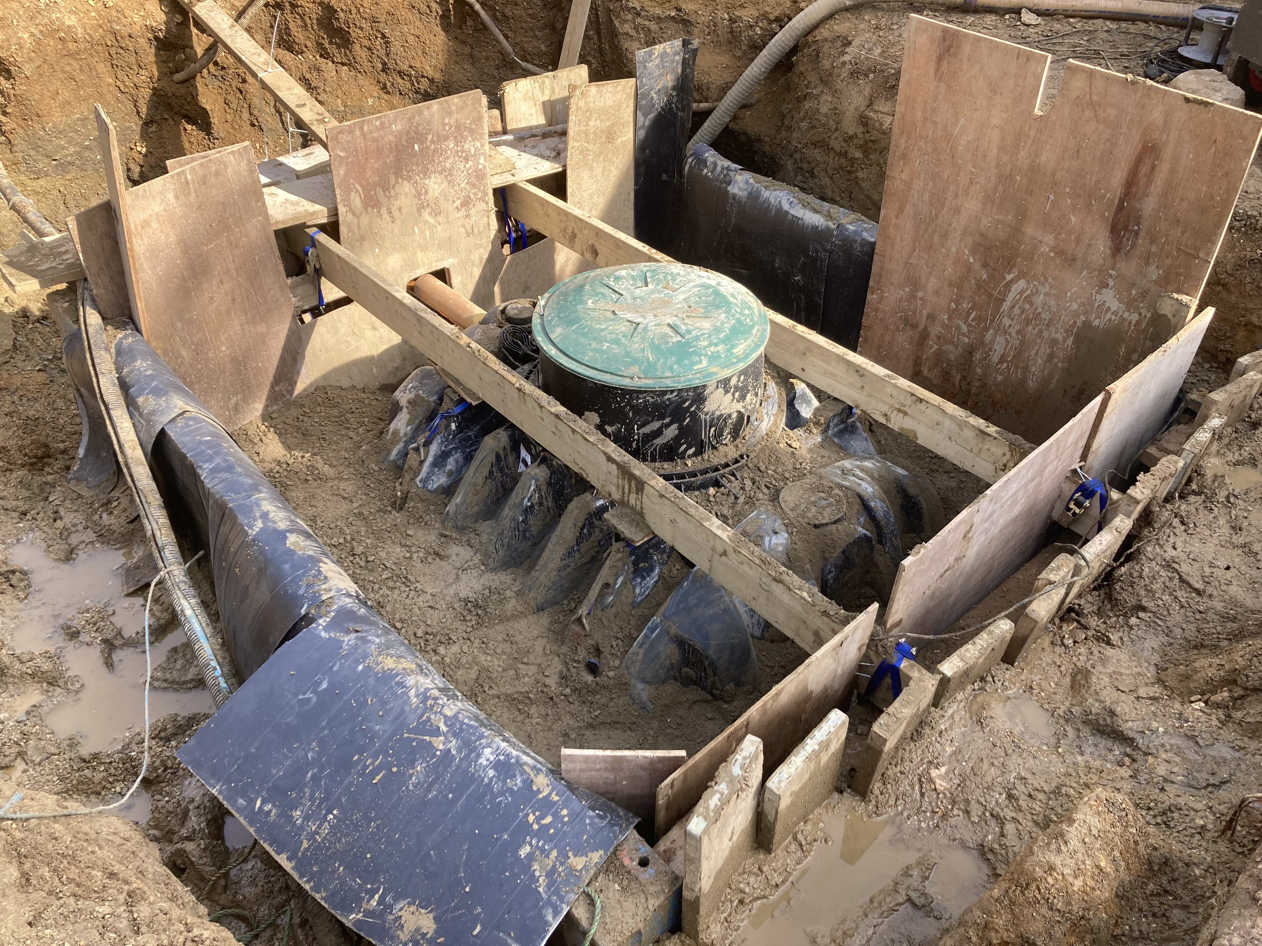

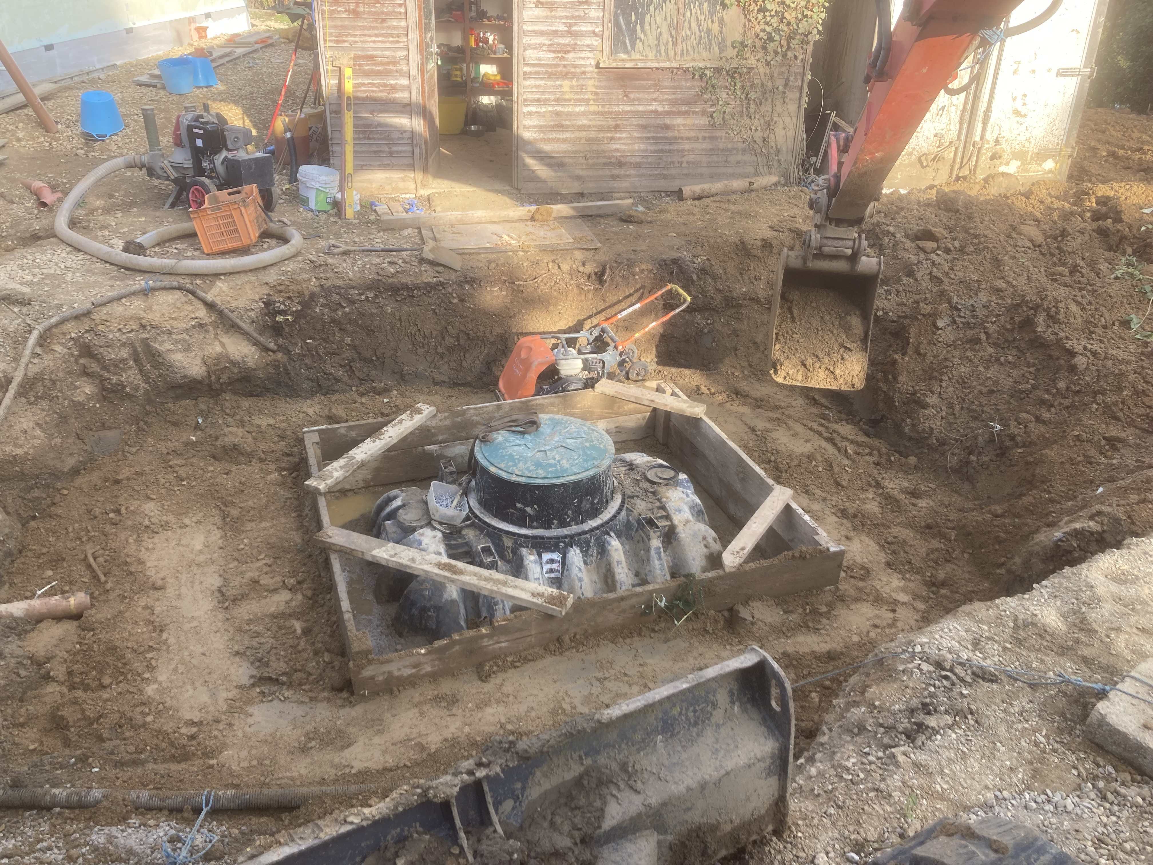

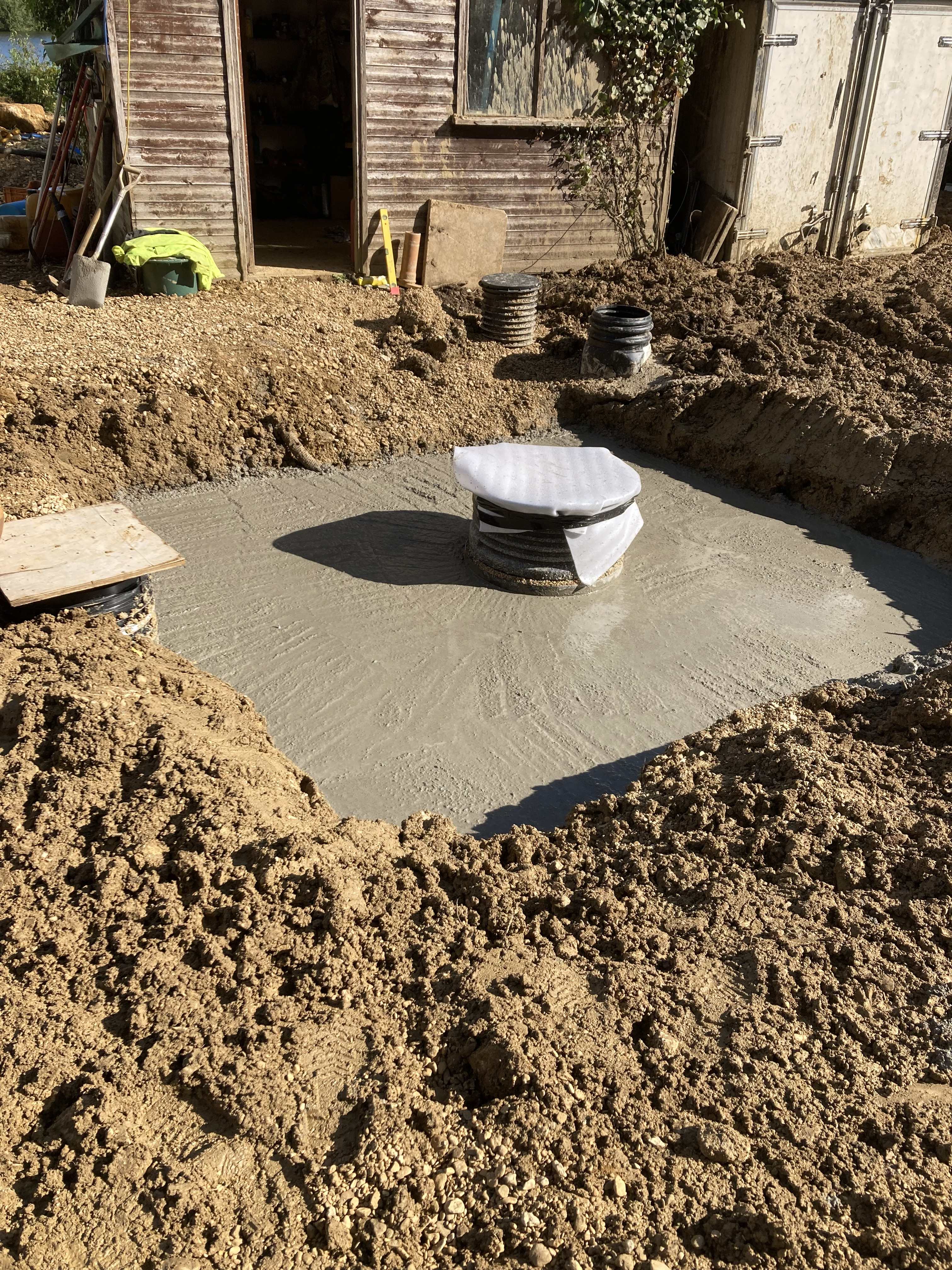

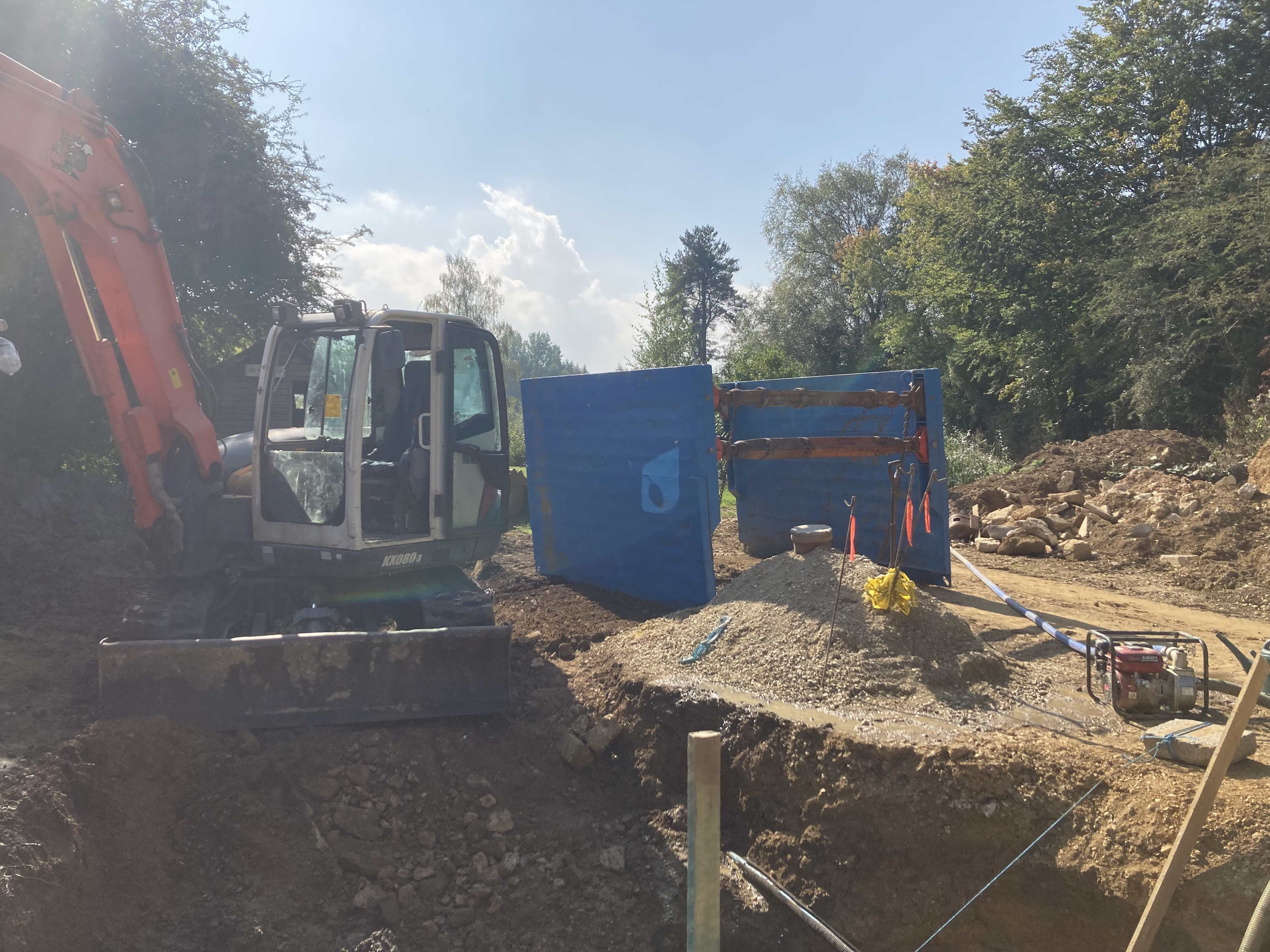

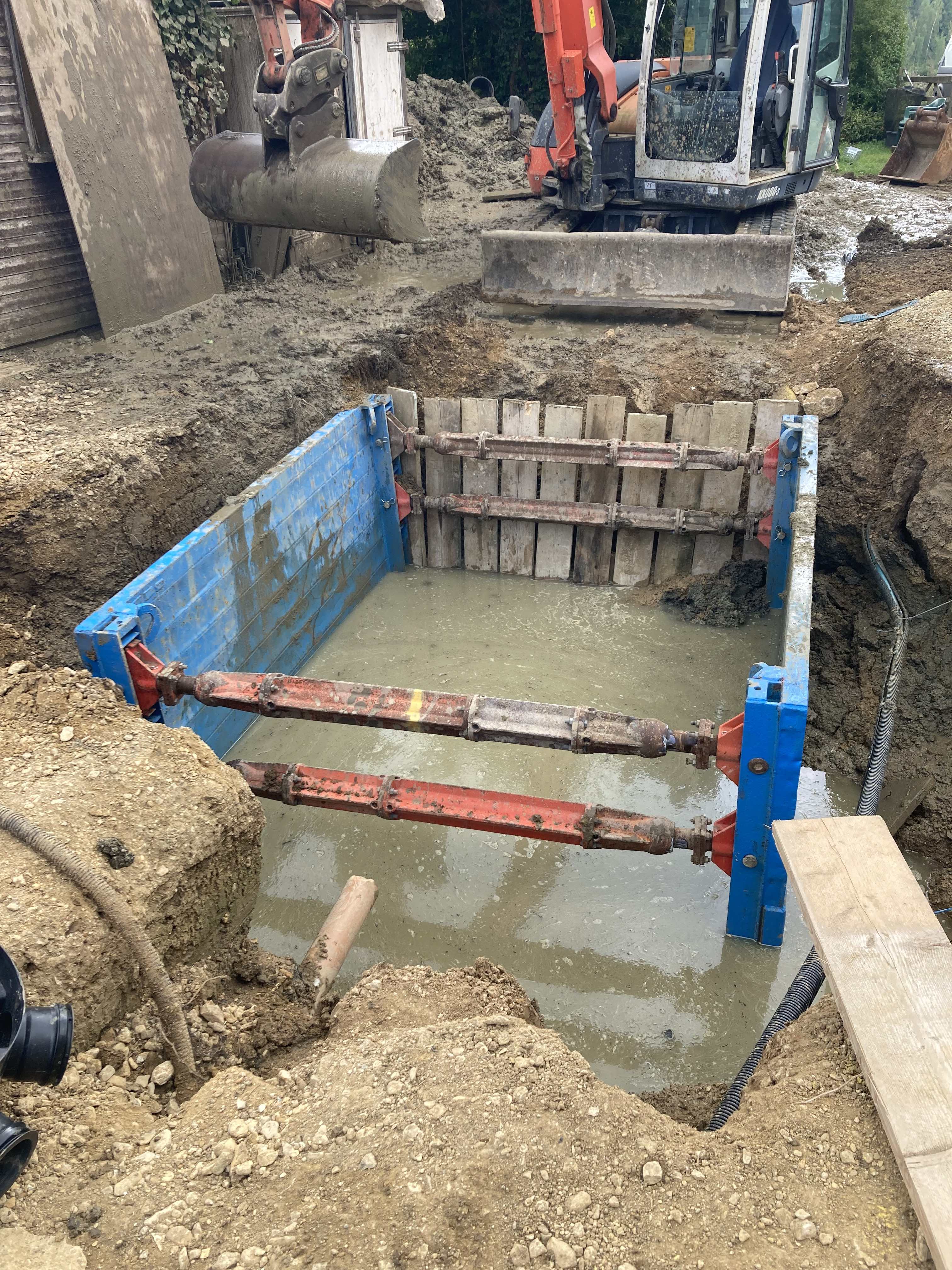

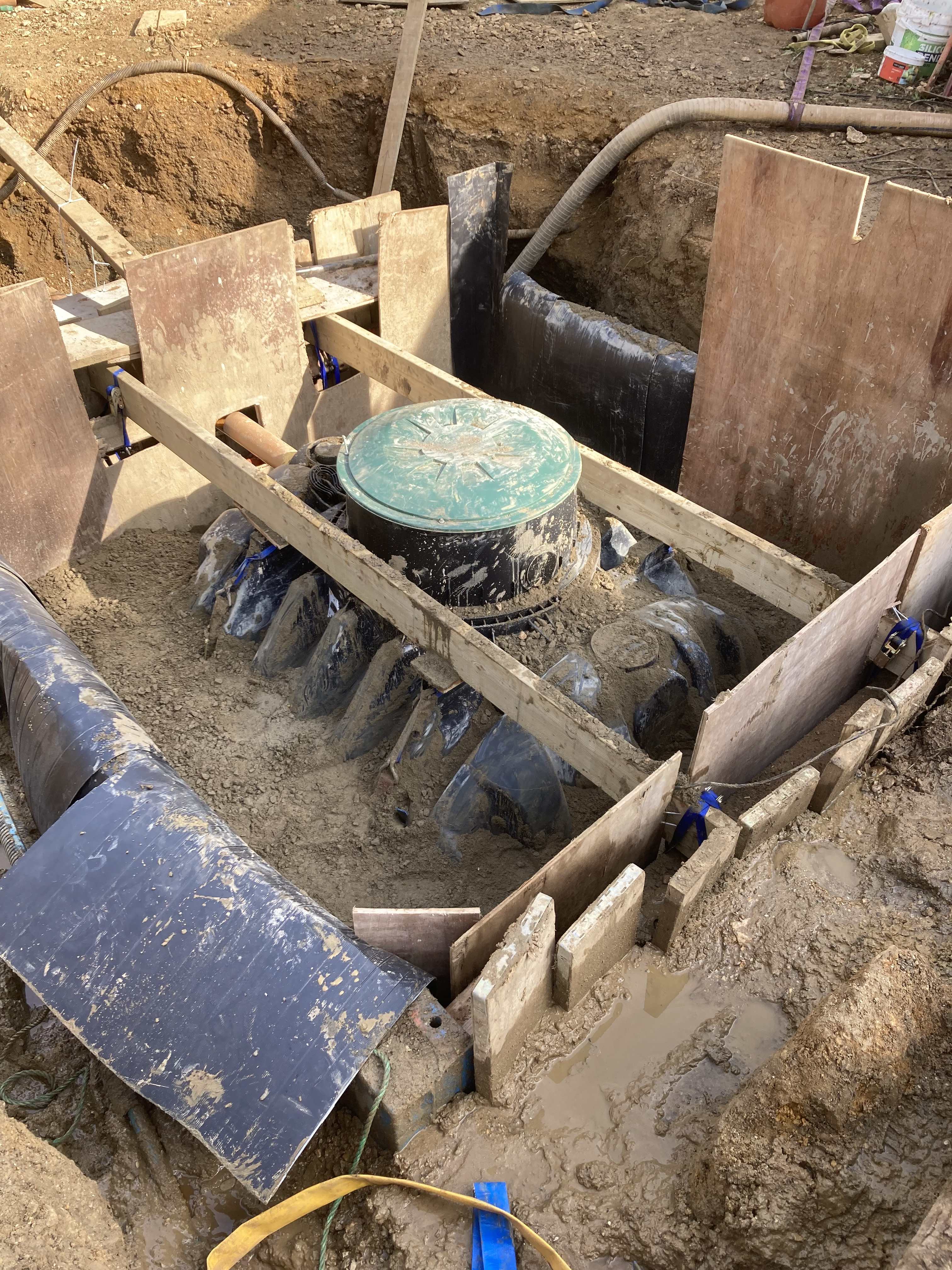

Russell griffiths Posted 17 hours ago Posted 17 hours ago this is the highest it got probably about 750 below ground level timberbracing on top of the tank to hold it down and keep it all level while concrete was put in
Arrenite Posted 15 hours ago Author Posted 15 hours ago @Russell griffiths thanks a lot for the photos Russell ! Am I right in thinking that you created a concrete box around the tank and then filled that with concrete? Cheers Dave
Russell griffiths Posted 13 hours ago Posted 13 hours ago 2 hours ago, Arrenite said: @Russell griffiths thanks a lot for the photos Russell ! Am I right in thinking that you created a concrete box around the tank and then filled that with concrete? Cheers Dave No. The tank was placed inside that blue trench box the trench box was lined with plastic sheets to prevent the concrete making a mess of the trench box and me having to power wash it all off. the concrete was placed inside the trench box and vigorously stamped down around the tank. the next day I dismantled the box and pulled it out of the ground. then I back filled the gap the box took up and used a wacker plate to firm it all up.
Russell griffiths Posted 12 hours ago Posted 12 hours ago (edited) DIG BIG HOLE. Edited 12 hours ago by Russell griffiths
Russell griffiths Posted 12 hours ago Posted 12 hours ago (edited) PUT TANK INSIDE TRENCH BOX AND FILL WITH DRY CONCRETE. Edited 12 hours ago by Russell griffiths
