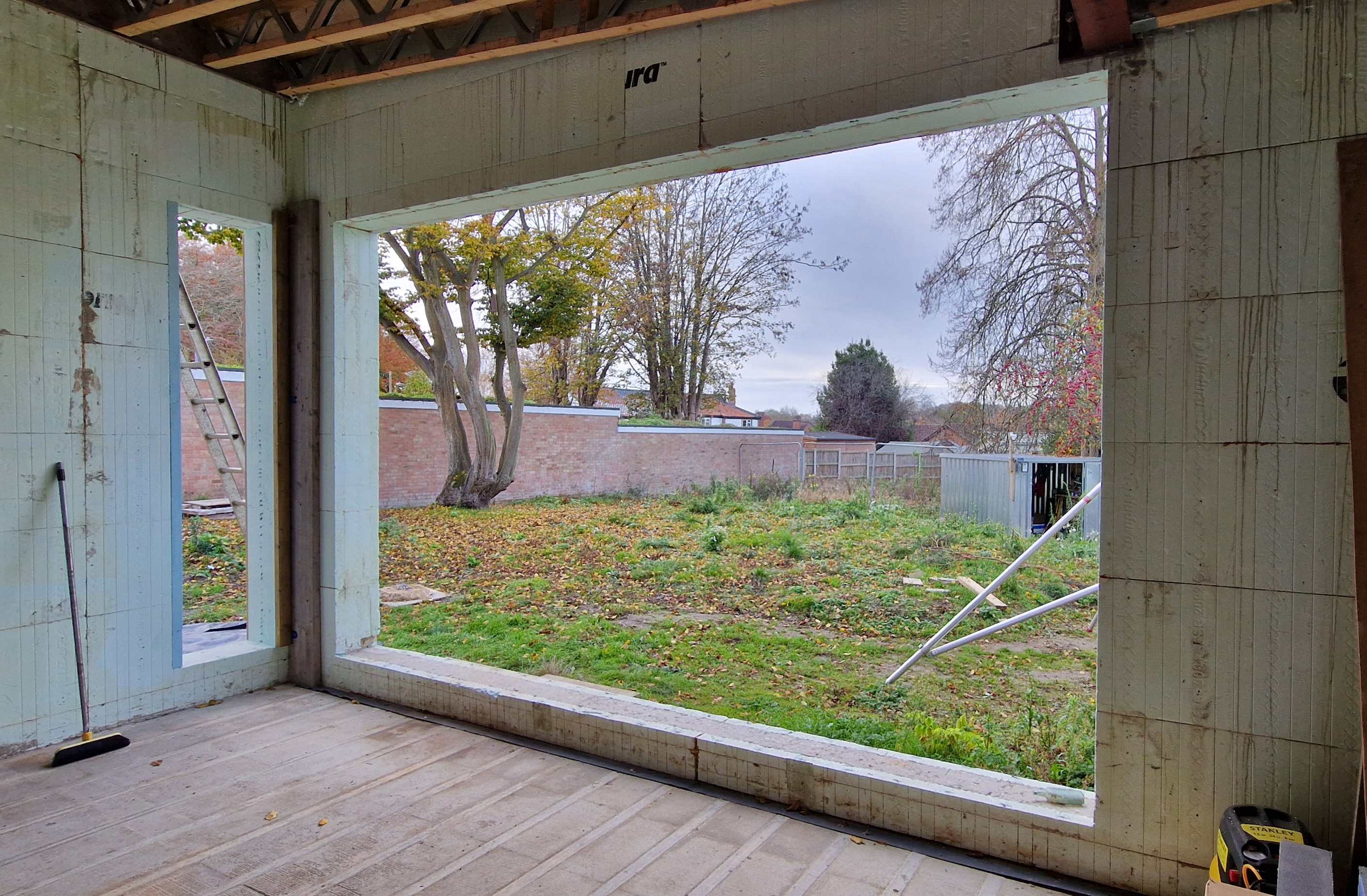

Just wrapping up the final stages of preparation for ordering our windows. Those of you that have done an ICF (particularly Nudura) build, did you install your windows directly into the Nudura openings with their EPS closers?
I have removed the EPS from the threshold of the openings for our 2 heavy sliding doors, they will be mounted onto the concrete, but how about the rest of the 'normal' windows and doors?
This is one of the larger openings, it's about 3.5m wide and the window will weight about 350kg.

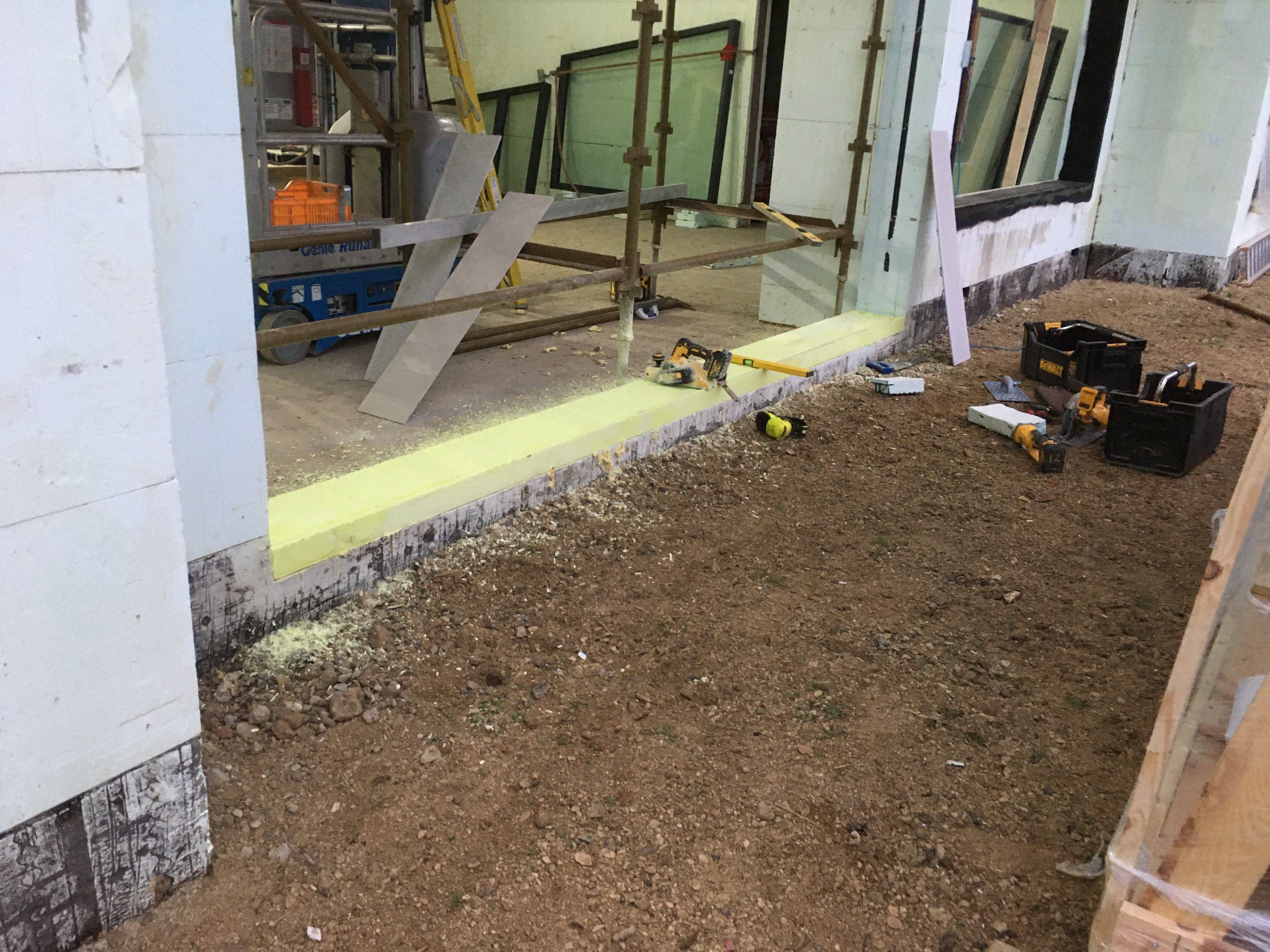

Look at kingspan green guard 500. I put that under our doors. IMG_1141.thumb.jpeg.179dba77924b67af87ee50648f401556.jpeg
Yes, my ground floor slider is 4.2m wide, 2.5m high, its about 750kg. I've stripped the top closer away to the concrete, but the profile is deeper than the 150mm core. I've got to extend the load bearing face rearward and I'm planning to use something like GG700 for that, but it'll be a 200x200 section, so pretty hefty.

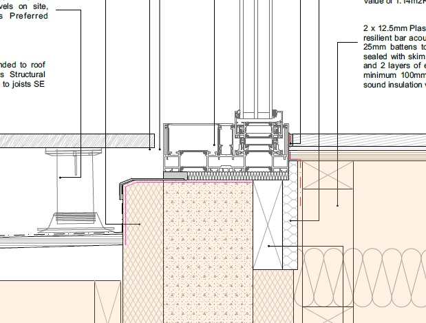

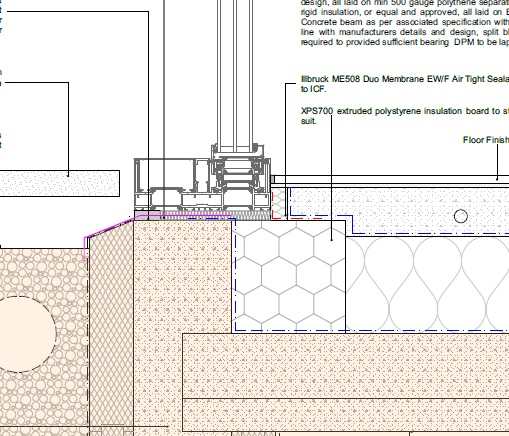

This is the best I can come up with for the Ground Floor, a 200x200 block of XPS700 installed up against the inside of the concrete core. (I have lowered the concrete now to make the door fully flush, though this isn't shown on this detail).
Apparently, it needs to be a deep as it is tall ideally, not sure why, hence the oversize of it. The overhang of the door is actually only about 30mm or so. This still seems tricky to install because the XPS700 and door will have to go in before the rest of the insulation and screed etc which would have pinned it into place.
I don't really want to put the DPM and PIR in for the floor until after the doors are fitted, but what to do where it laps under the door threshold?

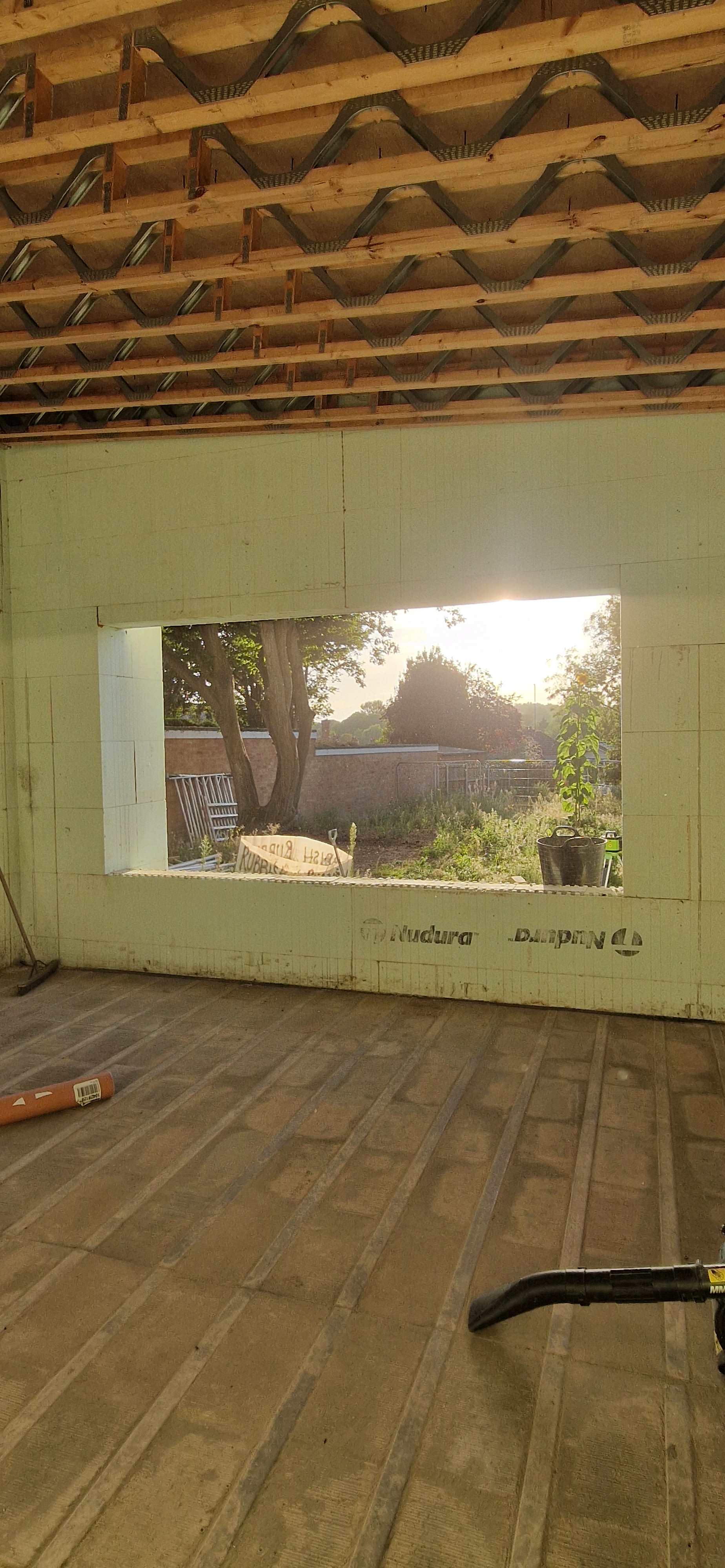

My windows are all sitting on the EPS cavity closer in the middle of the ICF block.
The largest window is 2730mm x 1750mm.
They are aluminium frames, with 190mm cills. 27mm thick double glazed units, weighing approx 25kg / m2.
Thermohouse EPS is slightly denser than Nudura at 24 kg/m³ vs 21 kg/m³.
For reference Marmox XPS shower formers have a density of 36 kg/m³.
They have been in over 3 years and seem to be alright.

Your detail there seems way OTT to me! Is that what your SE told you to do for a window?! :S
Posted
That's a Sunflex SF80 Triple-Glazed Slider. The one on the Ground Floor weighs around 750kg (4.2m long), the First Floor one is probably about 400kg.
The SF80 profile is 210mm, the concrete core is 150mm. The supplier would not approve installation where the frame was not fully supported. In all fairness, the timber add-on was pretty easy, it's yet to have a layer of insulation over it that will lap up the back of the frame.

Ground floor one is sat on your slab, so zero issue there?
Upstairs one can be sat on something like Compacfoam or Bosig, as the weight is at the centreline of the glass and frame, so around 100-150mm of ‘meat’ at the ICF core is already ample. Spread out over the core and the EPS means 400kg is lost across the surface area with complete ease.
The detail in your above section shows this half over structure and half over EPS block, so you should have the same detail for the window openings afaic.
I’ve never done / seen timber bolted into the ICF core for a window before.
Posted

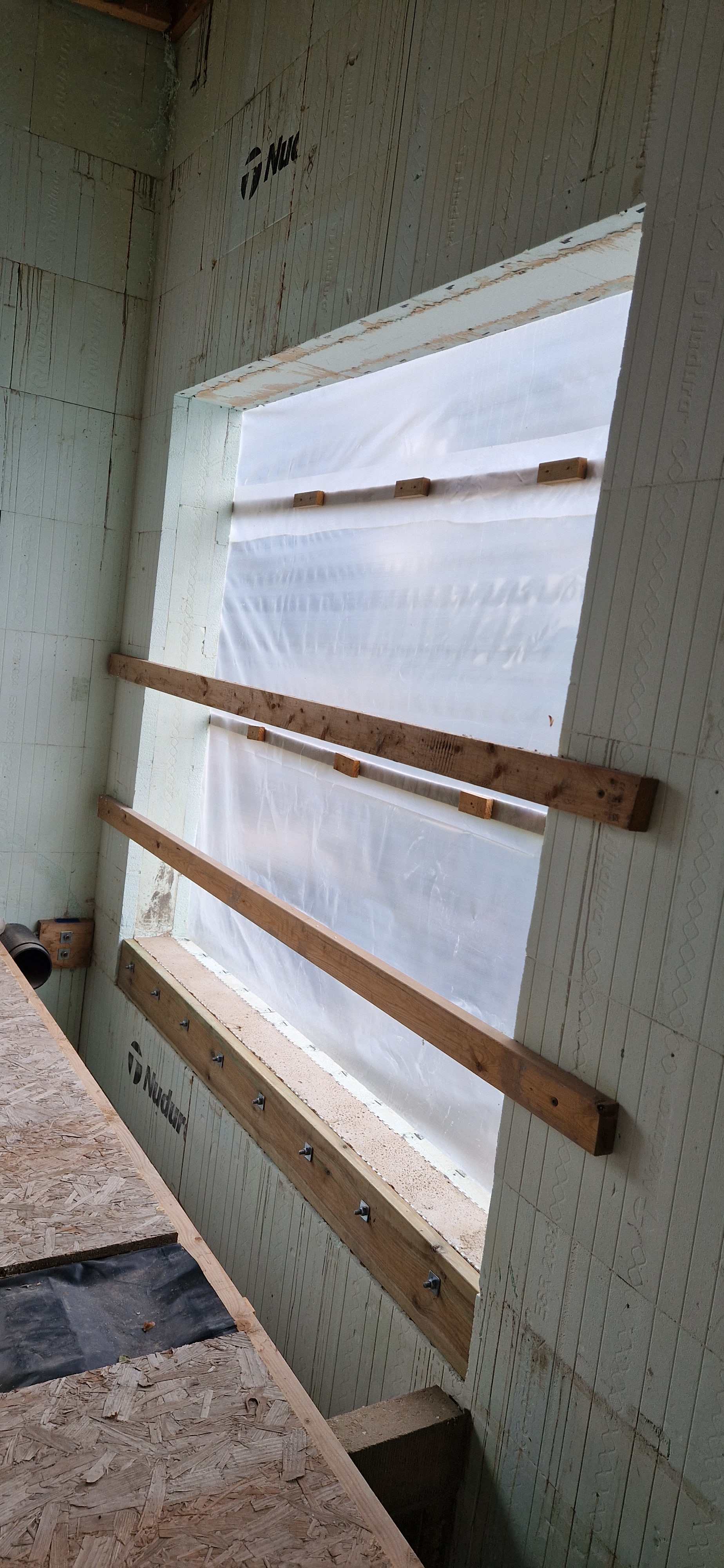

To clarify, the photo is of the first-floor sliding door position. The architectural detail is of the ground floor position, where the core of the concrete is abundantly strong. As you can see from the detail, the majority of the triple-glazed sliding leaf overhangs the concrete and onto what would have been the EPS inner skin of the Nudura (which apparently does not have the compressive strength for the weight it would be subjected to). ID Systems (the Sunflex installer) wants the door to be fully supported and do not consider the EPS to be sufficient. The Architect suggested a 15mm layer of Bosig Phonotherm laid flat over the concrete for the door to bear onto. This would still overlap onto the "insufficient" EPS, but significantly would have required me to take the concrete (C35) down by ANOTHER 15mm (I had already taken it down by about 20mm to allow for a fully flush installation, which took me several days and I was VERY pleased with the finish).
The ground floor is Beam & Block and so it is a case of either widening the load-bearing width of the concrete core or transferring the load down to the B&B with a media that has sufficient compressive strength. It could theoretically have been a length of RSA resin bolted to the inside of the concrete core to provide a platform on which the rear portion of the door could sit, but that's not the most thermally efficient solution and I'm not sure it's smart to have a piece of steel in the subfloor like this.
This is the ground floor position. The inner Nudura EPS skin is still in place and it is that I, apparently, need to remove and replace in order for ID Systems to be happy to install the door...
Obviously we have a layer of PIR to go into the floor yet and that detail essentially replaces an outer band of the PIR with a lump or XPS700 that the door will sit partly on. It's just a little confusing to think of how to implement it!
In the first floor position, we did not have the benefit of anything structural beneath the inner Nudura EPS insulation, which goes all the way down to the ground. Steel RSA was proposed here again, but timber was also an option, which was far easier to implement. My SE knows that I prefer overkill and might be pandering to that.
This is the first-floor detail, it leads out onto a balcony.
