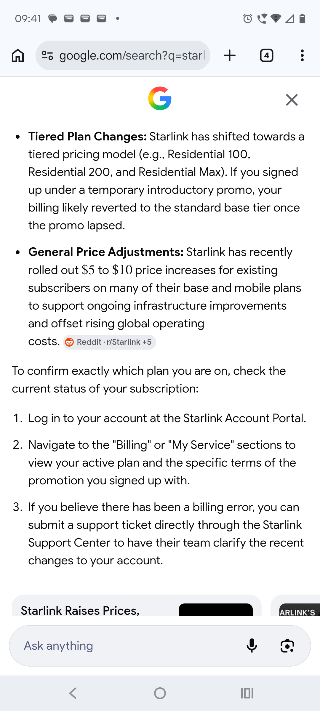

Gone West Posted May 17 Posted May 17 (edited) I've just had notification from Starlink that my monthly payments are increasing to $40 (~£30) from next month. I thought when I signed up that I was getting the first six months at £25, and then onwards, £35 a month. There is no record of that agreement as it was on the order form that I filled in. So now I have actually paid £23 a month for the first three months and I will then be paying ~£30 a month. I hope it doesn't keep creeping up. Just a warning to others to keep a record of any agreements. It is a rolling monthly agreement so I can cancel at any time. Edited May 17 by Gone West
Onoff Posted May 17 Posted May 17 40 minutes ago, Gone West said: I've just had notification from Starlink that my monthly payments are increasing to $40 (~£30) from next month. I thought when I signed up that I was getting the first six months at £25, and then onwards, £35 a month. There is no record of that agreement as it was on the order form that I filled in. So now I have actually paid £23 a month for the first three months and I will then be paying ~£30 a month. I hope it doesn't keep creeping up. Just a warning to others to keep a record of any agreements. It is a rolling monthly agreement so I can cancel at any time. Do you have any email confirmation from sign-up that might reference the £35 ongoing price, even indirectly? Sometimes the promotional rate appears in an order confirmation even if the form itself is gone.
