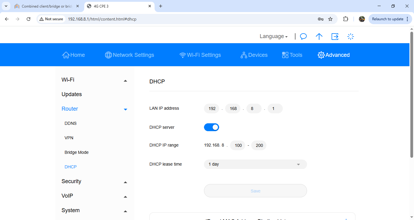

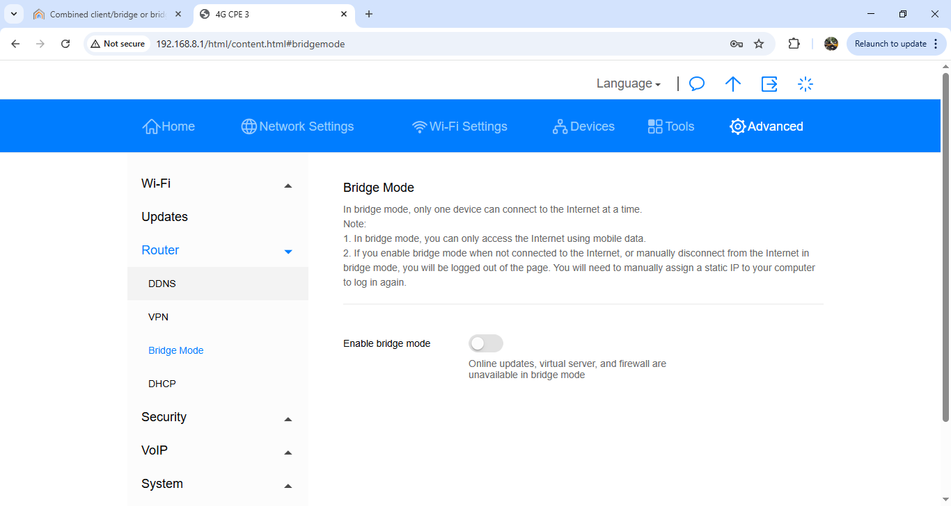

MortarThePoint Posted November 13, 2025 Author Posted November 13, 2025 (edited) On 05/11/2025 at 14:28, -rick- said: Have you reconfigured this router to act as a bridge or is it still acting as a router? Generally when you plug something into a WAN point the router will apply NAT/firewalling to that network and create a separate network with it's own DHCP, etc, on it's end. This may cause issues down the line if this is not what you intended. I tried disabling the DHCP server in the Router menu hoping that DHCP requests would make their way to the original router, but sadly not. It isn't obvious how to have it act as a switch. There is a Bridge option, but it says it only supports one device at a time and has to use mobile data. With it acting as a Router (inc DHCP server) I can happily RD to a machine on the other network as well as shared drives Edited November 13, 2025 by MortarThePoint
-rick- Posted November 13, 2025 Posted November 13, 2025 The simpliest way should be to disable DHCP, make sure the IP address on the router is set to something that doesn't clash with the rest of your network (on the same IP range/subnet) and then move the ethernet connection from a WAN port to a LAN port. That should be it. 1
