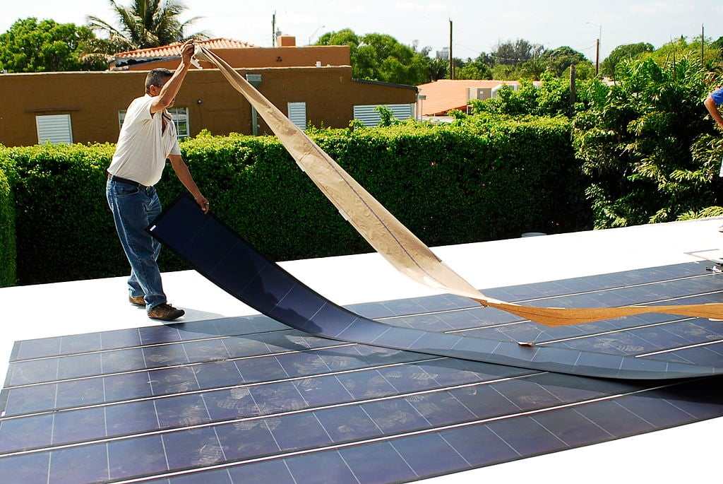

JohnMo Posted October 31, 2025 Posted October 31, 2025 What about thin film flexible panels, they come self adhesive backed. Would (select the correct size) fit between the seams. You can get them about 5m long - downside is price.
-rick- Posted October 31, 2025 Posted October 31, 2025 3 minutes ago, JohnMo said: downside is price. And lower generation per m2 and somewhat unknown/poor reputation for longevity.

SimonD Posted November 5, 2025 Author Posted November 5, 2025 On 31/10/2025 at 12:36, JohnMo said: What about thin film flexible panels, they come self adhesive backed. Would (select the correct size) fit between the seams. You can get them about 5m long - downside is price. I spoke to my solar people about this and they're not keen - apparently they don't like the potential heat build upon the system with the metal roof. Unfortunately I can't comment as I just haven't had the time to do the research myself and form a view on it!
