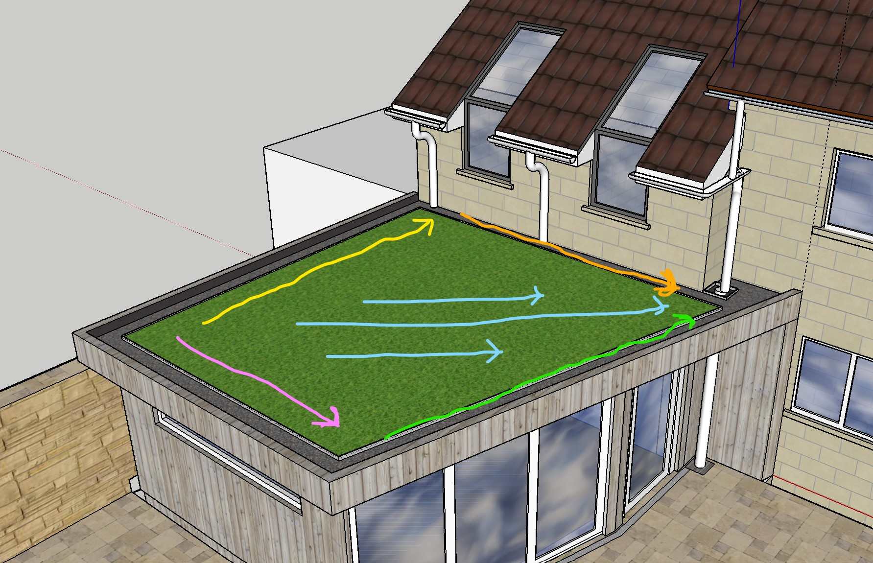

I am building a single-storey extension with a green roof. I want to understand the best way of managing the falls. The attached image shows the proposed extension against my existing house. I already have a downpipe in the angle of the main house on the right hand side with all the associated manholes etc beneath it, so I want that to be the lowest point of the roof with a suitable drain to take the water from the flat roof. There are a couple of other small gutters which would need to discharge onto the roof and be directed into the same drains. I think that there are 3 ways of laying the falls:
- have a channel (with fall) along the edge of the house (orange), taking the existing downpipes to the drain in the corner, and have the rest of the roof laid to fall in the yellow direction.
- have a channel (with fall) along the front of the building (green), with the rest of the roof laid to fall in the pink direction.
- lay the falls in the blue direction between the left hand corner of the roof and the opposite corner where the drain is.
Is there an obvious answer of which is best, please?
Is it worth using tapered insulation boards, or stick to firrings with a board overlay?
Ancilliary question: In the past I've seen something like a downpipe that goes through a flat roof, taking water from above and guiding it through the roof, while also allowing water from the flat roof itself to enter the downpipe from a hopper in the flat roof, but I now can't find anything like it. Does such a thing have a name? I've drawn what I think it should roughly look like in my diagram.
thanks,
dan.
With the proposed falls are you simply inviting trouble. Any blockages from autumn leaves etc could lead to water accumulation at the house interface. Possibly water in the house. You would never slope a patio towards the house, so why would you do that with a roof?
I would be sloping away from the house, simple and safe.
For me the starting point is to look at the underlying structure. While I'm an SE and will design beams and slappings all day long, if you pay me it's not that great as it's your money.
I think. What kind of opening are we making into the existing house. More load from the flat roof can = more money on structure you don't get any benefit from.
Once you nut that out you can then look at the insulation levels you need. Roughly your glass area does not look too large once you take into account the area of existing openings you are building over, relates to the U value calculations.
I would aim for the simple stupid. Modern PVC type roofings are much more forgiving than traditional felt roofs, there are a few pitfalls, but lets run with it for now.
Given the shape of your extension the main run of joists and fall is likely boundary wall to glazing line. So concealed gutter above the glazing.
Run that back as you have shown to the internal corner.
I like green roofs, but they need looking after. Also, on warm roofs they are great for sound proofing.
To resolve the issue of excess water collecting against the house introduce a water gate, so if the puddle gets more than 25mm deep the water will pour over the side of the building, you'll see that and know that there is a blockage. This is standard fare on industrial buildings with valley gutters.
Your model is a good start. Add to it and put a 1.0 degree fall on the roof and see what it looks like.
It does work but if the builder makes one mistake then you have a problem. Timber firrings are much more forgivable and can accomodate,up to a point late, design changes, could be a roof lantern in your case.

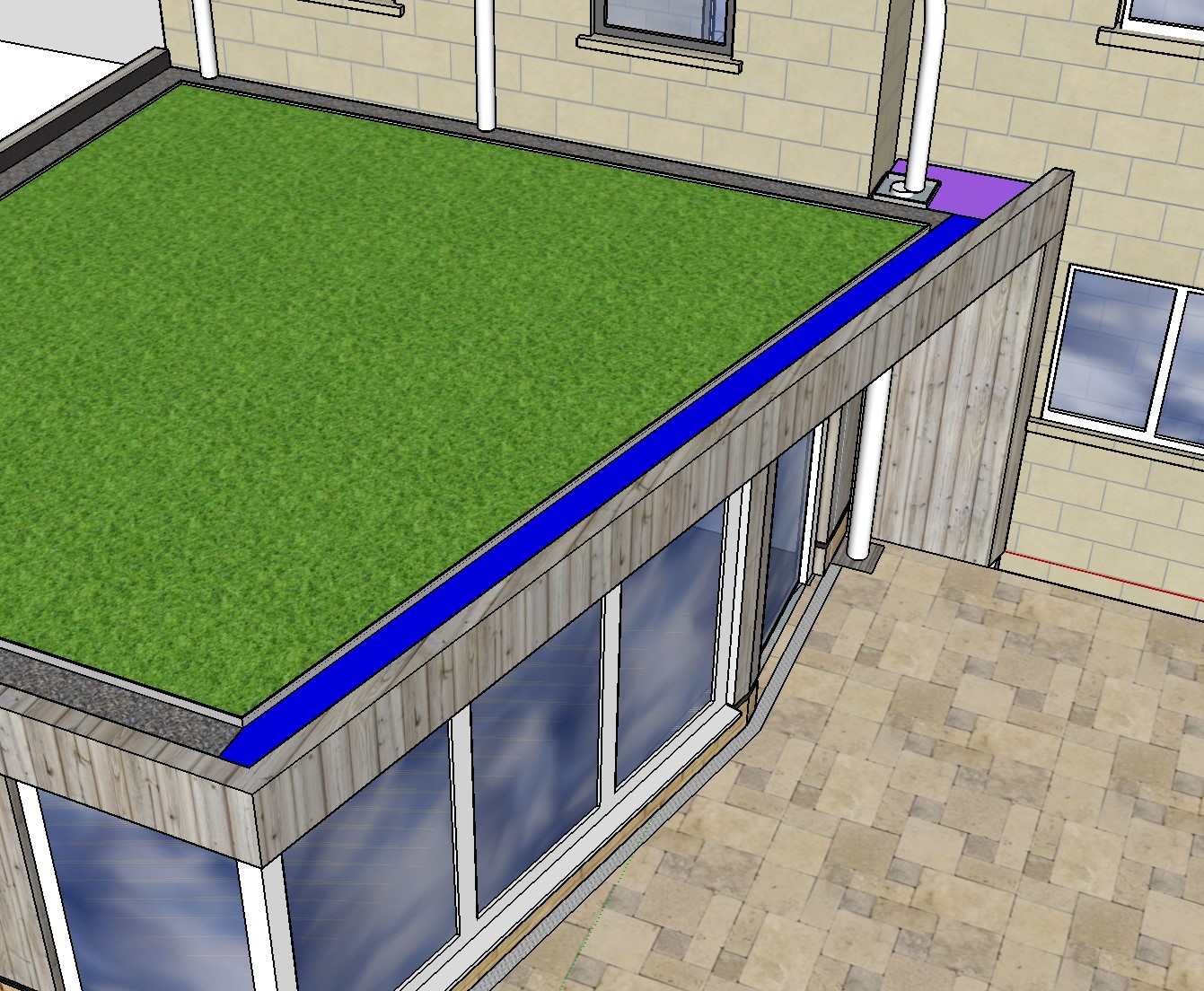

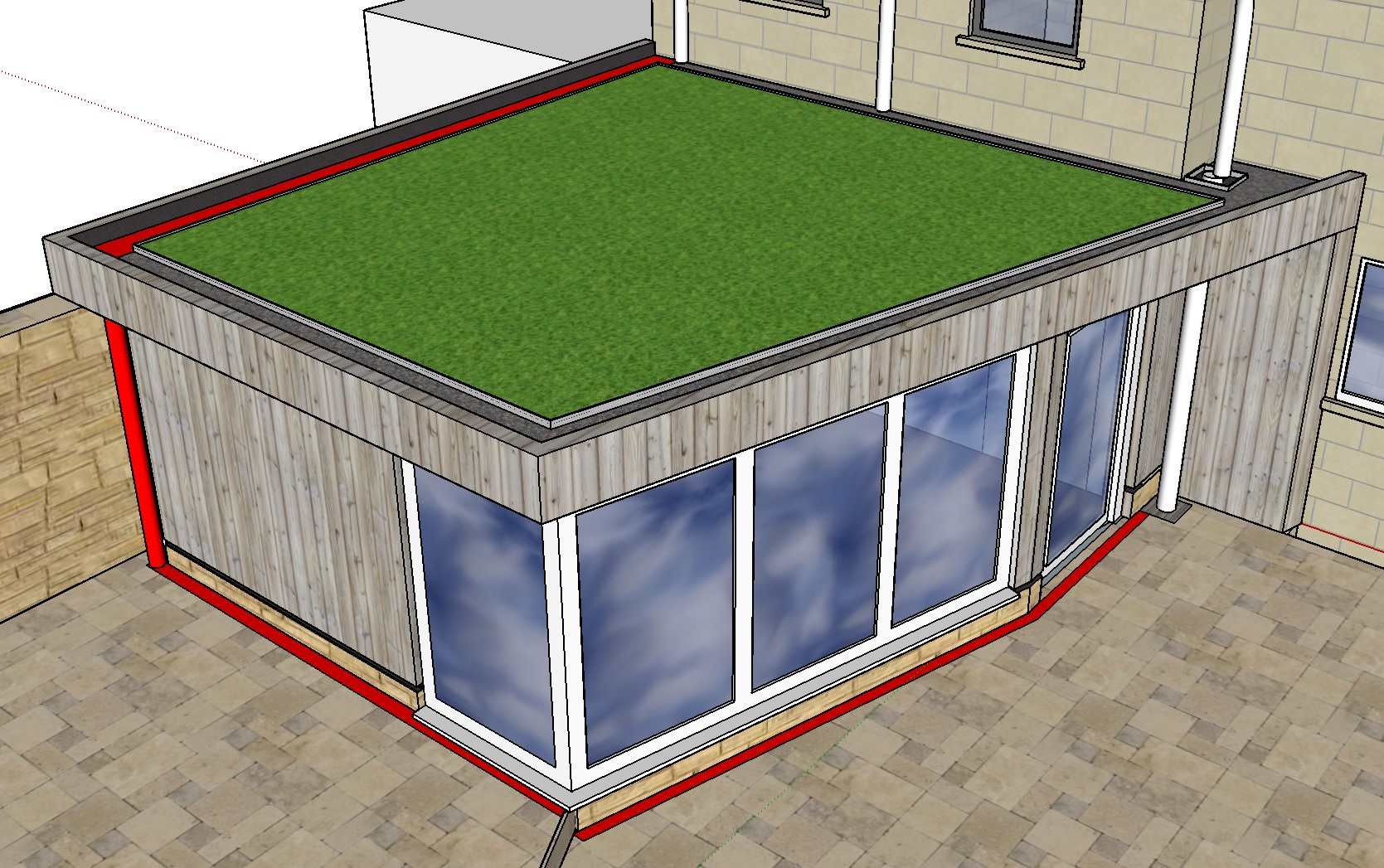

@Gus Potter Thanks for the interesting link to the privacy document. I've already got planning permission, so I'm going to stick to the dimensions I gave in that.
I've been using the terms internal, hidden or concealed gutter, but maybe they have specific meanings. What I suppose I really mean is a conventional green-roof gutter
 (e.g., https://radmat.com/eshaflex-green-roof-edge-detail-5/), with a wooden trim hiding the actual gutter from view. The underside of the trim could have vent holes so that even if the gutter overflowed it wouldn't fill up the trim, and overflows would visibly drain out down the face of the building, not inside it. As it would be concealed from view it could be oversized. Would that work, or is that still prone to problems? I don't have any tree near enough to cause leaf blockages of the gutters.
I've been playing around with the details of putting the gutter along the front or back of the building. I've attached two drawings showing the routes.
If I went with the red route, the roof slopes toward my neighbour into the gutter, then via a downpipe into a slot drain running around the perimeter of the building. I need a slot drain anyway for the glazing (which might turn out to be lower than I've drawn it).  From what I've found out about slot drains they are allowed to be dual purpose like this, and it should easily carry the volume of water, especially if the green roof is slowing the water down too. Being on my neighbours side would make cleaning the gutter, and seeing any blockages, a little harder.
If I went with the blue route the roof would slope towards my glazing and into a gutter running above the glazing.  I could make the entire section in the internal corner of the house essentially a big hopper (the purple box) with an overflow and a grill on top to allow stones to conceal it.
Do both proposals work? Is there a reason to prefer one over the other? I could build either within the dimensions set out on the plans.
For the downpipes off the main roof, would it be sufficient to put an open box gutter (e.g., Lindab's rectangular series) on the roof surface to catch the water and direct it to the nearest gutter, or would it be better to have a solid pipe connecting the bottoms of the downpipes to the gutter?
Thanks as ever.
I think my previous comments all still apply. Your internal gutters must be made for the purpose, ie not intended as external gutters. So it is a formed shape, sealed with roof membrane. And overflows
