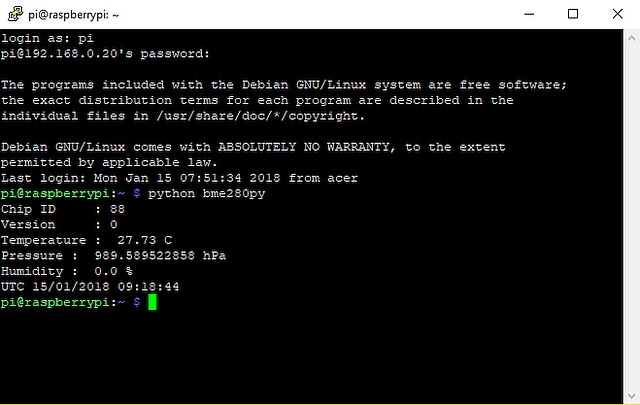

SteamyTea Posted January 15, 2018 Posted January 15, 2018 (edited) Dug out my BME280 sensors and fixed them up to my RPi Trouble is I am not getting a humidity reading. It would also be nice if it was easy to use the SPI bus rather than the i2c one. I have the RTC on that and one BME280. If I plug in another BME280, it gives gibberish readings for the air pressure. How easy is it to make something that can cycle though the sensors, maybe just by switching the Vcc in and out. Edited January 15, 2018 by SteamyTea
Jeremy Harris Posted January 16, 2018 Author Posted January 16, 2018 (edited) Not sure why you're not seeing the data from all three registers in the BME280. By default it uses all three when taking a reading, so it comes down to your code. I've never used high level stuff to do this, I've always used the raw I2C commands to just read the registers, then done some bit manipulation to get meaningful values. There are several modes in which the BME280 can be operated in at the basic level, which each being best suited to a particular application. The native resolution is high, but it includes the ability to oversample to reduce noise, and also includes an IIR filter to smooth the data if a fast response time isn't required. I think you probably need to look at the I2C write commands that are being sent to the BME280, both to set the initial operating mode and to ensure the data is in the registers, ready to be read using the I2C read commands. All three sensors in the BME280 can be configured to be enabled or skipped during initialisation, and it seems like that the I2C write commands you're sending at initialisation may be disabling the humidity sensor. That may well cause the humidity register to be empty when you try and read it. Within the BME 280 there are several uniquely addressable registers, that are best burst read, starting at address 0xF7 and ending at address 0xFE (to read temperature, pressure and humidity). The data are read out in unsigned 20 bit format for temperature and pressure and 16 bit format for humidity, hence the need for bit manipulation after a data read to reconstitute the data into meaningful bytes an words. You also have to take account of the calibration constants that the device also puts out and use these to correct the raw data (each device has it's own calibration constants hard stored internally and read out with every full register read). Cycling though I2C sensors is dead easy, no need to mess about with turning them on and off. Each sensor has a unique address on the I2C bus, so will only accept write or read commands when they are preceded by that sensors address. As such you can select a sensor on the bus to read, send it a write command (if it needs it) to tell it to make a measurement, then read the data, when it's ready, using a read command. The same applies to one-wire devices, with the address being the hard-coded serial number of a particular device in that case. Some conventional serial data connected sensors can be uniquely addressed and accessed like this, some can't. The particle detector I've opted to use can't be uniquely addressed, so is going to use two data lines that are dedicated solely to sending and receiving it's data. Edited January 16, 2018 by JSHarris
SteamyTea Posted January 16, 2018 Posted January 16, 2018 I have just ordered a new RPi3 with wireless as I thought it may be down to using the original RPi1b. I am using the code written my Matt Hawkins, bme280.py. I have similar issues with the GPS module. It 'sees' it but can't get any data from it, just says it has 'no fix', which may or may no the the case. Shall give it a day or two break until I get the new 3.
Jeremy Harris Posted January 16, 2018 Author Posted January 16, 2018 It'll be a code problem, not a hardware problem, for sure. Even a 50p PIC can read the data from a BME280 and stick it up on a display, having corrected the data using the calibration factors that are built in. I suspect the code you have is not initialising the BME280 to enable all three sensors, or may not be reading the full register range from OxF7 to 0xFE in burst mode. It may well be just using the cut-down burst read mode from 0xF7 to 0xFC, which will only output data and correction factors for the temperature and pressure sensors. It may not even be reading the registers in burst mode at all, and according to the data sheet this is not recommended, because it may cause bytes to get mixed up if the registers are read one by one.

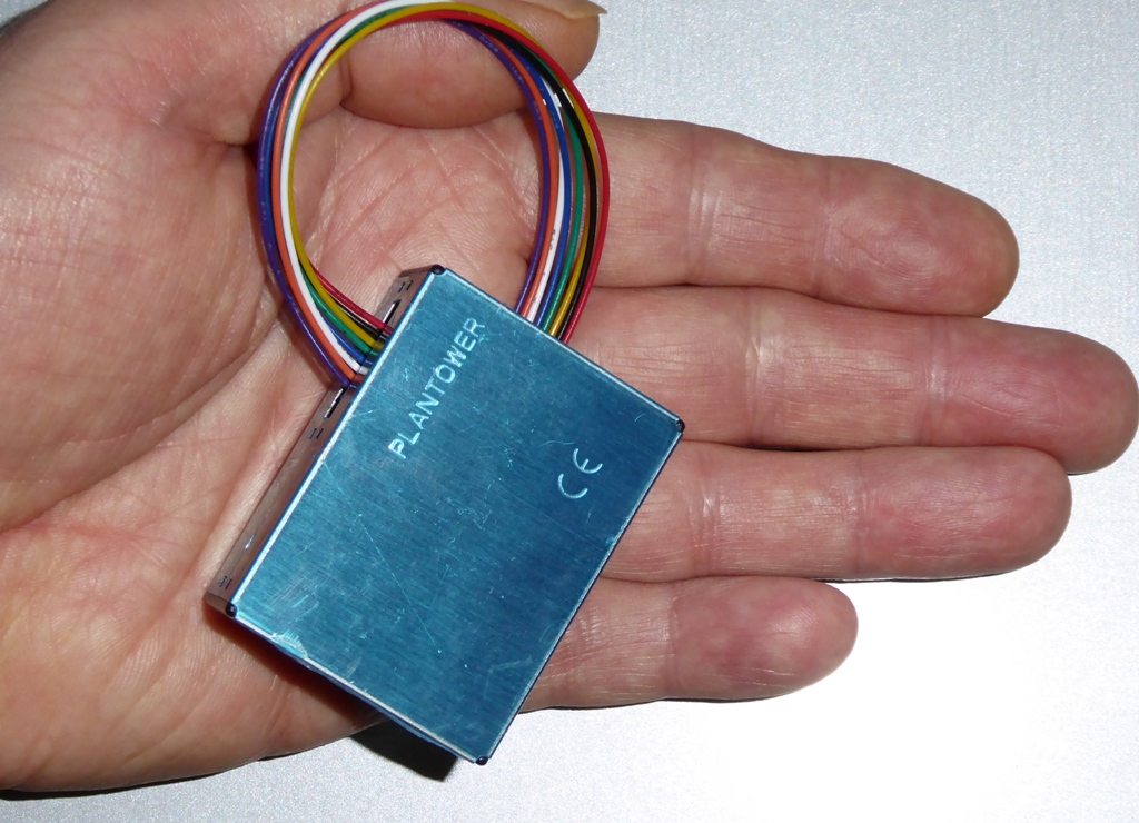

SteamyTea Posted February 4, 2018 Posted February 4, 2018 I got some new BMP280s and they work fine, seems the GY ones must have been a faulty batch. Also got a couple of PMS3003 monitors, but not had a chance to play with them yet.

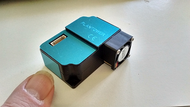

Jeremy Harris Posted February 4, 2018 Author Posted February 4, 2018 I was surprised how small the Plantower particulate monitor is. Looks easy enough to interface too, though, just a matter of reading serial data. I went for the PMS5003, not sure whether it's significantly better/worse than the PMS3003, I just went on a review comparing the three main models that Plantower produce.
SteamyTea Posted February 4, 2018 Posted February 4, 2018 I went for the cheapest. And yes, they are tiny. But that is a good thing.
Jeremy Harris Posted February 4, 2018 Author Posted February 4, 2018 The fan seems to be inside the case on the PMS5003:
