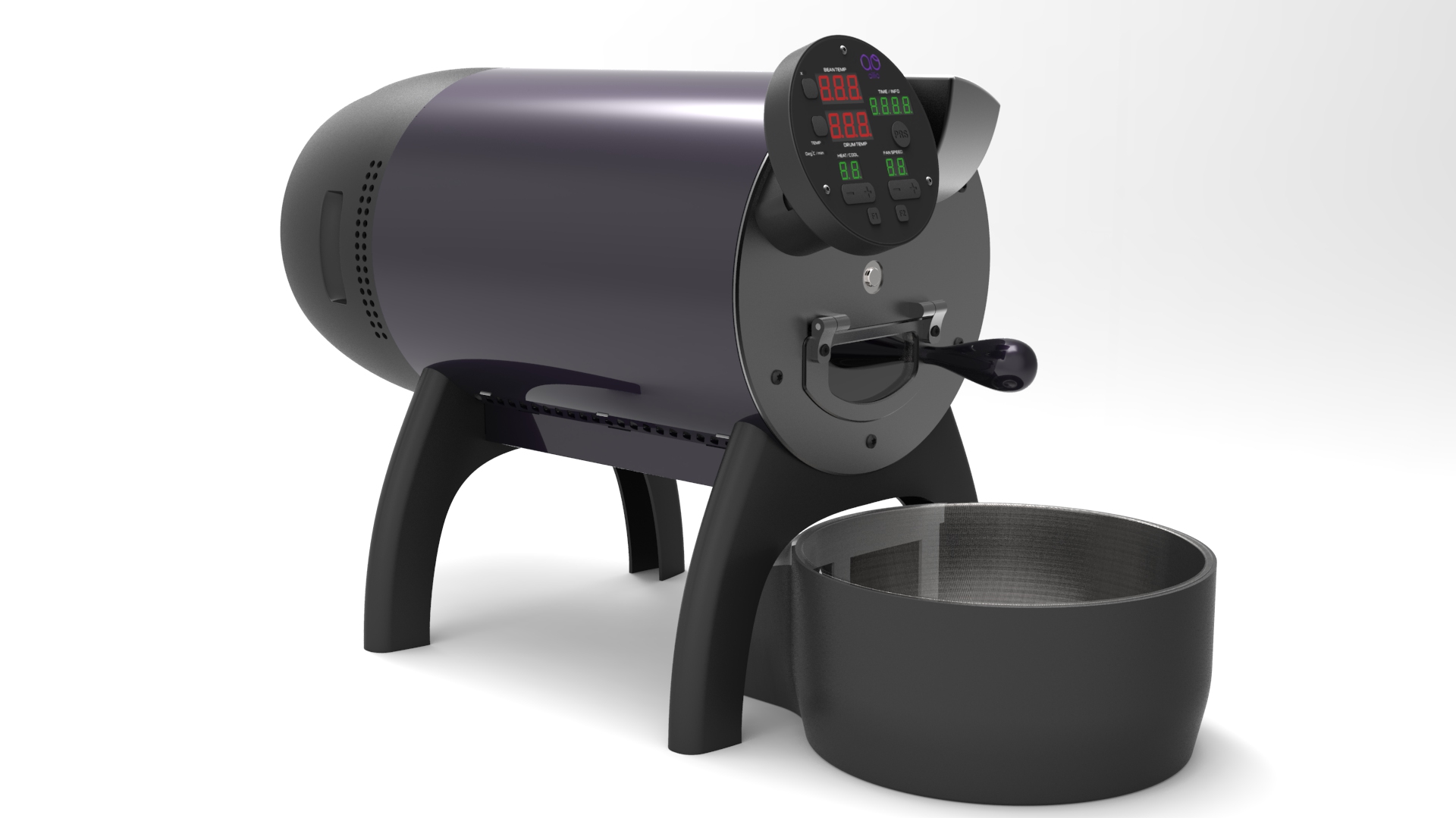

1 hour ago, billt said:
....peaks when starting are usually less than the particulates I get when roasting coffee....
C’mon, let’s see this coffee roaster ..!
BuildHub coffee anyone ...???
