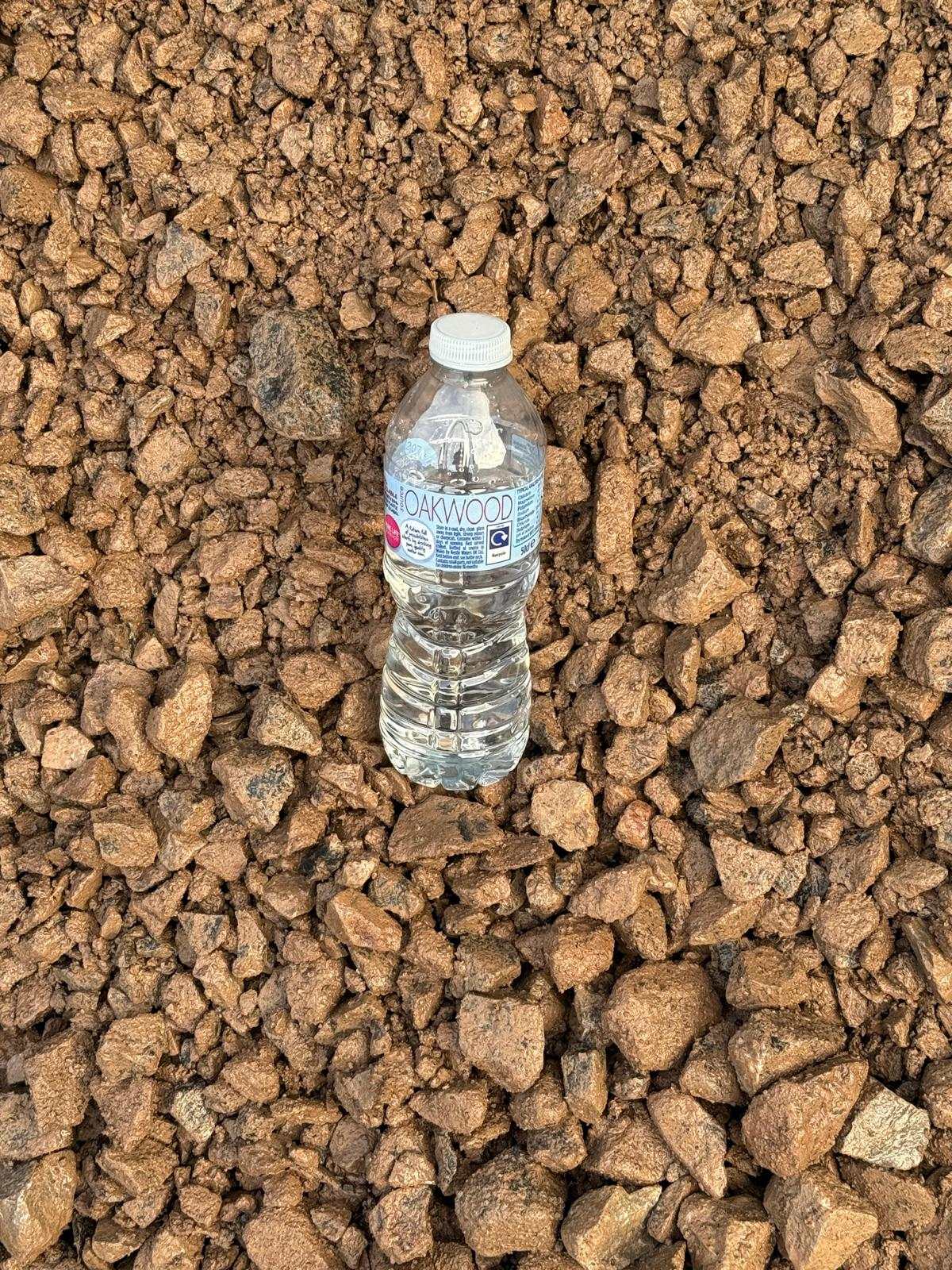

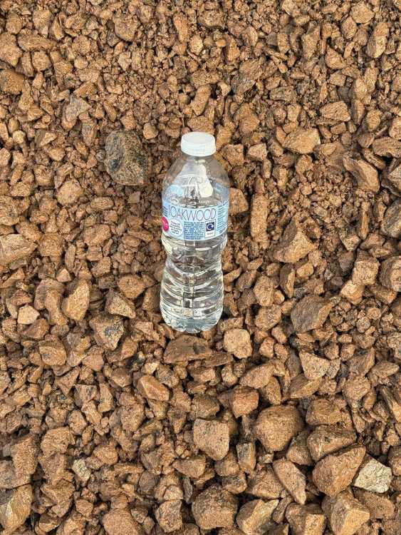

bmj1 Posted October 21, 2025 Author Posted October 21, 2025 I've had this photo through from the supplier of the replacement aggregate. What do you guys think ? Does it look ok ?
Redbeard Posted October 21, 2025 Posted October 21, 2025 My contractor used mainly 40+mm limestone, with no fines. I don't think there were any stones under 30mm. but what you show looks fine, and fines-free. Really as long as it lacks fines which could emulate cement you are probably OK. 1

bmj1 Posted October 22, 2025 Author Posted October 22, 2025 Pleased to share that they took away the old material and delivered a clean batch of aggregate with far fewer fines. Just shows the care needed to deliver a suds compliant end result ! 1

Kelvin Posted October 22, 2025 Posted October 22, 2025 19 hours ago, bmj1 said: I've had this photo through from the supplier of the replacement aggregate. What do you guys think ? Does it look ok ? Looks like the stuff I put down on my driveway. Drains well. Right at the start of our build the wrong type of MOT was delivered and put down when I was away (loads of really large stones) Was too much like hard work to take back up so I left it. It was mostly around the back of our house where the patio was going. Fast forward to now and we are putting the patio down but had to dig all of this stuff out as no use for a base. Fortunately I managed to get a local to take it.
