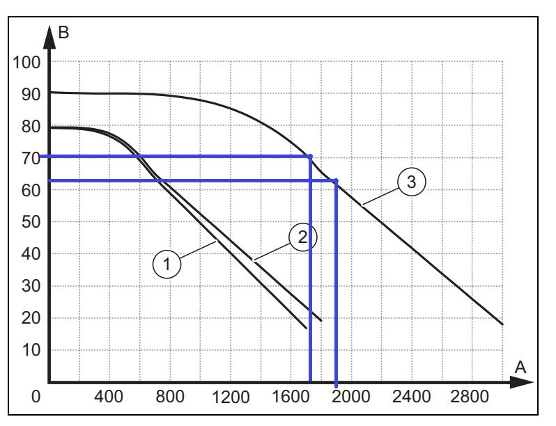

jamesdiyer Posted November 3, 2025 Author Posted November 3, 2025 (edited) Well. Vaillant have been, they said the flow rate is a bit low at 1750 not 2095. But more that not hitting 995l/h at 50% pump effort, it's doing 960l/h. Their suggestion was to run a buffer tank like planned, and questioned why I'd be running a volumizer at all. And said I need to arrive at 2095l/h the norminal to get guarantee active.. Seems very much like, computer says X. Stuck between a bit of a rock now. Don't really want buffer tank, but need to hit 2095 and also high flow at 50% - apparently. Edited November 3, 2025 by jamesdiyer
jamesdiyer Posted November 3, 2025 Author Posted November 3, 2025 Need to speak to installer. I don't see how I won't end up with a buffer really. As he wil say that's how he wanted to install it and it's going to change the pipe to 32 internal (from 28 now)

jamesdiyer Posted November 3, 2025 Author Posted November 3, 2025 (edited) How would I know if the heatpump is complaining? At the moment I don't believe it will matter, we have a heatloss around 9.5kW at -7C. So the machine is big and doesn't need more than what we have flow rate to happily provide that at delta t 5. The machine is big as I'll add a other 100m2 to the system in a year or two - at which point it will need more flow but I'll have to put a pump on that system as it'll be UFH so will change all He was talking about minimum flow at 50% of pump and the machine not starting or something, but it made sense. It's a situation that seems if flow rate is not raised guarantee isn't approved or so. Edited November 3, 2025 by jamesdiyer

jamesdiyer Posted November 3, 2025 Author Posted November 3, 2025 Thanks both, that sounds a good suggestion and saves changing the primary which I feel would be difficult to achieve without baring the cost. It's a shame it's not wider. I'll see if the installer will just do this, the vaillant man loves a buffer than (and running on expanded mode) but doesn't seem to mind how I run it, as long as it hits the flow needed.

jamesdiyer Posted November 3, 2025 Author Posted November 3, 2025 (edited) Apparently running a secondary pump inline is not allowed, said something about cavitate. His recommendation is change tubing to 32mm internal, from the 26mm internal now (22m total). And then buffer if needed. Edited November 3, 2025 by jamesdiyer
jamesdiyer Posted November 3, 2025 Author Posted November 3, 2025 9 minutes ago, JamesPa said: It will stop altogether if it detects flow rate too low. Mine did when the filter bunged up. BTW I suspect the mesh filter, normally fitted near the return inlet, has a fairly high pressure loss even when not bunged up. If yours is like mine a model with a larger area may well assist! I did try running without filter mesh and made no difference to flow rate.
JohnMo Posted November 3, 2025 Posted November 3, 2025 11 minutes ago, jamesdiyer said: I did try running without filter mesh and made no difference to flow rate. Looks like your head losses are pipe related maybe all the elbows used etc. I would put a Wilo 7m head pump in, then you get the ability to dial in the correct settings to get the flow you need and have some flexibility.

jamesdiyer Posted November 3, 2025 Author Posted November 3, 2025 (edited) I've sent them the vaillant report and await their response. I want the installer to increase pipe size first (and remove as many connections as possible) and see if we hit flow. If not then we can add buffer and pumps. I think the installer will just want to install the volumizer as a buffer and be done. Which imo is just masking a bad install. I don't know why the vaillant guy loved a buffer and expanded mode so much. Edited November 3, 2025 by jamesdiyer
jamesdiyer Posted November 3, 2025 Author Posted November 3, 2025 This is what the vaillant report said: >Direct aerothermal installation with 2 radiator circuits and a 200-liter return tank. The minimum flow rate for heating, with the pump at 50%, is 9641 l/h, and at maximum, 17171 l/h, and for domestic hot water, 1615 l/h. These are low flow rates because the piping is 32 mm multilayer and everything is supplied by the unit's own pump. It is recommended that you use 1.25 inch piping, the return volumetric tank as a buffer tank with a sludge separator on the return line, and separate pumping units for each circuit because you may have flow rate problems that would not be covered by the appliance's warranty. You have purchased components from Germany, and a different part number is listed. You will speak with the installer to modify the installation and improve flow rates.
JohnMo Posted November 3, 2025 Posted November 3, 2025 15 minutes ago, jamesdiyer said: 32 mm multilayer ... It is recommended that you use 1.25 inch piping 32mm and 1.25" are the same nominal size, so I assume the writer is actually saying install 32mm copper pipe instead of the multilayer? Thought you were in Europe, so no idea why they refer to imperial sizes, which aren't specified in the UK any more (not for the last few decades anyway) let alone in Europe. Generally sounds a bit of numpty. 52 minutes ago, jamesdiyer said: expanded mode Quick search "Expanded mode" on a Vaillant heat pump system is a setting that combines weather compensation, room temperature influence, and traditional thermostat on/off switching. It will aggressively heat to meet a target temperature and then switch the heating system completely off once the target is reached, turning it back on when the temperature drops below a certain threshold. So run it like a boiler - not great for running costs and he's one of the experts? 1
jamesdiyer Posted November 3, 2025 Author Posted November 3, 2025 Yes 32mm internal. And again, it's a situation of computer says. He doesn't run a heatpump at home so it's only from what the computer (vaillant training) has told. The installer has said he's happy to change the pipe, though there will be a small cost to me - which seems fair. The issue with 40mm plastic is it's 4m long bars which will need connectors that reduce flow. The alternative is 35mm copper which has full bore connectors. And hope this change is enough to bring the flow rate up and avoid fitting a buffer. My calculations make me feel it will be.
