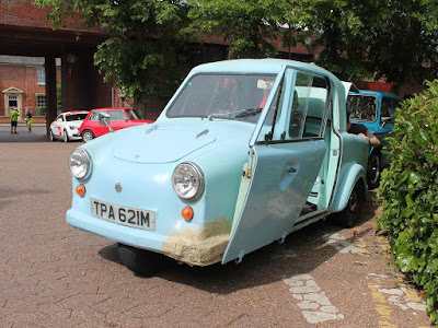

October 6, 20251 yr 30 minutes ago, Nickfromwales said: The Tesla of the 80’s lol. Set BEVs back 25 years. Some the the guys at work really bought into the concept. Most of us just thought it was a replacement for this.
October 7, 20251 yr 16 hours ago, SteamyTea said: Most of us just thought it was a replacement for this. "On 31 March 2003, they were banned from use on roads in the United Kingdom because of safety concerns. They were all called in and crushed, though a few survive in museums and private ownership."
October 7, 20251 yr 2 hours ago, Gone West said: On 31 March 2003 Tony Blackburn, the DJ, sister had one. She loved it, used to see her tootle into Poole most mornings.
